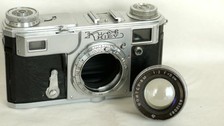

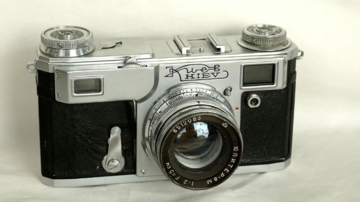

Hi,
I have no knowledge of Kiev cameras so I need your help.
This camera is offered to me as a Kiev model 2 or 2A (II or IIA).
It comes with a 2/5cm Jupiter-8M lens.
Here are some images from the seller:
Kiev-4A-front.jpg Kiev-4A-front-lens.jpg Kiev-4A-bottom.jpg Kiev-4A-open.jpg Kiev-4A-top.jpg

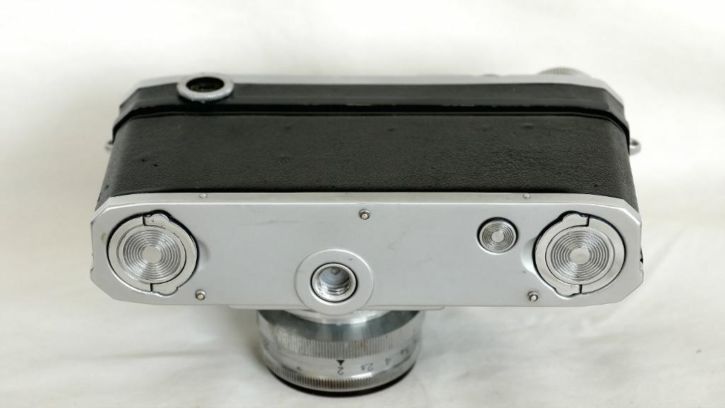

But looking at these sites I think it is a model 4A, because it hasn't two "stabilizing feet" beneath the bottom plate?
http://camerapedia.wikia.com/wiki/Kiev_rangefinder

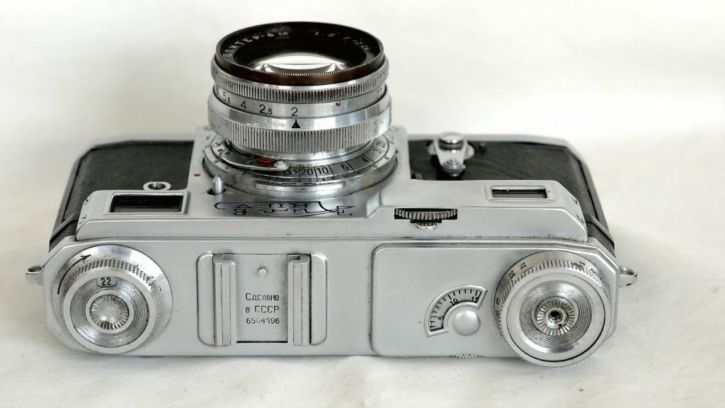

Its serial number is #6504396. Is it correct that the first two digits are the production year, making this a 1964 model?
I believe the model 4A was made between 1959-1980. The model IIA seems to be made between 1955 - 1959.
Asking price is Euro 99 (about USD 130). Is this a fair price if the camera is in good working order?
I don't really mind if it is a 2A or a 4A. They look almost the same and I only want it to shoot film with nice older rangefinder cameras.
And I like this model, also being a copy of a Contax. A real Contax is a bit more expensive so I'm willing to settle for a Kiev.
The seller said he didn't want to lower his price because it is an early model 2 or 2A. I don't think he is lying or cheating, but maybe just mistaken about the model. If I can show him it's a model 4A, maybe he will lower his asking price. I'm driving over tomorrow, so I will see.
An other question: is this a good & reliable camera to shoot with? I don't expect Leica quality but don't know what russian copy models are worth the effort or not.
Thank you for your help!!

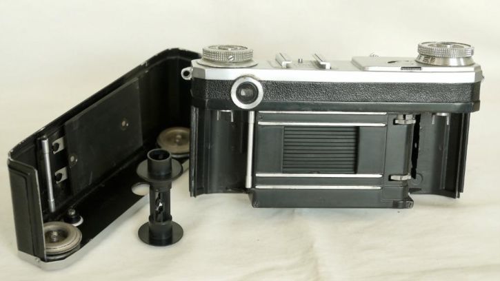

As for whether or not they are reliable, I would say (based on a lot of experience with small mechanisms of all sorts, and a fair amount of research into these FSU thingies) "Yes, they can be" with a bunch of caveats. Let's assume it was a good camera when it left the factory in Kiev in 1965. It is now almost 49 years old, you don't know how much - or how - it's been used, when or if it's ever seen servicing. I would expect to have to give the camera a complete overhaul, removing all old lubricants and replacing them with modern synthetic lubricants, not a job for the faint of heart - or the inexperienced. I've already done the same on a Contax II and it's involved to say the least. Expect to replace the shutter tapes as well. The lens may need internal cleaning, I recently bought a screwmount J-8 from 1975 and it had the stubbornest haze I've ever seen.
Any old camera you get will need servicing, it's standard maintenance for mechanical things. I usually buy things with this in mind, and I've yet to be dissappointed. The really really really clean Canon SIIb I bought needs a complete overhaul including new leather cover and new curtains (I knew this before I bought it), but I wouldn't have been able to afford it otherwise.

You can find better deals on the 4A on the auction site, i have seen many really nice ones in the 70$ range with clean optics.
The Kiev is i decent camera if in good condition, with the range finder 'Windows' so far apart it it said that focus is more accurate than most RF's.

The 65xxxx indicates the year, the lens serial should be the same or one out eg 64xxxx.

I have a collection of them and after I refurb one it is reliable. They will snap a ribbon with a lotta use and frame spacing is not wonderful, the Contax II is the same and also needs a refurb.
They are easy to strip but people sometimes send me one (or two) in a zip lock bag of bits. Spares are plentiful as there is a cottage industry converting their mount to a Nikon to Leica adapter.

Its a 4A and €99 is expensive unless it comes with a recent CLA and guarantee, otherwise look for €30-€40 max.

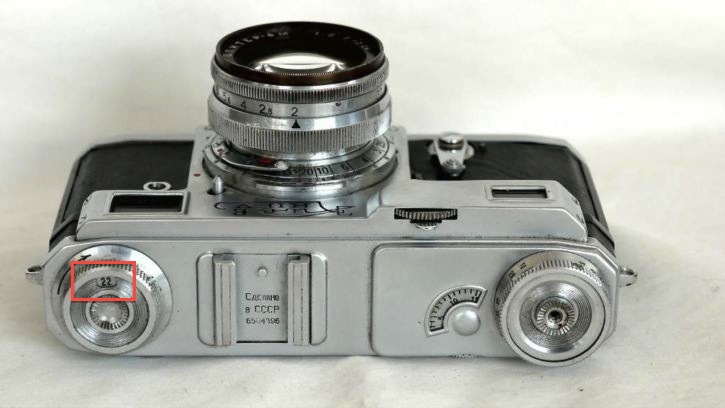

Princelle agrees that it is a 4A on account of the speed reminder window in the rewind knob. Hope that helps!

I went over today. I showed him the differences and he agreed it being a a model 4A (type 2).
The camera body was in good condition, only one corner of the leatherette was a bid loose. There was a small dent in filter thread of the lens but nothing serious. He came down to 40 Euro ($52).
I would have bought it but I didn't trust the shutter. It worked fine on the fast speeds, but I couldn't get if to fire slower than 1/25 s. I did wind before setting the shutter speed. Maybe we did something wrong, maybe it was malfunctioning. The rangefinder worked, but was a bit yellow.
