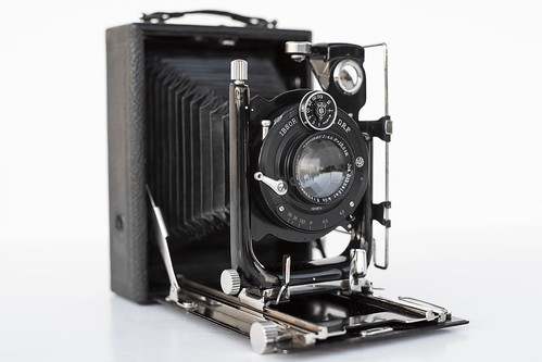

Hello!

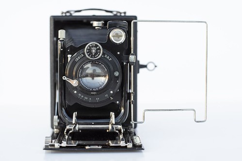

I received an unexpected gif last week :smile: A beautifull unnamed 9x12 glass plate camera.
The only reference I can recognize are the manufacturers of the shutter: AGC; and the lens, a Scheneider Radionar 135/4.5 of 1928.
I'd like to use the focus scale as much as possible but I'm sure that it needs to be adjusted. I mean, it seems to have been unmounted and mounted again because the infinity doesn't aims at the camera. So I've tried to adjust it to mount it again correctly but there is something I'm not sure about. I'm trying to find focus using the ground glass that, by the way, it's not cristal clear at all!!!. The question is that I need to extend too much the bellows to find focus at infinity wich is something strange if I compare it with my Pacemaker and its Optar 135/27. And if I use that infinity focus point as a reference, if I try to focus an object at 1 meter the reference in the scale is completly wrong at that distance. The same for 2 meters ... So, the focus scale is not realiable at all.
What do you think?

It doesn't look like there are any infinity stops on the rails...???
I guess (only a guess) you could...
1. use the focus knob to fully retract the focusing rail...
and then set the rail position so that the scal says infinity and lock the rail in position
2. loosen the clamp that holds the front upright to the focus rail.
3. without moving the rail, slide the front upright to focus on something far, far away (infinity?)
4. now clamp the front upright to the focus rail and focus on somethign one meter away as a check

For infinity focus use a ruler to measure and move the lens out to about 135mm from the image plane. That will get you close.

Those are the steps I followed ... once I check that extending 135mm the bellows didn't give focus.

Perhaps, the scale is for some other focal length?

I'm sitting here with one of these right now -- did you pull the lens/shutter standard all the way out, until it locks into place? There's a small knob on the left rail (as you look down from the top of the camera with the camera facing away from you) that the bed has to slip over and engage. That is the infinity stop that folks here are talking about.
when I do that my camera is very close to infinity -- i have to focus it out another 1/4 inch or so, not sure why but the thing is 100 years old and may be cranky.

My ICA 9x12 is similar to summicron1's in that you just need to pull the standard out until it stops. I've not explored to see if the stops are adjustable (presumably they are).
As to the OP's problem, if the bellows is out to near the lens's focal length, and there is no focus to be found, then the lens may have been disassembled and put together wrong or otherwise compromised.

I agree, if the lens to screen distance is set close to the focal length and you cannot get a sharp image on the gg at +/- 1 centimeter from there, then very likely something is wrong with the lens. It could be spacing between front and rear cells or a missing element or It could have been disassebmled and re-assembled with the elements in the wrong order or orientation, although this is difficult to imagine with a simple lens like the Radionar (a triplet design, IIRC).

No, I mean, the focal length seems to be the same (the scale shows 135mm).

I'm afraid that there isn't infinity stop in this camera. My Pacemaker has that lock that I set to be able to use the rangefinder ... but this little beauti hasn't!
