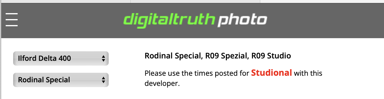

I am not a Rodinal user, so no help, but @reysphotofilm says he has "Rodinal Spezial R09 1+30" which is apparently different from the more common Rodinal 09.
When I search Digital Truth for "Rodinal Spezial R09" it tells me:

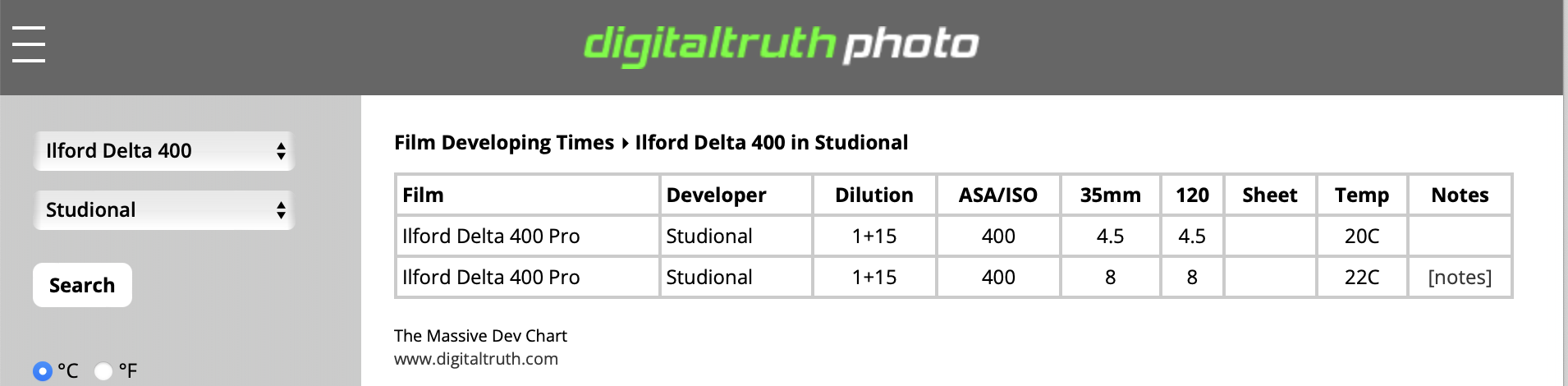

And searching for "Ilford Delta 400" plus "Studional" shows only times for 1+15:
The 4.5 minute time matches the time provided by Agfa according to the opening post. (the Notes say the 8 minute time is suspicious)
Perhaps the best solution for @reysphotofilm would be to forget about the 1+30 dilution and apply the 30% increase suggested by @Paul Howell to the time given by Digital Truth (and Agfa) for Studional diluted 1+15?
4.5 minutes = [(4x60) + 30] = 270 seconds x 1.30 = 351 seconds = 5 minutes 51 seconds -- is that right?
