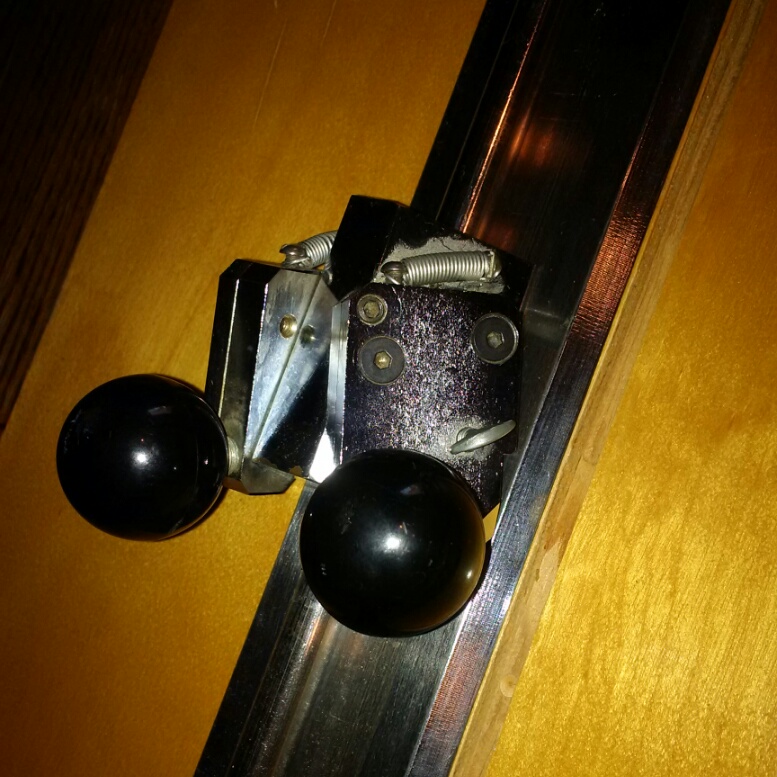

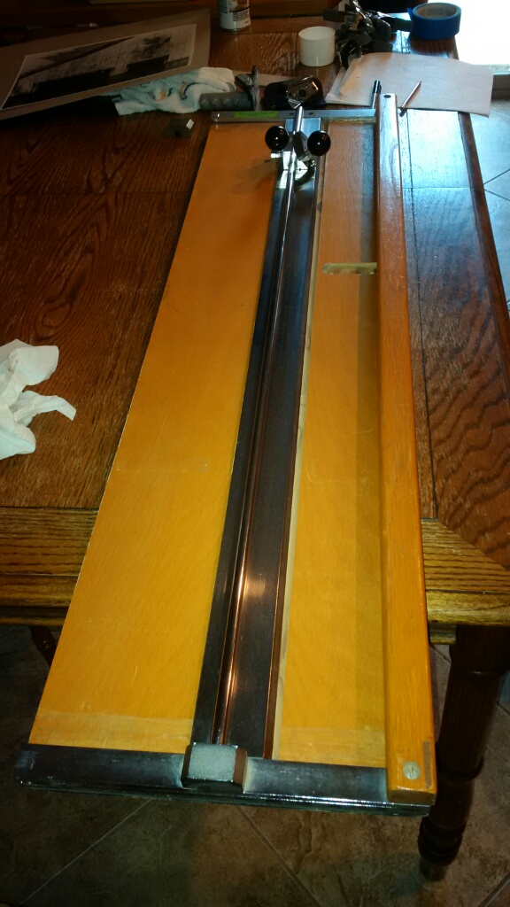

I was given this mat cutter a while back and it looks like a pretty nice one. But I can't figure out who the manufacturer is, and I don't know what sort of blades to get for it. Does anyone recognize this? The shuttle is two-sided, with a bevel cut on one side and a straight cut on the other.

I'm not sure who the manufacturer is (looks a bit like an old C&H to me), but you may want to take a few more photos, and ask these people. They should be able to help you find the proper blades:
http://www.unitedmfrscatalog.com/home/index.htm
Did it come with the production stops and squaring arm? If not, they may help you find those, too.

This is a Keeton mat cutter. In mine, I use C&H no. 900SE blades but your model is maybe older, I don't have the round black handles on mine but stainless handles.
Do you look if you have blades already mounted into the head?

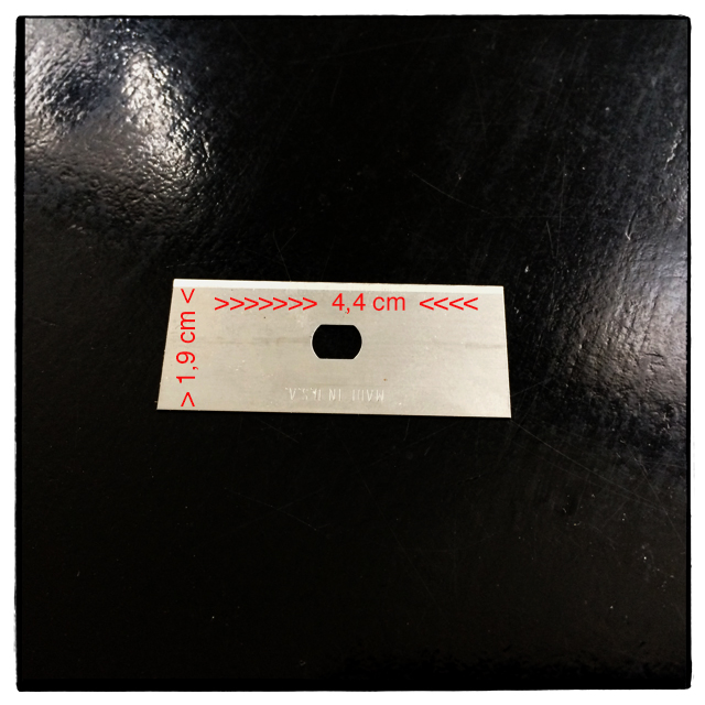

Ok, I looked at the mat cutters I have.
They are not exactly the same, but I believe they were both made by Keeton Products. Their differences are minimal and one looks like yours. On one there's a label and Keeton is mentioned, along with Jobber.
Attached you find images that should help you further.
