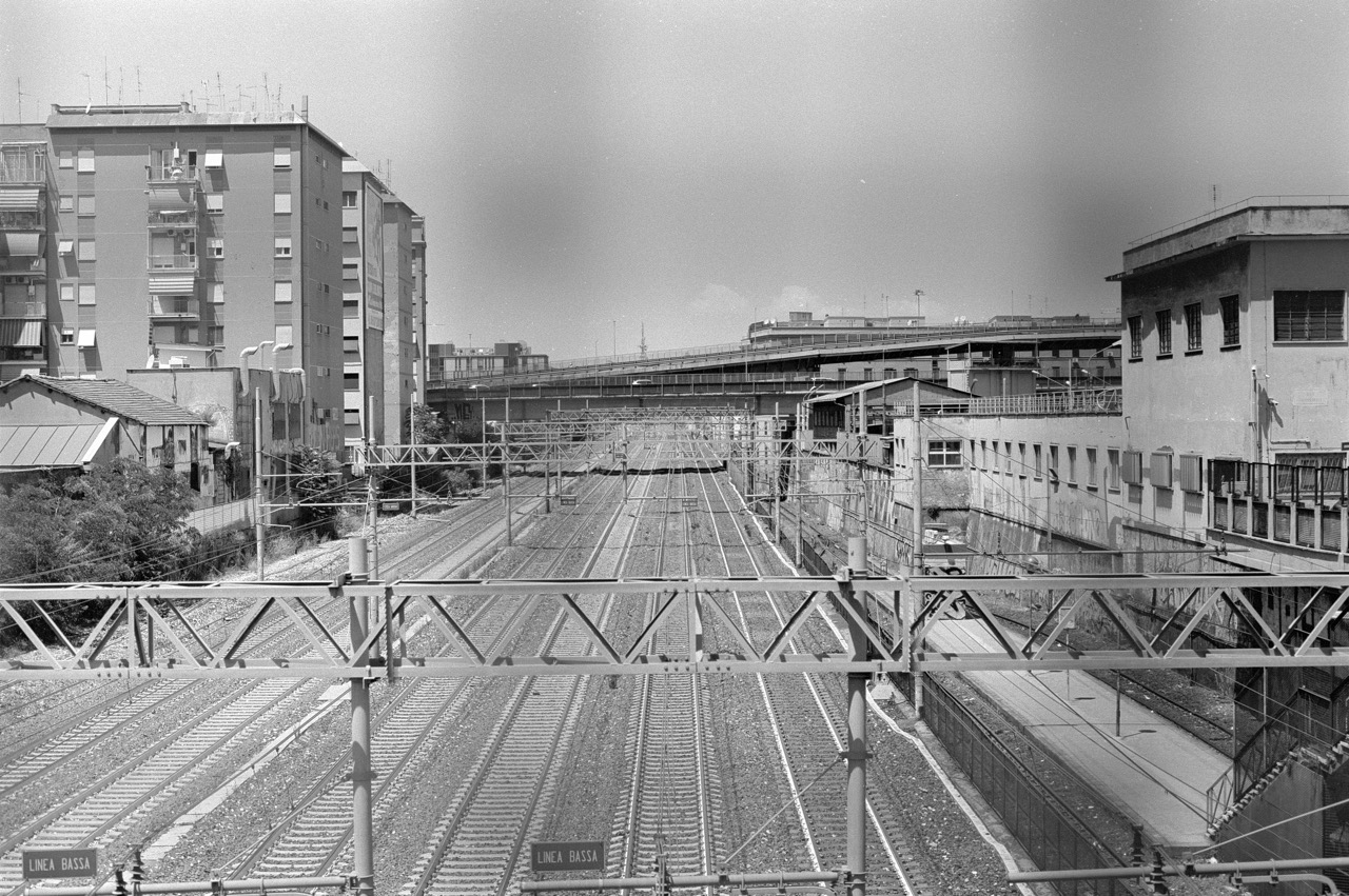

Home developed Fuji acros, rodinal 1+50 shoot with Canon F1.

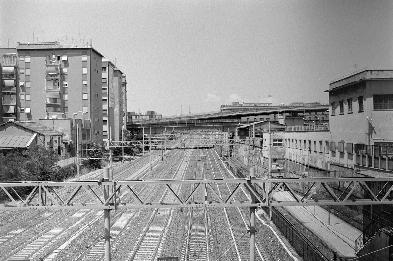

Need help identifying the nature of these streaks. Some of them almost look like shutter capping to me (or light leaks), and some others like development issues. I recently acquired the camera and I’m taking it on vacation soon, so I’d like to know if there is any issue with it that I should know of. Out of 36 exposures just 4 or 5 seem to be affected.
Any suggestions?

#3 looks like a dev problem.
#2 looks like a shutter problem.
#1 looks like it could be a light leak or a development problem. (Maybe uneven shutter travel?) (I don't see a light leak there, actually)
Definitely check the shutter, if you can. It might just be doing that at a certain speed - but it's still a problem.

Do you see any evidence of washout along the rebate area? My understanding is the light leaks tend to wash across the entire film plane is (nearly) predictable patterns.
Have you changed your agitation pattern? I ask because sometimes over-agitation can produce some of these effects?
That only five or six frames seem impacted suggests a shutter problem (as you’d suggested). The good news is that others on the forum will likely provide good guidance … I hope that you have the time to CLA this camera before any critical work! That will, at least, rule out the more problematic possibilities.

Yeah, I'm leaning toward shutter problems too. Unfortunately, I can't remember the camera setting when I shoot these (next time I'm gonna write them down).
It was my understanding that shutter capping results in dark lines at the beginning and/or the end of the frame because the curtains fail to separate, so I don't understand how it can happen multiple times at random spots within the frame. So I can see how #2 could show the sign of shutter capping, but I can't explain the streaks on #1. Has it happened to you before?

In the first image, what's odd is that there appears to be both a horizontal and a vertical density variation:

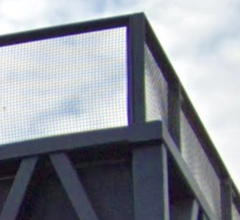

On the second example, it's a little less clear what's going on:
I'm not sure whether the lower density (in the negative) band on the right hand side is curved or has a straight (but slanted) edge.

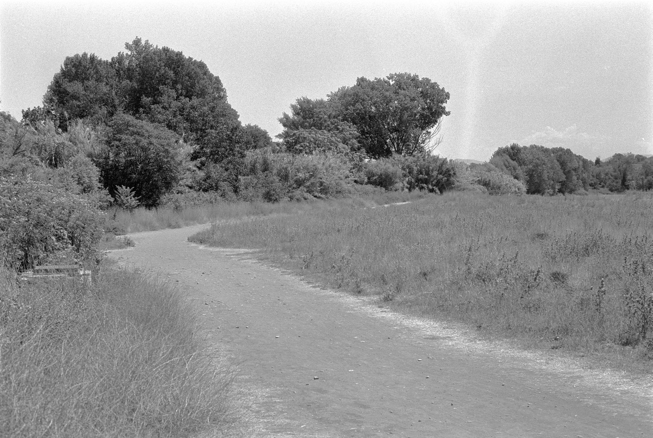

#3 has development streaking, most likely due to insufficient agitation issues at an early stage of development.
I can see how a shutter capping issue could explain #2. #1 is a tricky one; I'm not sure how that could be explained. Is something stuck to the shutter curtains; some kind of debris?

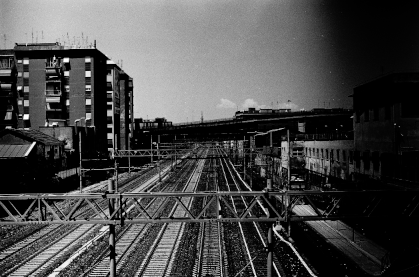

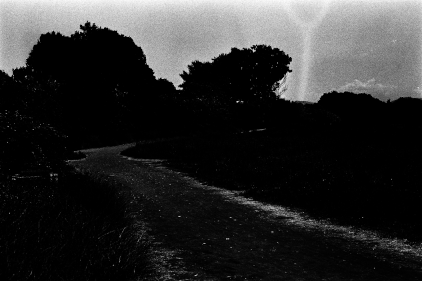

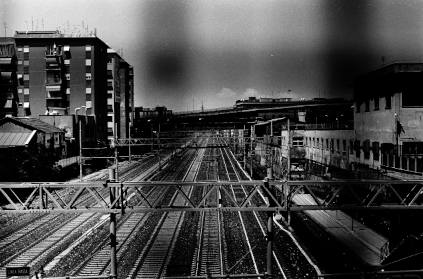

Thank you very much for taking the time to edit the photos and inspect them thoroughly!
Aside from #3, I agree that all the photos seem to suggest something was in front of the film. I inspected the camera, and the curtains appear in rather good condition, as it was rarely used by the previous owner, who was not a professional (pretty rare for F1 owners of the time).
I guess (as stupid as it might sound) something could have also been in front of the lens, maybe some kind of web I don't recall being there. I guess I'll have to further test fast shutter speeds!
Not stupid at all, and it would definitely explain what we're seeing here. Perhaps you attempted to photograph through some kind of fence. Usually, on railway flyovers in urban areas there's some kind of protection against people falling/climbing over railings etc. Like this:

I would say the first two images were definitely shot through wire mesh .
I would say possibly at two different apertures, as one is stronger than the other .
No idea what could cause the marking in the third image .

Yeah, probably there was some kind of fence I don't remember. This would explain the random dark marks, especially the horizontal ones.
I remember that for sure I was using a small aperture to achieve DOF, so that's very likely
