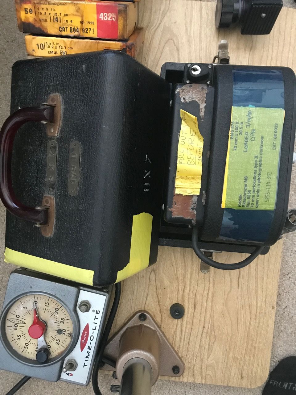

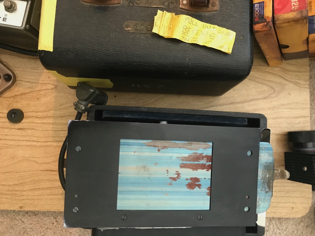

Greetings. Some relatives are liquidating part of an estate, and have asked for help in identifying a few parts. The item separated into a black upper case and a base is the part in question. Does this look familiar to anyone? The top section of the case has two small metal plates, one with "8 x 7" embosed, another with "179 D" embossed. The is also a stencil on the side of the top section: "8 x 7". I see what looks like it might be a ballast in one half of the bottom section - the attached plug has a 4-prongs, something like a ballast plug might have.
Thanks for any help.
cheers
Tom

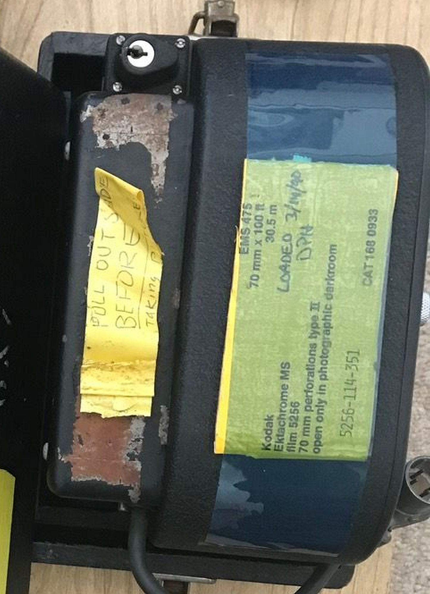

Looks like a motorized 70mm back possibly for a portrait camera system. Seems to be missing the camera system :whistling:.
mshchem
Nov 26, 2007
14,627
Iowa City, Iowa USA
Yeah, 100 foot rolls of 70 mm. Could be a back for commercial or aerial photography. Most likely a cool doorstop. It would be fun to see the other side of the item .
AnselMortensen
Jun 9, 2020
2,454
SFBayArea
Traditional
I second the above...
Motorized aerial camera, school portrait camera, or possibly a traffic/surveillance camera....(the keyed lock cylinder makes me think that).
Cool old stuff!
More pics, please! :smile:
AgX
Apr 5, 2007
29,973
Germany
The first film back I see that got a lock !!!
Thus for a stand-alone set-up.

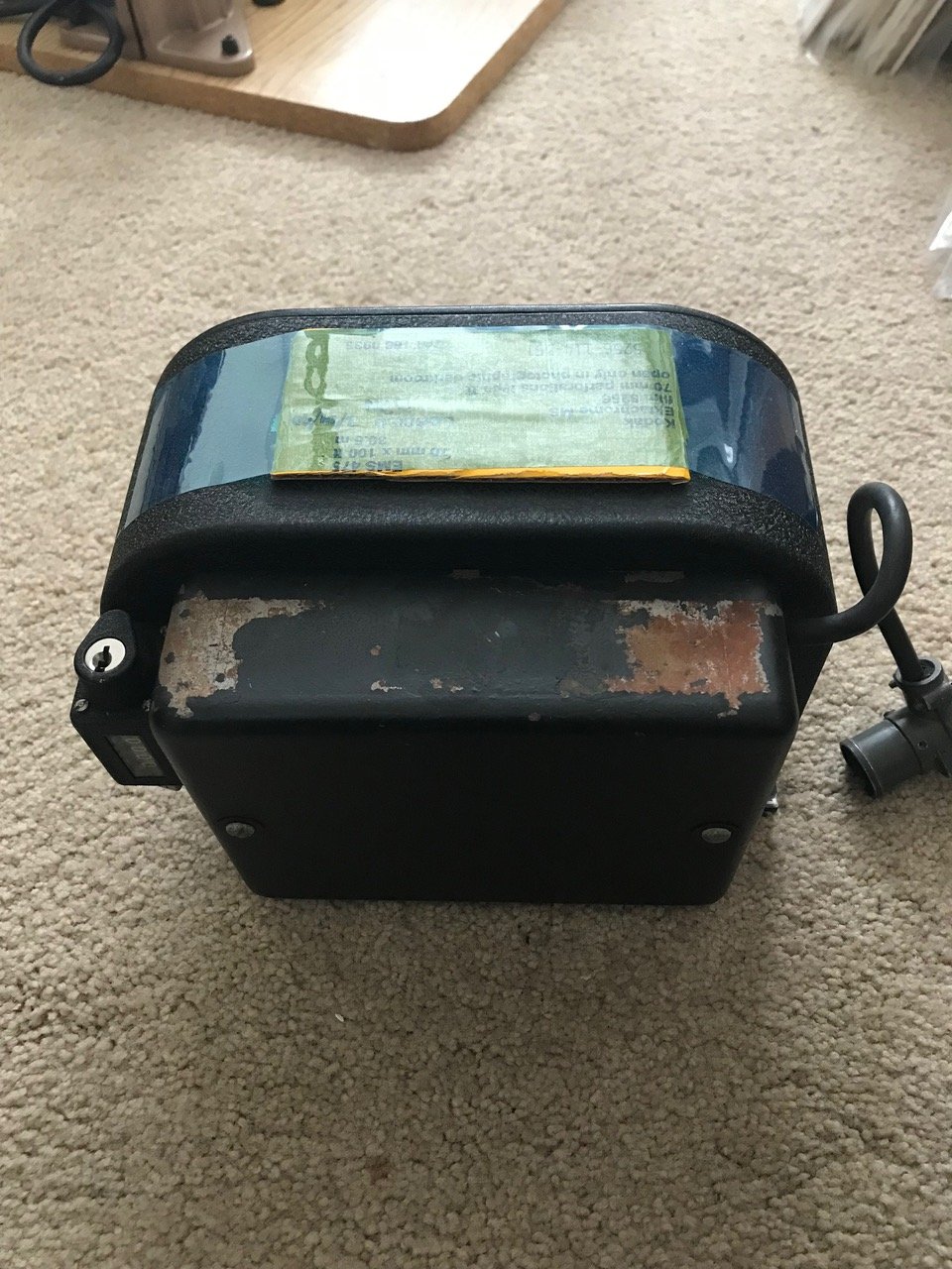

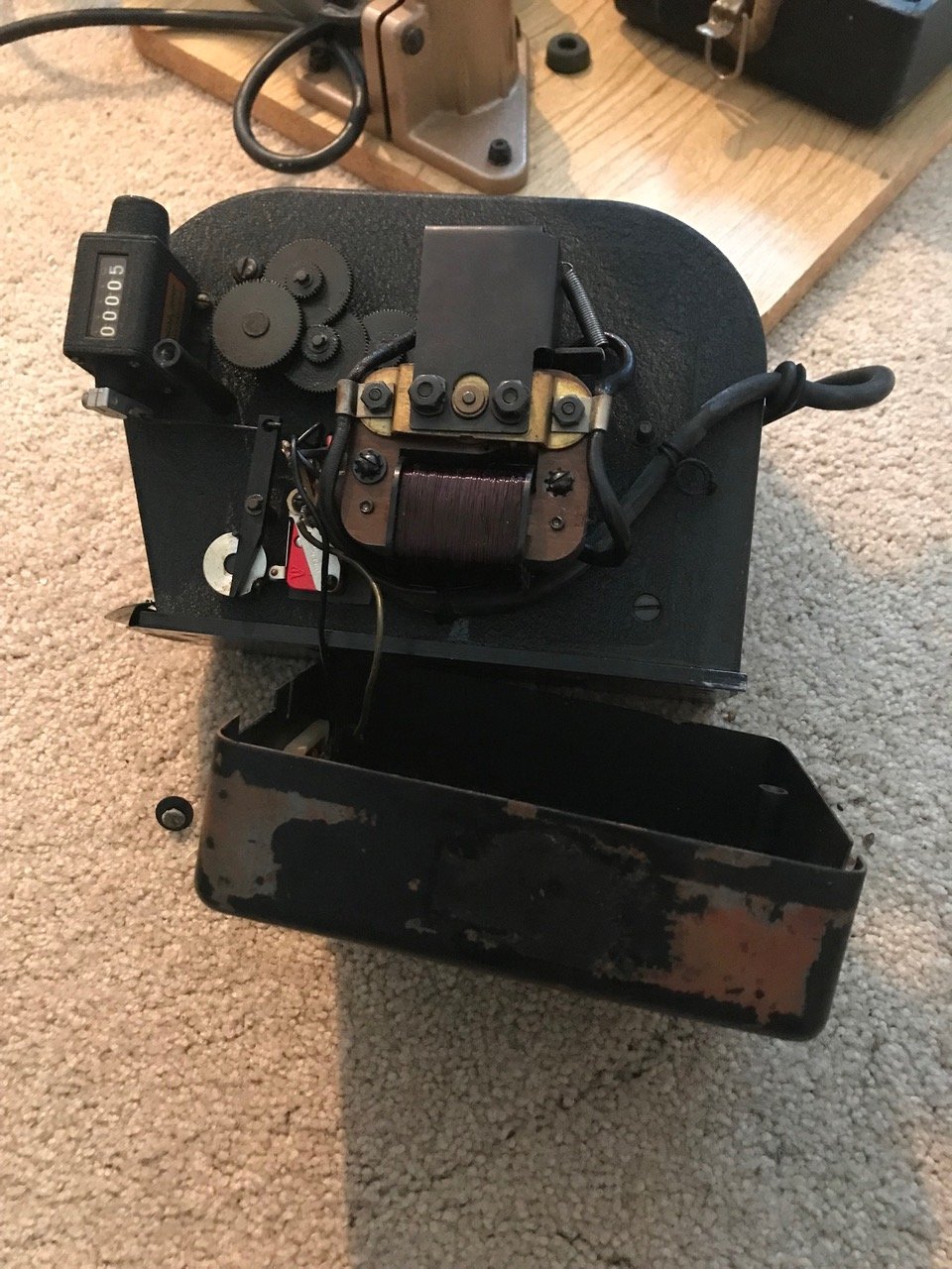

More photos:
From left to right: the underside of the bottom section; the innards of the bottom section removed from the box; cover removed on the counter side of the innards; label on the innards on the side opposite the gearing.

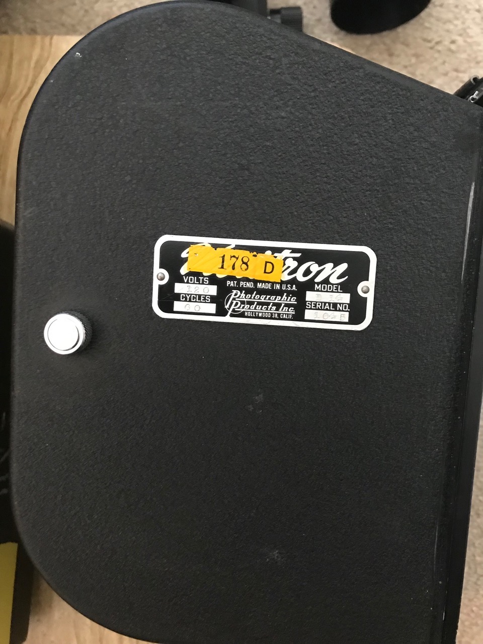

The labeling on the ID plate gives the following information:
Photographic Products Inc., Hollywood 38, Calif.
- made in USA
- model: D 14 (?)
- serial no.: 1045 (?)
AgX
Apr 5, 2007
29,973
Germany
Interesting !
So that lock does not lock that film back to anything (against theft), nor does it block its use.
It just resets that counter.
So "back to start" concerning the use of this film-back...
(By the way, that counter actuator is a intermediary in the release mechanism.)
