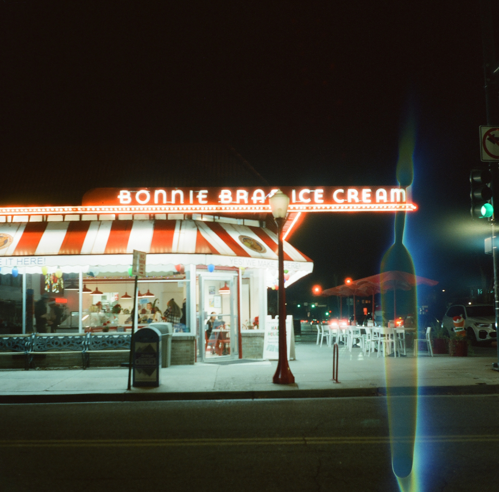

Recently got scans from the lab and 2 of them have blotches like this that almost look like burn marks. They're on the negatives and, in this case, the blotch extends a few mm outside the frame. The lab says it's not a processing error and suggest it's weird lens flare (at night, low light, extending outside the frame).
Any ideas?

It looks like film touching itself preventing absorption of the chemicals. There is 0% chance that's a lens flare. If who you're dealing with is a lower level lab technician, they might just be ignorant. Otherwise, they're lying. In either case, find a new lab or start home developing. It's easier than you think, easier than baking a cake.

Welcome aboard @skreginal ! Sorry to see your film was damaged at some point.
That's a possibility.
Another possibility is slight moisture on the film itself when it was spooled, which consequently dried. This could also create similar anomalies.
What kind of film is this and in what format? The frame dimensions look like 120 roll film.
A lab error is the most likely cause; moisture on the film itself would be a (remote) possibility if this is e.g. cine film that was respooled by a minor player with poor working practices/QA, or DIY/home-spooled film.
You are correct about the 120. Cinestill 800T. I actually was doing some reading about it specifically and I think there's evidence on one of the other frames of static discharge (there's a weird tree-looking thing), which makes sense considering it was shot in the cold in Colorado! But I don't think the static would account for the other blotches...

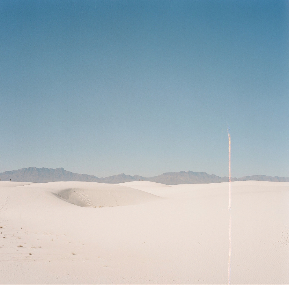

There was also a mark on a single frame of Ektar shot on the same camera in New Mexico in November (cropped to preserve resolution below). It's a lot fainter and initially I thought it was some kind of light leak but if you zoom in there's a faint outline on the left that makes it look more like a drop of smeared liquid. I'm thinking it could be the same problem.
Also interesting is that all the marks are both in a similar location at the right of the frame. But I don't think they're consistent enough to suggest something off with the camera itself (Yashica 124).
My first impression would be that the film (emulsion side) impacted with an edge of some sort in that spot. This edge could well be the edge of another strip of film. My expectation is that this would have happened at some stage during processing or at least when the film was wet, although that's not perfectly guaranteed.
I agree with that assessment. Also, the nature of the defect as such doesn't look like anything I associate with a camera-related factor.
Btw, all labs make mistakes. The good ones do so very, very rarely. The bad ones do it more often. But there's no such thing as 100% success rate.
