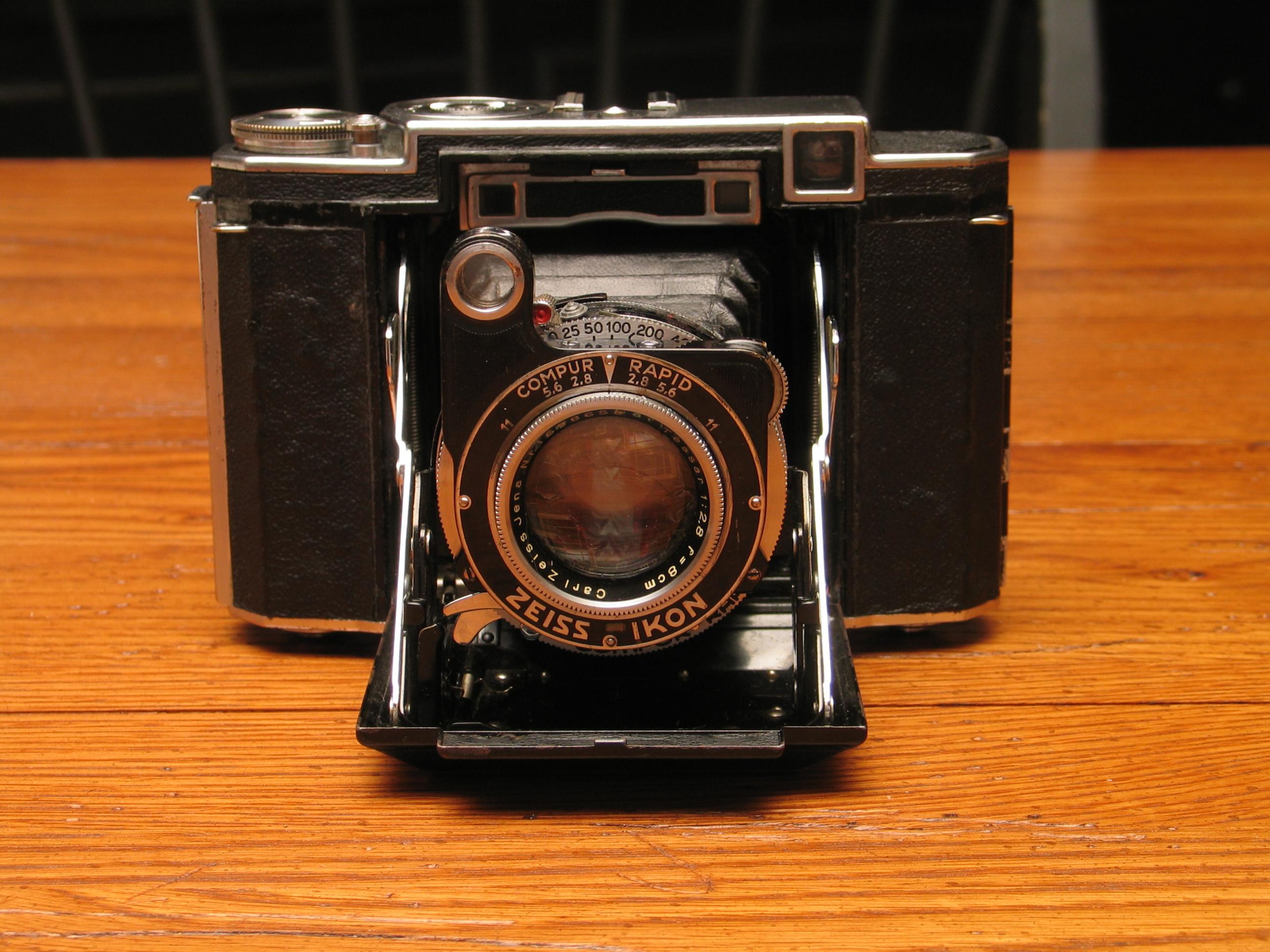

I bought this at a yard sale over the summer for about sixty dollars, if memory serves. I've tried finding some info on it, but I've only found Ikonta's and the like online. It has a fantastic f/2.8 Tessar that produces some fantastic images.
It seems to be called a Super Ikomat BII, and all the markings inside seem to indicate a 6x9 format, but it shoots 6x6 images. It even says 6x9, 2.25x3.25 on the inside.

That "6x9" thing on the inside is normal with Zeiss folders of this vintage; they marketed the *film* as 6x9 film.
I think the Super Ikomat name was used for some versions of the Super Ikonta 530; anyway it's some flavor of 6x6 Super Ikonta. You got a terrific price on it!

It looks a little rough, cosmetically, but it functions perfectly! Looks can be deceiving. The bellows are light tight, the RF is bright and accurate, the shutter is accurate at all speeds (by my rough test by ear, at least) and the aperture blades are all clean and clear. I really lucked out on this one!
There is a number imprinted on the side. What does it say?
See 3rd image above your thumb.
530/16. I completely missed that... Looks like everyone here was right.
Shouldn't a 6x6 have a centered frame number window?
Thats what I thought, too, but after putting a roll through it it doesn't seem to be an issue.

I have a very similar camera. Actually almost identical. Mine is marked Super-Six and 530/16. I was told mine was not meant for export to the USA. It only has meter markings on it. No feet markings. Shoots 6x6 and is also marked 6x9 inside. I also paid around $60 for it at a local consignment shop. I sent mine to Carol Flutot for a CLAC. I think she charged me $90 to get the shutter working. I inadvertently tried setting the self timer and jammed the shutter. I learned a valuable lesson. Never touch anything painted with a red dot on an old camera. Mine also looks rough, but works great after having is serviced.

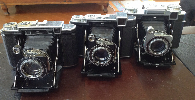

Below:
530/16, 532/16 and 533/16.
Notice that Zeiss Ikon enlarged the viewfinder for the 532/16.
I shot with the 532/16 a few weeks ago. I always have fun with this camera.
