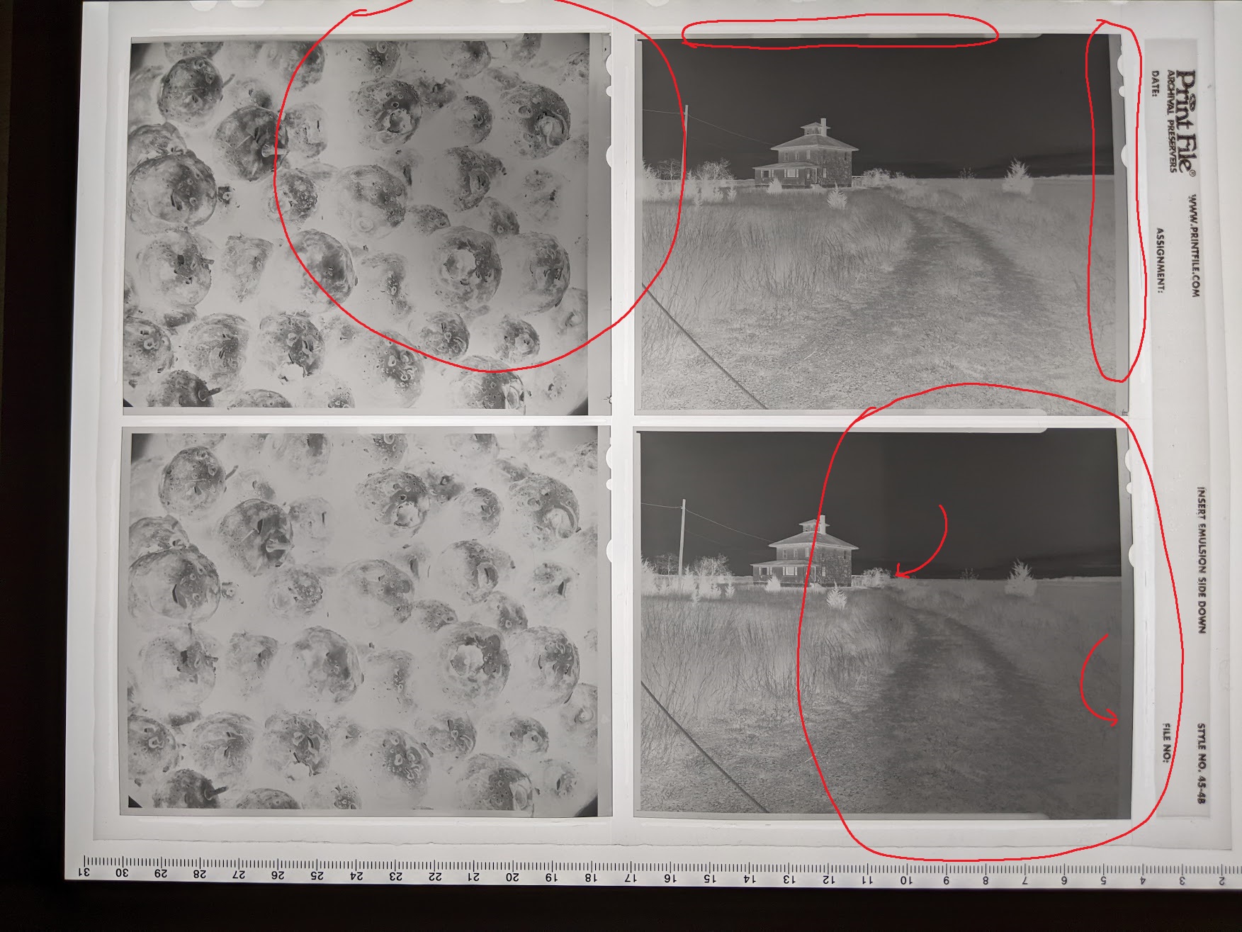

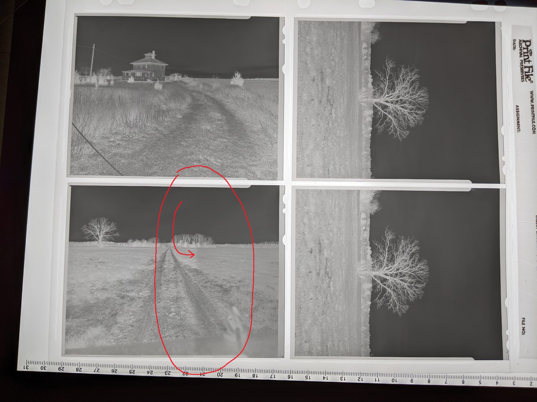

I decided to try out my new Chamonix 4x5 camera and get some practice with it today. After developing the negatives I noticed some issues. I've attached images of my negatives with the problem areas marked in red. I'm guessing there has been some sort of light leak since parts of my images are darker than the rest and the film registers look fogged.
-Each page of negatives was processed separately in a Stearman Press SP-445 film processing tank. I have used this tank a few times before without issue.
-Film was loaded completely in the dark into brand new Toyo film holders.
-I have checked the camera for light leaks with a flashlight in the dark.
I don't think there was a light leak when loading the film holder in and out of the camera and I have a hard time imagining that I could have fogged the paper in this way when loading and unloading the film. I suspect the film developing tank might be the issue, but then again it worked fine up until this point and I don't think that would cause some of these straight lines. Additionally, the same issue has manifested in two separate batches.
Anyone have any ideas?

Because the dark area's are on the film rebate as well, i think the film must have been exposed to a bit of light either while loading the film into the film cassettes or while loading the film into the developing tank. Another option is that the filmboxes you have used ain't completely light tight. Where and how did you load your film?

Hi everyone, thanks for the replies! I think testing the film holders using paper is a great a idea. I'll try to do that as soon as I get some time. I also have some CatLABS X Film 80 I can use to test if I need something more sensitive than paper. This batch of film is kinda junk, it has some emulsion defects that make it a bad choice to use for anything serious.
Anyway, I wanted to post an update. I had two more holders of film to develop. These particular holders, while older, I know are good. I also loaded the film into these holders at a different point in time than the film that was fogged. This film was shot using the same Chamonix camera. The film came out with no issues!
While I cannot rule out my film holders yet for all the issues yet, based on the stripped border on the one fogged negative and the fogged film register, I suspect a light leak with the Stearman Press tank. The internal light baffle and edges of the tank film holder kinda line up with those stripes and could be from a shadow. I also found this linked forum post that looks like a similar issue and may back this up.
