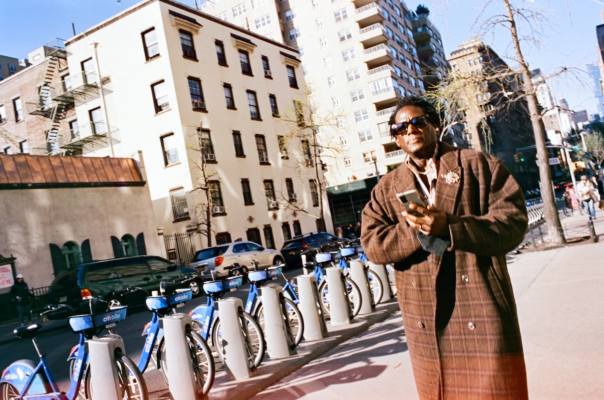

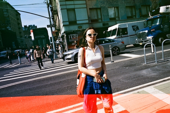

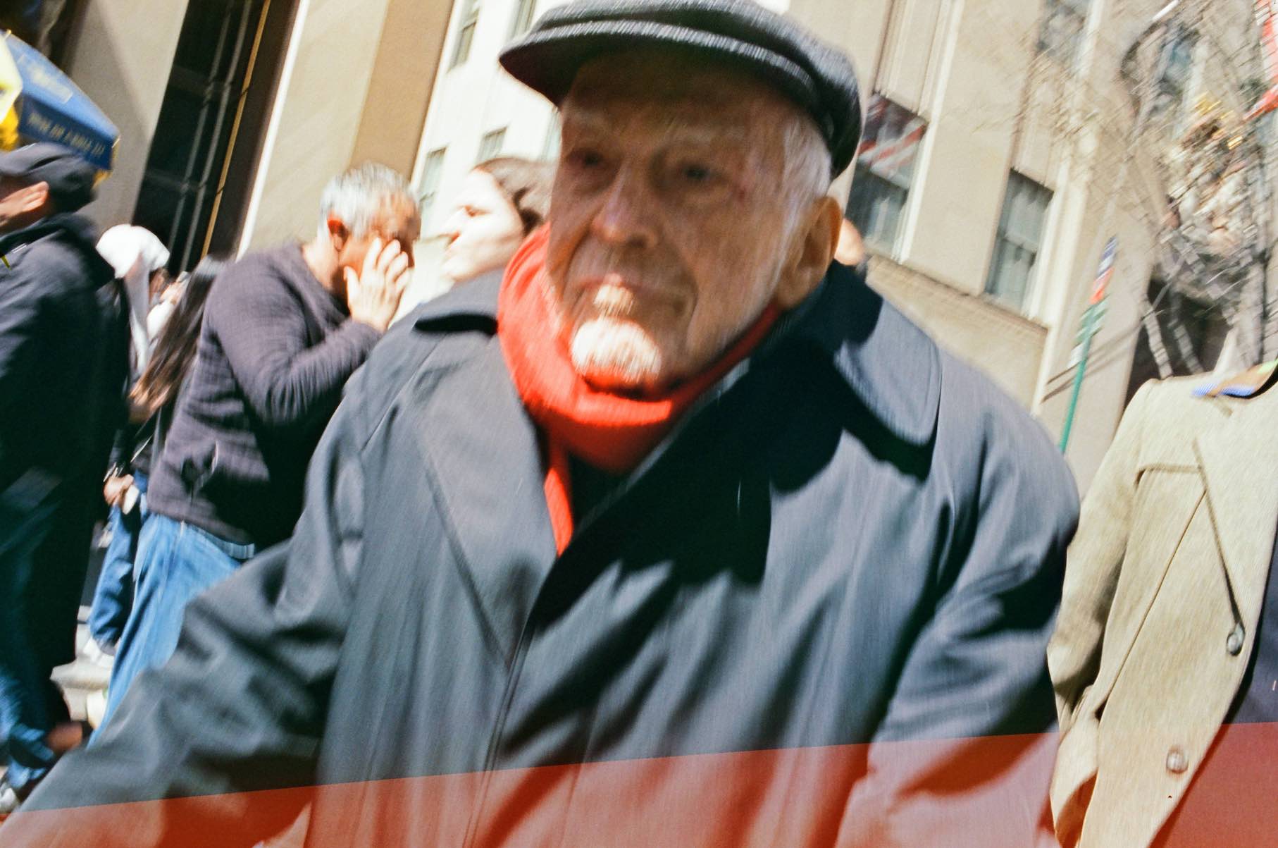

I have the next issue: I developed a few rolls at home using Paterson tank, bulk-loaded film with LLoy Daylight bulk loader, and reused cartridges from the film that I already shot.
On the last frames, I always have strange leaks with the same pattern, it doesn't matter how many frames I'm loading 18-24-38, always the last 3-4 frames have the same leak.
One time - I developed film and It doesn't have these leaks, and loaded normally, without changing bag.
I've tried to change cassettes - but I still have it, tried to shoot a different film that was not loaded manually - and there are no leaks.
I've tried to load film in changing bag, and in 1 of 2 rolls - there are leaks, but probably it's because previously I loaded it not in the changing bag.
It could be loader, but idk why it appears only on the last 3-4 frames and not on the whole roll?
These last frames are from 3 different rolls.

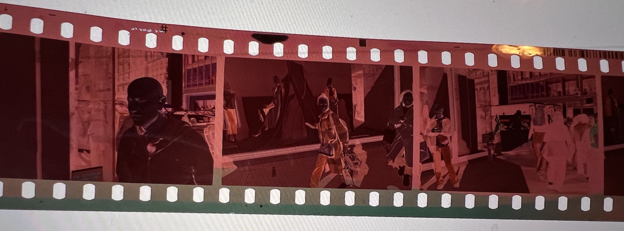

sorry, I don't have light stand to do it, so I just used my laptop screen for this:
as you can see there is just a black line and it appears at the same position every time
That's great, thanks :smile:
Any chance of showing the full area that's affected?
The shape of the fogged area suggests the problem occurs as the film is partially rolled up, but in imperfect alignment. The color suggests the exposure may be occurring through the remjet base of the film (so it's pretty strong fogging). Given this combination, my suspicion would be a light leak in the chamber of the bulk loader where the bulk roll sits, possibly near or at the gate where the film sticks out.
