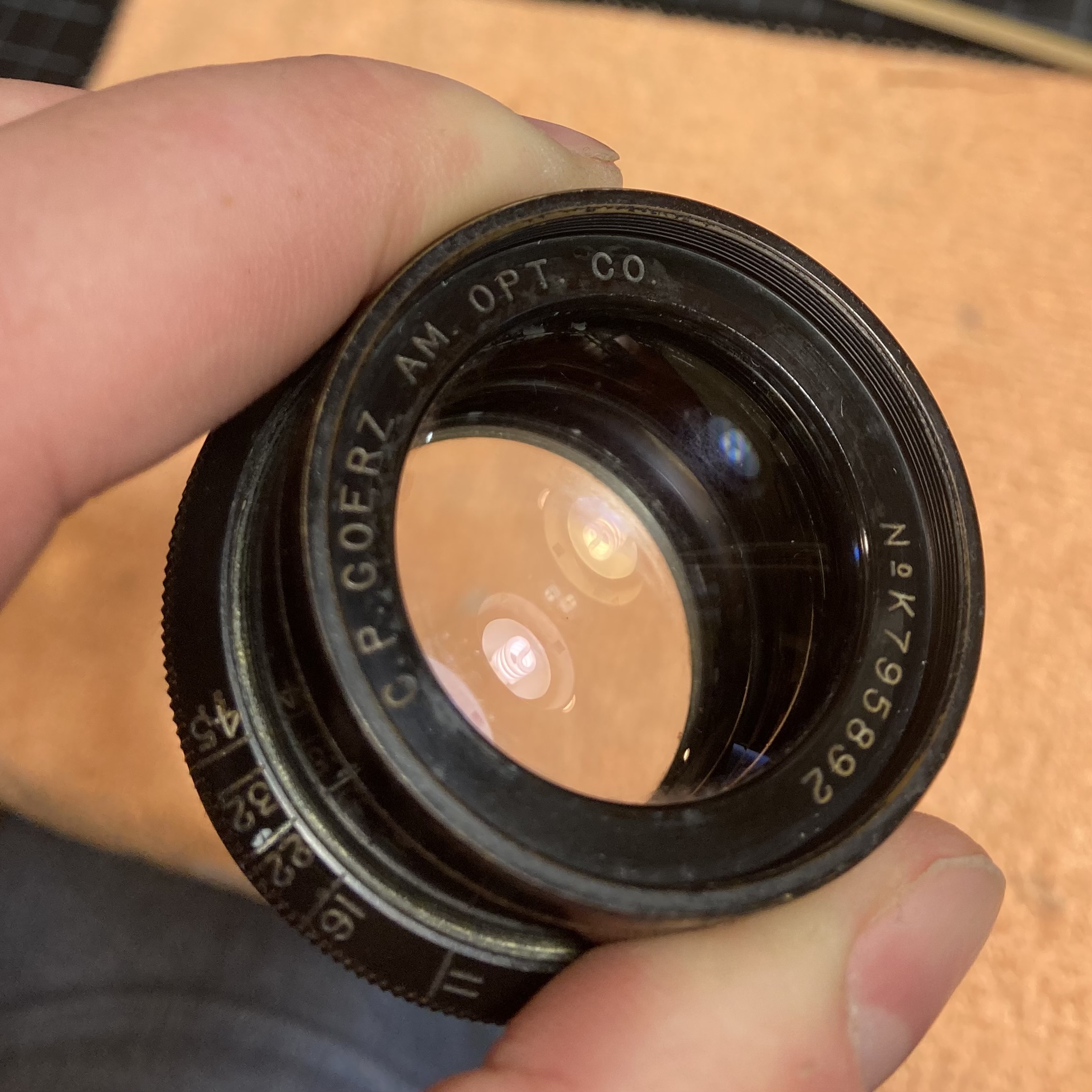

Hi all, first time poster,
I found this lens at a rummage sale this weekend and I’m hoping someone here might help me identify it.
It is a Goerz lens labeled only “C.P. GOERZ AM OPT CO” with the serial number “No K795892”.
It has a minimum aperture of f6.8 and a maximum of 45. I haven’t had much luck guessing the focal length.

I’ve removed the front cell for cleaning, when looking through it I’d guess that I’m trying to see how many elements it’s made out of. Any hints as to what that would look like?

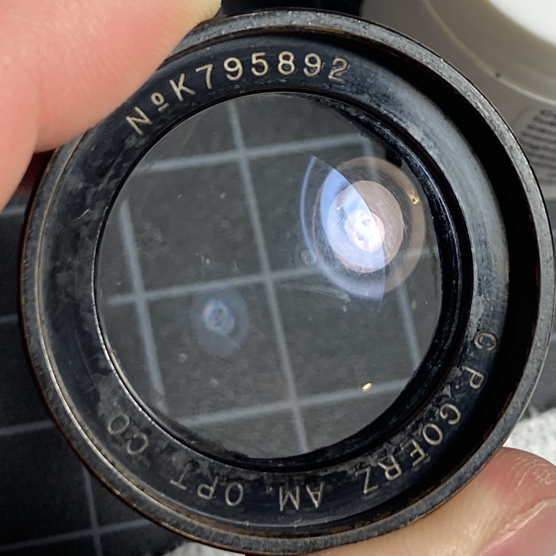

Not sure if order matters but in this picture you can see two small weak reflections and two bright ones.

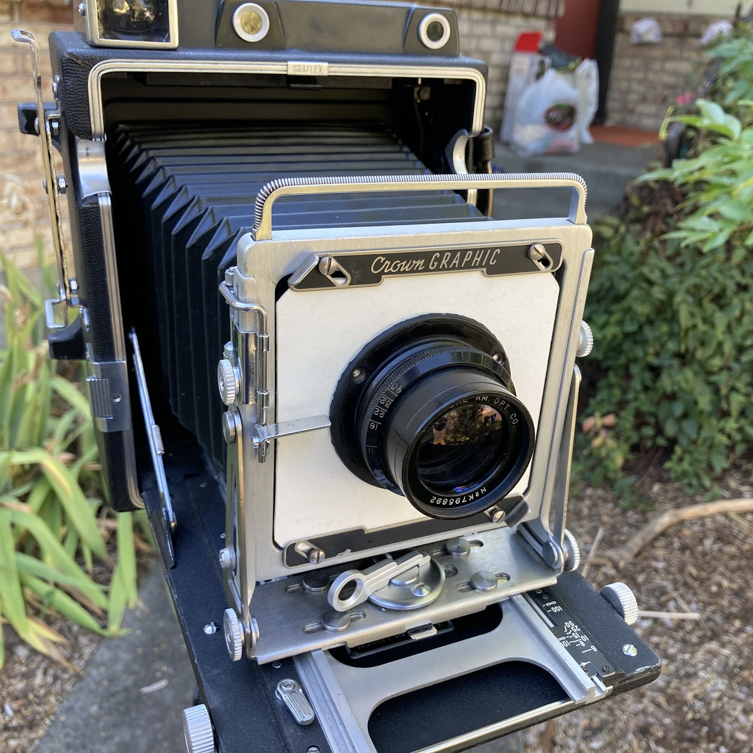

Makes sense! So it sounds like I’ve got a Goerz lens made for Kenro that is likely a Dagor design and I should try mounting it to my crown graphic and see what focal length it is.

Oh! Last question - Does anyone know what size shutter a lens like this might fit into? I’d love to explore mounting it into shutter for use with the crown graphic.

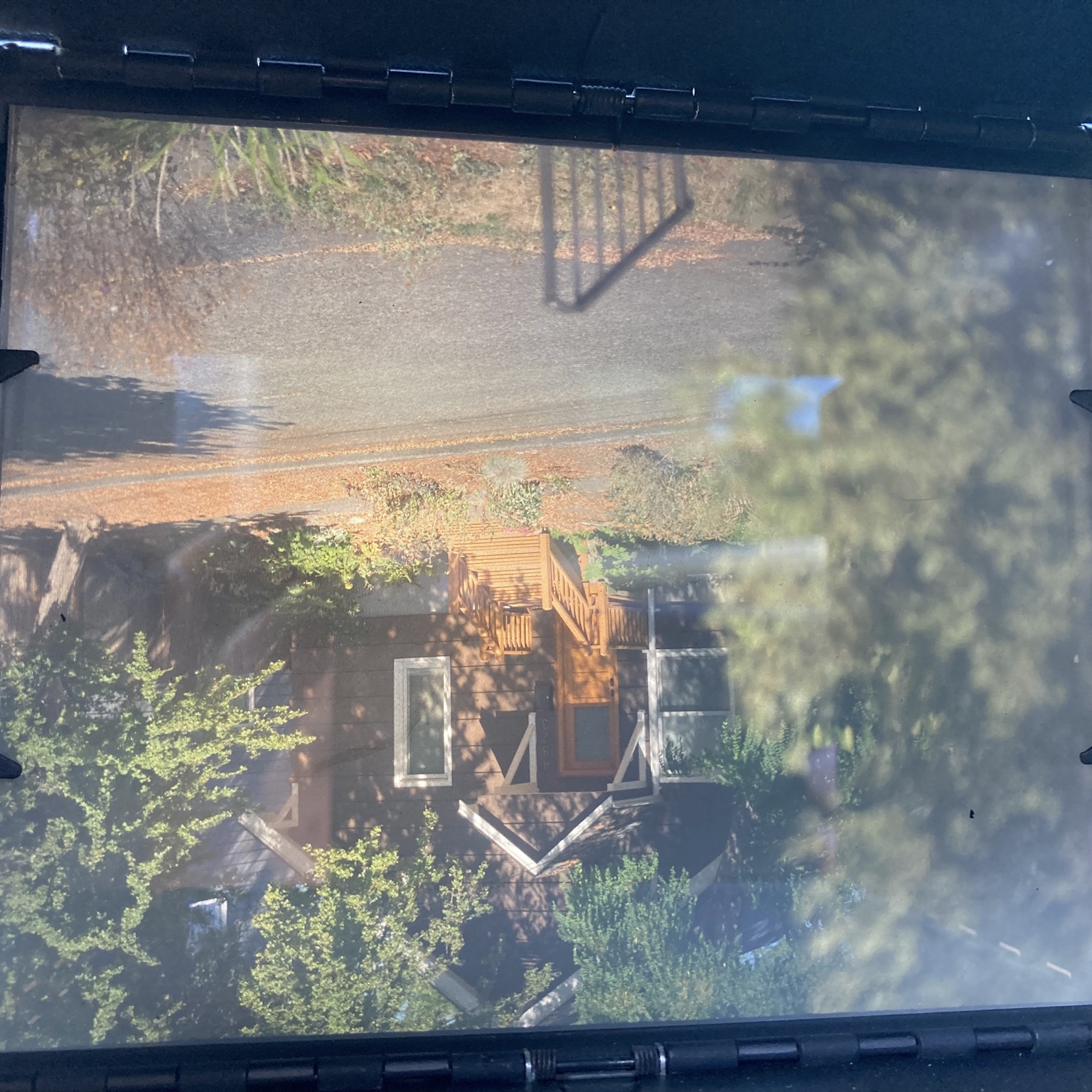

I have made "quick & dirty" temporary lens boards out of 2-ply mat board for testing focal length, vignetting, etc.

Precision mat board construction! Looks like a good bet at 8 1/4 but we’re bumping up against the limits of my measurement.

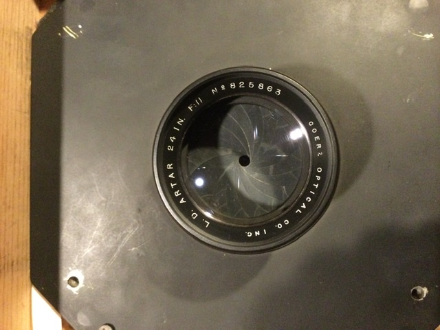

I'm jumping into this thread as I just took a gamble on ye olde auction site. The picture was blurry and there was only one. I shot a pretty lowball offer out.
The lens is labeled Goerz Optical Co inc. L.D. Artar 24" F11 As near as I can tell, serial number is 6 digits and I think 82556? I've stumbled around and found that the Low Dispersion/Distortion was already a feature of these lenses but it being marked as such is somewhat uncommon. What I'm really curious about is if it's an Aluminum barreled 24" or not as that would be pretty neat.
I'll find out in a week or so. It's mounted on some big metal plate and shipping in a wooden box, so the tax and shipping combined to make it not a steal, but still a decent deal especially if it turns out to be the alloy version. Fingers crossed.
It's actually typical of Goerz. Many of their lenses were symmetrical, or near symmetrical, and were marketed for their low distortion. For a process lens like the Artar this was even more important, and it came on the market in the early 1910s! The rare LD version is supposedly a later tweaked design and even better. 🙂

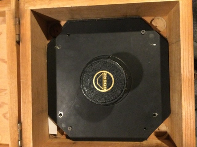

I received the lens. It’s an anomaly I think. It seems way too heavy to be an Aluminum sample. The mount flange is brass for sure. Serial numbers match front to back.
It arrived mounted to that crazy Aluminum plate and in a wooden box.
Thankfully, the glass is in great shape. The aperture has just a slight hesitation, but is smooth past that, and the blades look good to my eye.
My question for anyone sitting on Goerz info is how do these measurements jive with published ones?
Mount thread diameter on barrel = 3.027 inches
Diameter of mounting flange threads = 2.972 inches
Thread pitch for both is 24.
There’s no way this is going into a Copal 3
My measurements were done with a Mitutoyo digital caliper, and the pocket knife style imperial thread pitch gauge.
