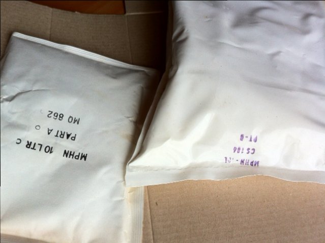

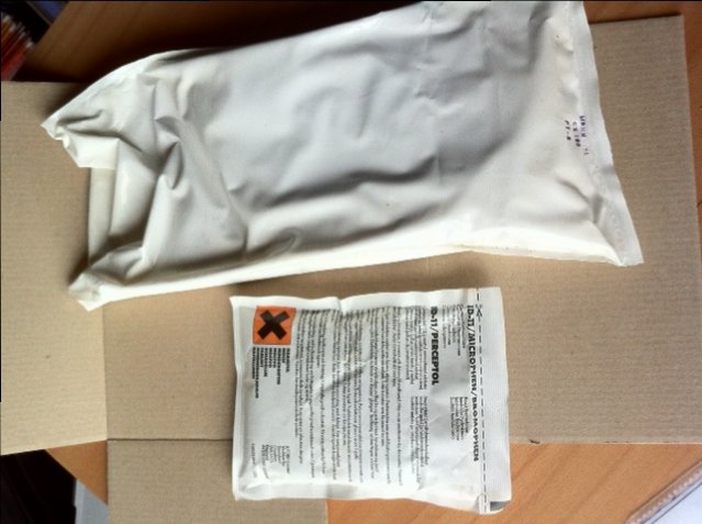

Hi,
Cleaning up my darkroom, I found a set of chemicals I was given some time ago and I can't identify it. It is a blank brown cardboard box (without the wrapping label) with 2 sacs in it.
One is a small sac (paper?) with a stamp:
MPHN 10 LTR c
Part A o
MQ 862
On the other side is printed: ID-11/Microphen/Bromophen and ID-11/Perceptol and ILFORD limited
The other sac is a much larger white plastic sac containing powder. It is stamped with:
MPHN-10L
CS 186
PT - B
Can anyone tell what this set is for and how to use/mix it?

I never used Microphen. Is it any good?
I'm guessing that part A is the same for all these developers and part B contains the chemicals specific for Microphen?
The info from Ilford:
"To prepare stock developer, dissolve the contents of part A (the smaller bag) in about three-quarters of the total solution volume (see carton) of warm water at about 40ºC/104ºF. Stir until most of the part A powder has dissolved, continue to stir while gradually adding the contents of Part B (the larger bag). Keep stirring until no more powderdissolves. (NB it is normal for a few grains of powder to remain un-dissolved.) Add cold water to make up to the final volume (see carton) and stir. Allow to cool to room temperature, nominally20ºC/68ºF, the developer is then ready to use."
The "total solution volume" would be 10 litres in my case, I suppose. I can't check the carton since it is missing.
I think I'll divide it into smaller batches since I don't develop that much film.
