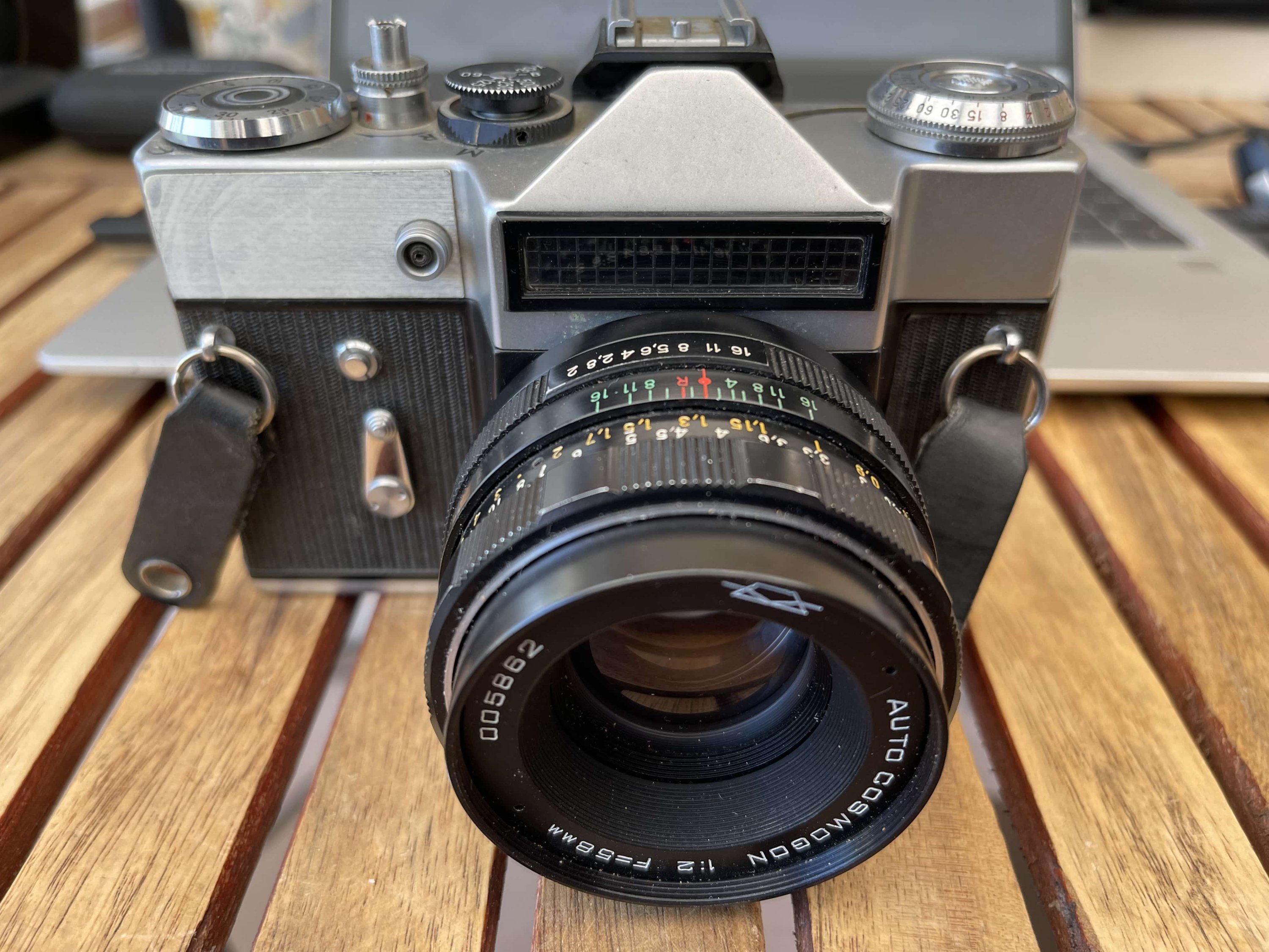

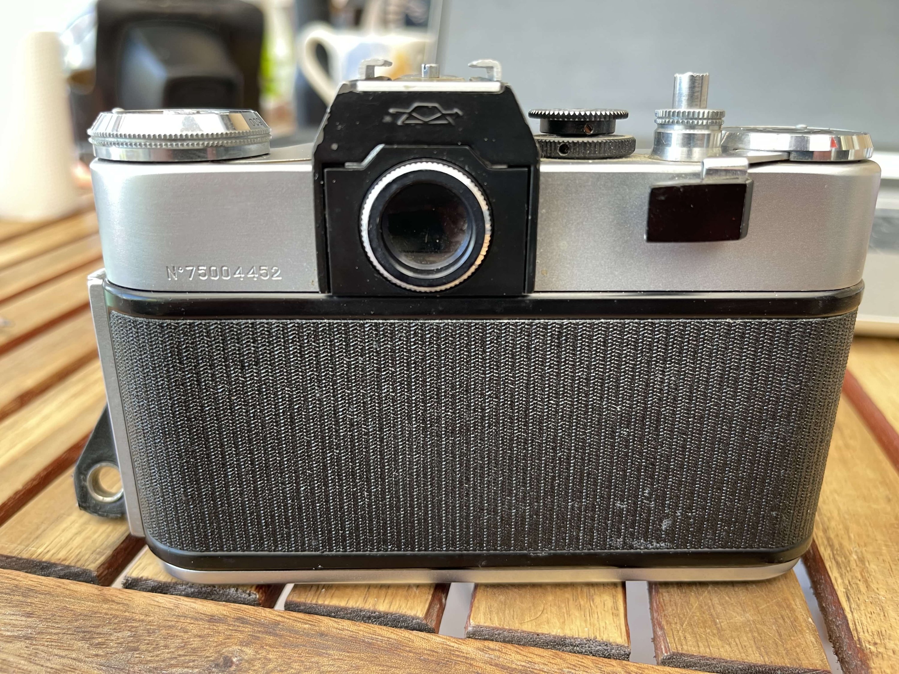

Hi all - I've just recently acquired a Zenit camera, and in the process of trying to learn my way around it's functions. But I am struggling to identify the exact model. It looks very much like a Zenit E, but the shutter release is in a different spot.. Any help would be greatly appreciated. I have attached some photos.

You most likely got a Zenit EM.
One now may wonder why the designation is missing. You may check if it actually yields all features of the EM, especially the automatic diaphragm.
It instead may be an inbetween special model.

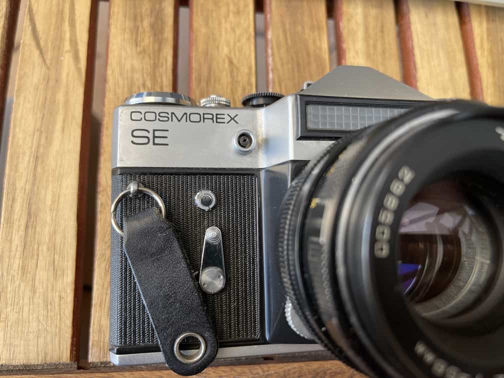

Hey! Great spot on the patch!! That's exactly what was there, I've just pulled it off...

So it seems a EM custom labelled by KMZ, with brand and model just on one side which later got covered. Either by the user or maybe by someone who bought a surplus batch either from KMZ or that Cosmorex entity under the prerequisite to sell them with covered label.

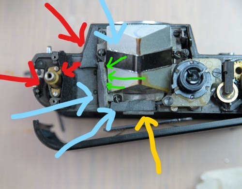

Photo shows a plastic topped ET, but it is very similar.
Blue arrows show where the original foam to be replaced is.
(Red arrows are where I add additional light seals as the plastic ETs are known for light leaks, green arrow is where light gets down the side of the prism & where I add a light baffle)
The brown line on the top of the prism is something Zenit put on their prisms, no idea why. Anyway, the foam under the black prism clamp degrades and eats into this material, spreading along it and then into the silvering underneath. This is why you get a horizontal line.
I'm happy to assist with guidance & photos if you want to have a go at replacing the foam.
Zenit Es go for 99p on Ebay. You may be lucky & get one with a good prism, or get one for 99p to practice taking apart before attempting on your own one.

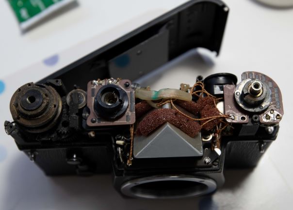

Below is a Zenit 12XP, the horrible sticky brown foam can be seen. The E does not have the wires or circuit boards, so is easier to work on.
