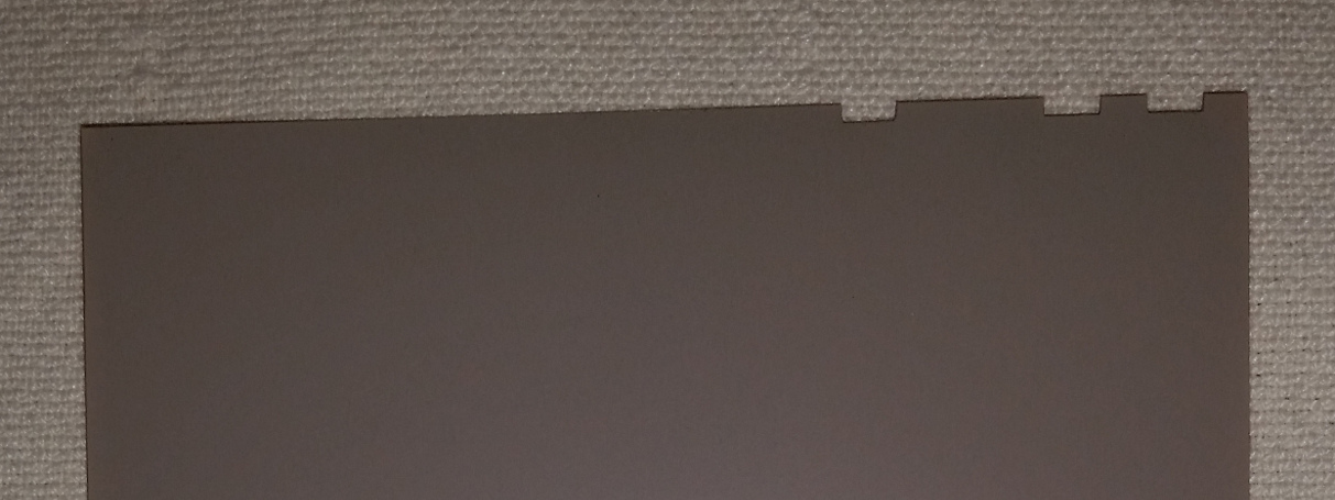

Can someone help me identify some 4x5 film and suggest development?
I recently acquired a Kinematic holder, and when I went to test it, found it was loaded. Since I only ruined one sheet, I pulled it, and cannot identify the square notch-code on the internet (I'm still looking).

The notches would suggest GAF/Ansco as above but may be a special order rather than stock, Kodak used extra notches for special order.
http://johnesimmons.com/?p=1438

I finally developed it tonight (it's still Saturday until I wake the following day). Last week had fallen through due to my best friend being ill (she's much better now).
I'd found those GAF/ANSCO codes too - but never the exact one. I wasn't going to assume it was good or unexposed, and have no idea how old it is, so was not going to shoot it or waste a lot of developer - I just wanted to see if there was anything on it. I used Rodinal 1:100 semi-stand.
That looks like the same green as the shred I found.
Whatever the film was, there were no discernible images on it. It had a dark mottled fog, as if someone cycled through the septa to see if the holder worked.
