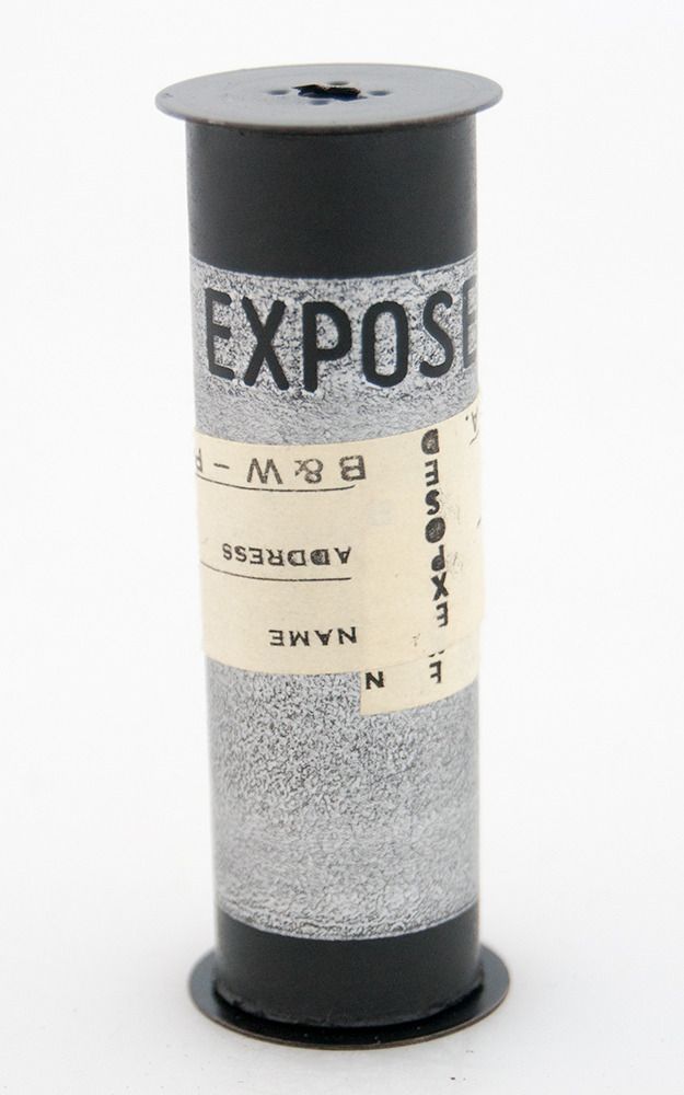

Help ID this film please

620 is the same size as 120 so just develop in normal 120 reel ... I'd try Diafine or rodinal 1:100 stand development

Thanks for the response. I should have mentioned that I have DDX on hand. As for the spool, I will make sure I hang onto it for the time being. I guess they are hard to come by?

After you roll this film to processing tank maybe you will see more info about film emulsion you re dealing with from beginning of the film paper backing?? Most likely it's Verichrome but who knows??
Excellent. I will look for that info.
gorbas makes a good point, a number of films have different colors and printing at the beginning of the backing paper. Last I looked, 620 spools weren't that difficult to find -- on ePrey, for example. It's just they cost as much as a 120 spool with new, in-date film on it! (I acquired a couple to use with my Brownie Target Six-20.)
So far I am planning on shooting 120, but I will keep a few 620 on hand in case I need them.
There's clearly marking "B&W" on the tape.
Yeah, I saw that when I pulled this from the camera. I guess I should have put this in B&W Processing and not here. I suppose I will check the paper for more info and then consult the Massive Dev Chart for a film DDX correlation. If there is none I will decide on an alternate course of action.
bdial
Jan 2, 2005
7,470
North East U.S.
It doesn't look like any Kodak roll I've ever encountered. It's perhaps more likely to be Dupont (or…?), and probably medium speed. Times for Plus-X or FP4 would probably work, or if you want to be thorough and are willing to sacrifice a frame or two, do a clip test.

John has a good approach there. Voice of experience. For old film you want to keep fog down so it's best to keep the development time short, with high energy and lower temp. (65F) HC110 is great for this, but the DDX should work too. Dektol or a print developer is also good. I think Rodinal and stand is exactly not what you want to do. You'd just be boosting up the low (fog) density too much.

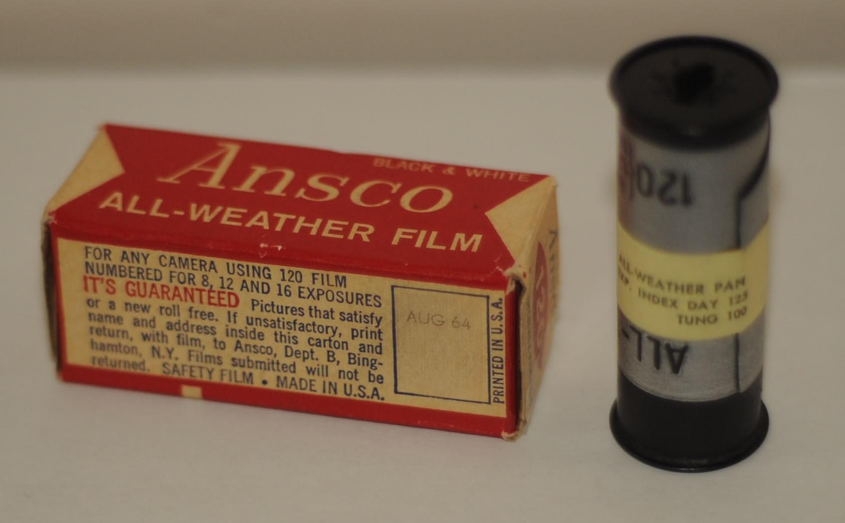

The black and silver color scheme makes me think Ansco film. I have found a few rolls similar to this, including some labeled "Ansco ALL WEATHER" film.
I agree that HC-110 is a good choice for developer.

Good eye there Denverdad. Perhaps that is it. I don't want to unroll it till I am ready or almost ready to process, but if it does say Ansco All Weather Pan I now have an ISO rating.
