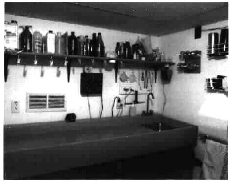

Here's what the wet side of my darkroom looks like (yeah, it's a lousy picture).
I built the sink using 1x4" 'D-select' pine frame, with a 1/2" plywood bottom. I put a cleat around the inside of the frame for the bottom to rest on. Everything is assembled using resorcinol glue and screws, and covered with five coats of a battleship gray 2-component epoxy paint. It sits on legs made from 1x2" "D-select" pine - legs at each corner, and an additional pair of legs in the center of the long dimension. Teh legs and other portions of the supporting structure are protected with a couple of coats of polyurethane varnish. The bottom slopes to the right, and there is a stainless steel sink installed at the right end. The hot/cold water faucet is installed on the backsplash behind the sink. I routed a rabbet in the plywood so that the surface mount sink actually sits slightly below the surface of the plywood - that assures that water in the wooden portion of the sink flows into the steel portion and thence down the drain.
I originally built this sink (back in 1980) for the darkroom in our former home where the long dimension was designed to accommodate four 11x14" trays. A second constraint was that the total length of the sink could not exceed the inside dimension of the darkroom, and that in turn was governed by the space between a basement wall and an opening into a crawlspace. We moved to a new home two years ago, and I built a new darkroom in which I reused this sink. Subsequently, I built a rack under the left end of the sink (not visible in the picture) to hold print drying screens.
When we moved, I sanded the sink and applied a fresh coat of epoxy paint. There are a couple of spots where the paint is cracking and I can see the wood starting to deteriorate. But after 25 years, I can't complain - besides, in my new darkroom, I have more room and would welcome an excuse to build a new, larger sink!
