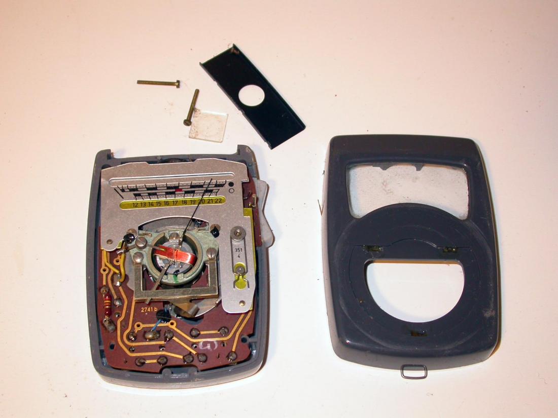

My Luna Pro (Lunasix) ceased working yesterday when a camera store fitted new batteries :mad::mad:
Completely dead, even with the old bateries again. I'm rather a long way from a repair shop, and need the meter.
However the fitting new batteries had to be a co-incidence as nothing untoward was done to the meter. Luckily re-examination show the needle isn't moving under any circumstances and the fault is now obvious, the glass screen has dropped and is fouling the needle, so it's a simple problem, open and re-position.
But how do I open up the meter ?
Ian

My Gossen Spot master broke down a year ago and I decided to try to fix it myself. Like Ian I found no obvious way to disassemble the meter. Apparently Gossen likes to hide the screws that hold the meter together behind plastic plugs. Looking at my Luna Six I’m guessing that the screw heads are located under the three grey plastic plugs at the bottom of the meter.
Hopefully someone who has some actual information will chime in…
The back plate is glued on and hides 4 screws. Eerily I did a search on Google and this thread showed up less than 10 minutes after I started it :D
I found a page with some images..
So now hopefully it'll be resurrected quickly. The glass is glued back in place.
Ian
Unfortunately the bad news is that the glass appears to have damaged the movement which is no longer balancing freely, it had dropped on to it. So I think it's posibly terminal. The cost of a repair + postage 2 ways is more than they are worth.

Suggest inspecting the galvanometer movement with jewelers loupe.
Noel
Used the next best thing an f1.4 Pentax 50mm lens, but you can't see the actual movement, but from previous experience with Weston's etc once this is damaged the meter's had it.

If you have it out of the case, look at the hairsprings and pivots at the pivots of the needle. One of two things may have happened when the glass was loose. The hairspring may have jumped a coil or the needle was knocked out of it's pivot.
If it's the coil use something non-magnetic & make it hop back, I use a toothpick or bamboo skewer. It is a very delicate spring & I think one of the most difficult items to get right.(my hands shake a lot) I rest the point on something solid for support.
If it's actually out of the pivot you may be able to pop it back in by putting a light outward presur on the pivot point & maneuver ing the needle back in place. It's easier than dealing with the hairspring.

This is a non-functioning meter I bought years ago, just to figure out how to open the case.
Charley

John the oil is a bit of a mess it's out of the pivot and damaged as well, so I've contacted Charley as the coil is easy to swap over.
Ian
Update
Thanks to Charles I've now managed to make a good meter out of the parts from two. It's this kind of help that makes APUG such avaluable resiurce.
