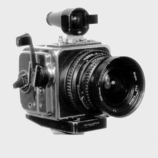

Hasselblad would not have become a highly priced industry standard if they were not fast and easy to use and produced superb images
If you get rich get the fun one, the SWC.M, which is the World's most expensive box camera
My very full Hbd kit is up for grabs as I no longer like printing from such tiny little negatives, but Quinninup is a long way from Derbyshire - There must be a Hasselblad user near you
