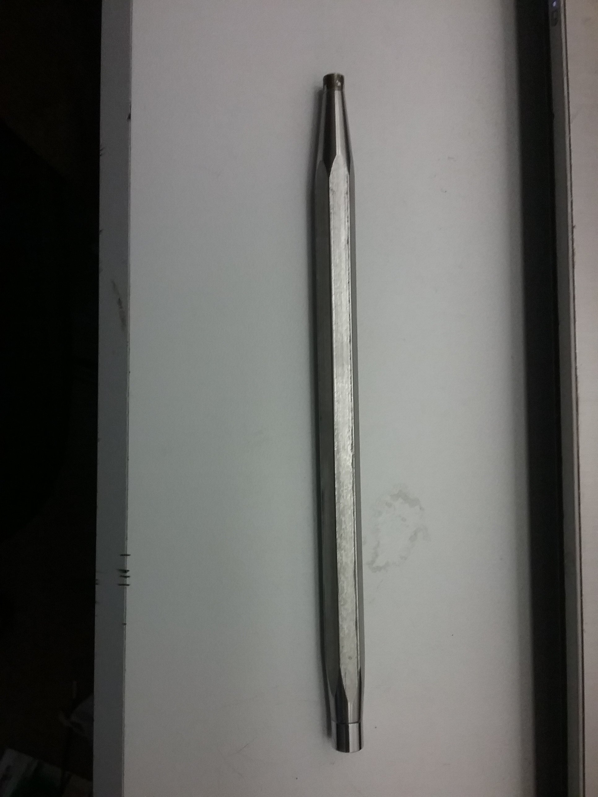

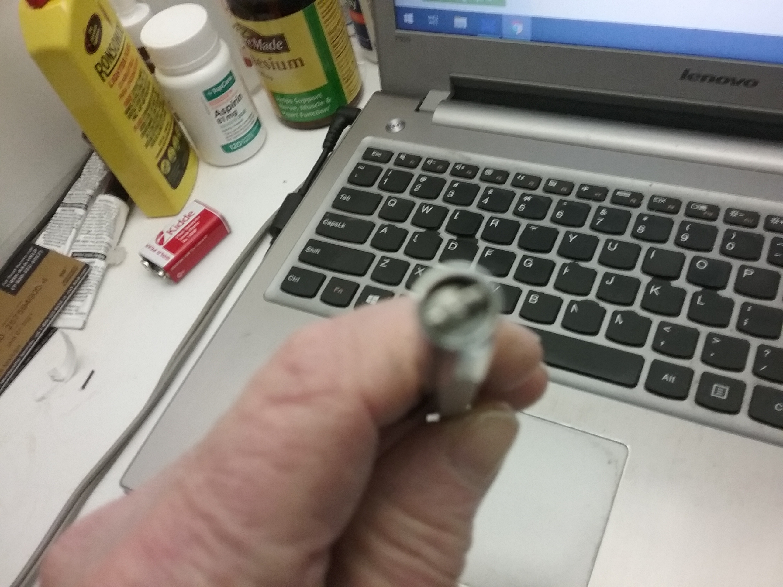

There is a tool that will un jam the lens.You can find it on E-BAY, it's inexpensive. I had a lens jammed and ruined a lens trying to loosen it. This tool will help avoid future problems

If you have not loosened the lens yet and cannot find the tool send your address. I no longer have a HASSELBLAD and do not need my tool. I will ship it to you for free.

Thanks for the offer but the tool came Saturday. Trying it today.

Using both the "tool" and a screwdriver, I found it impossible to turn the screw. and did not want to apply excess force. So off it goes to repair.
