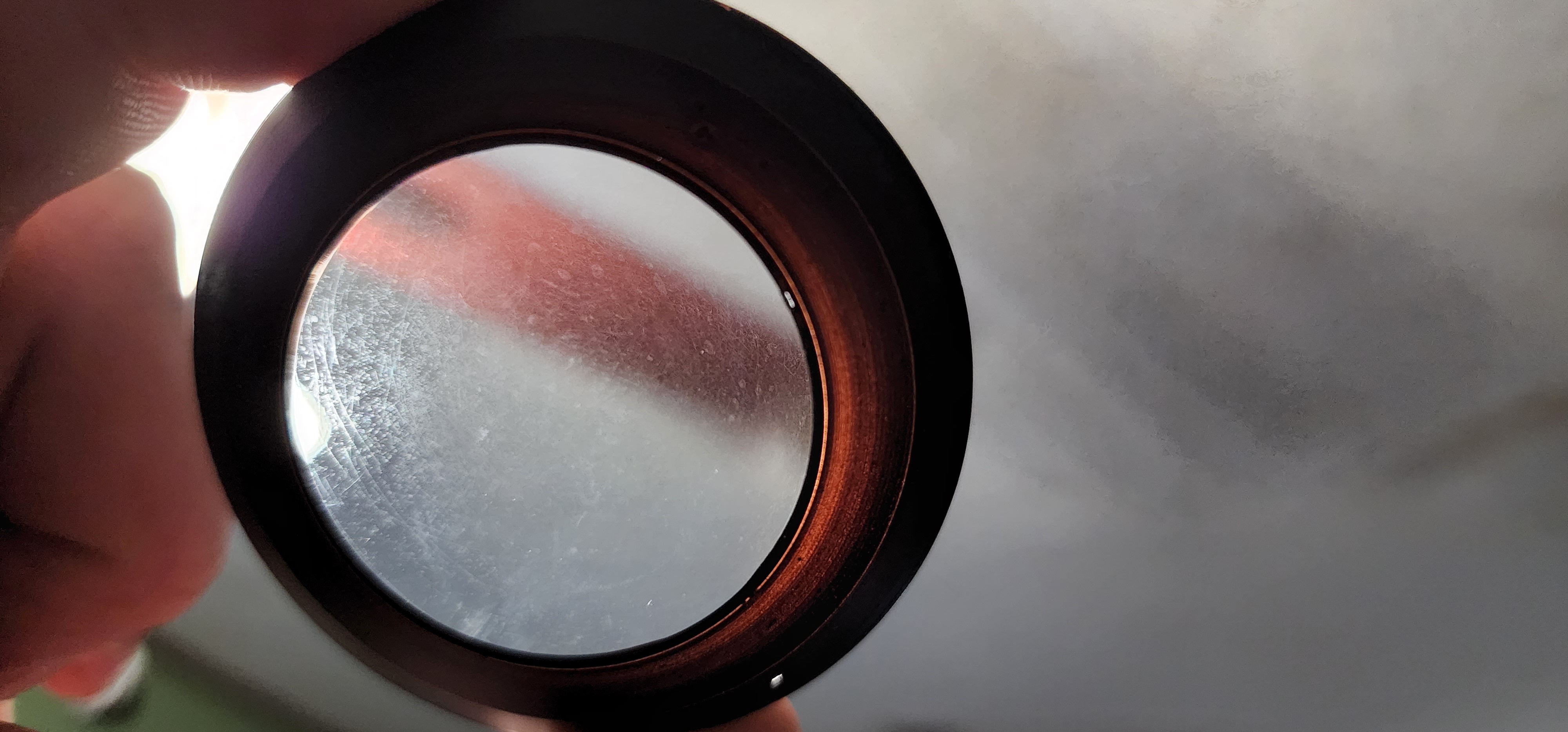

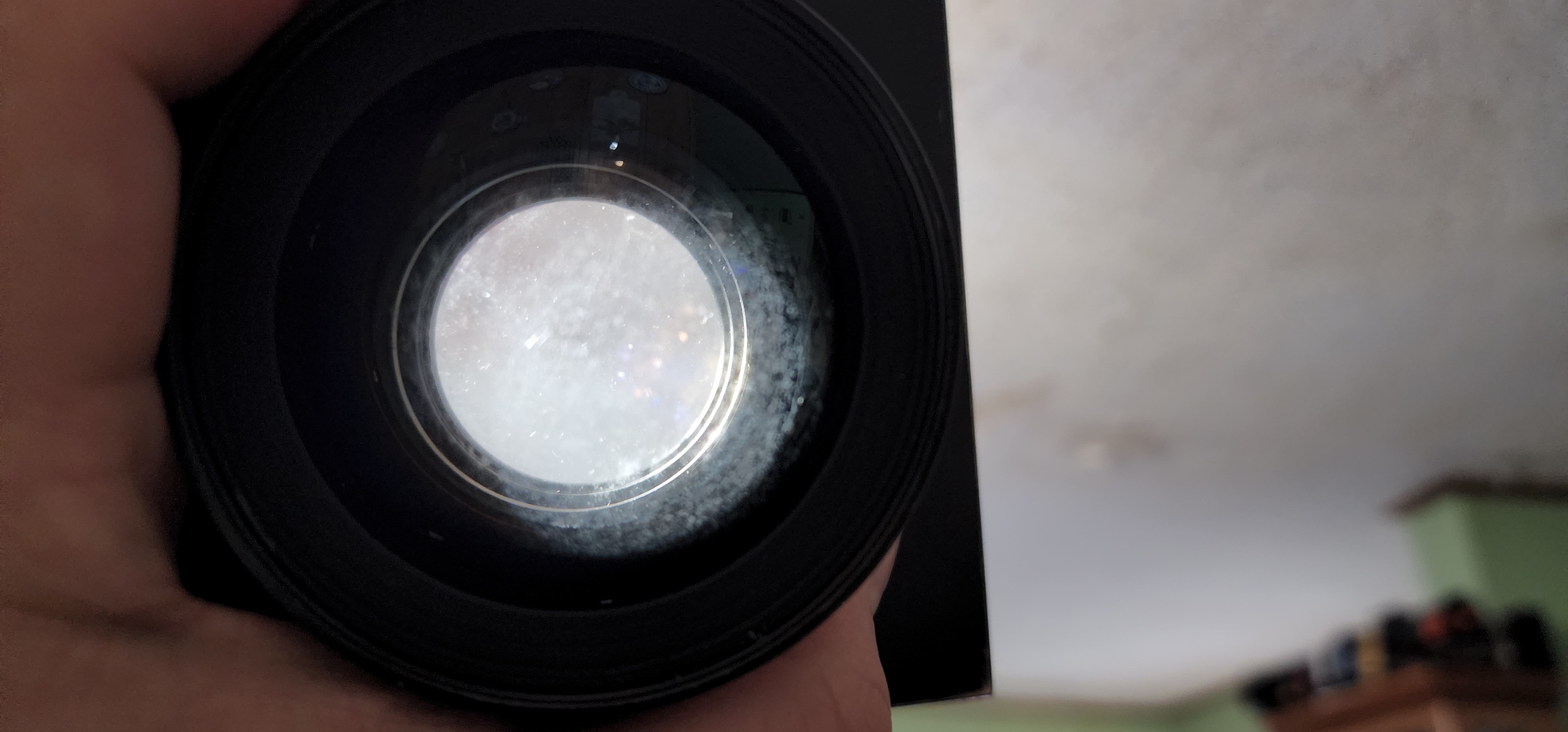

Fungus or separation? and is it salvageable?

It looks like it could easily be one or both. Hard to judge from a web image of course. Can you get to the rear element? I'd start there, take it out and see what's up inside

That top photo is the front element only out. The other elements are clean other than a little dust

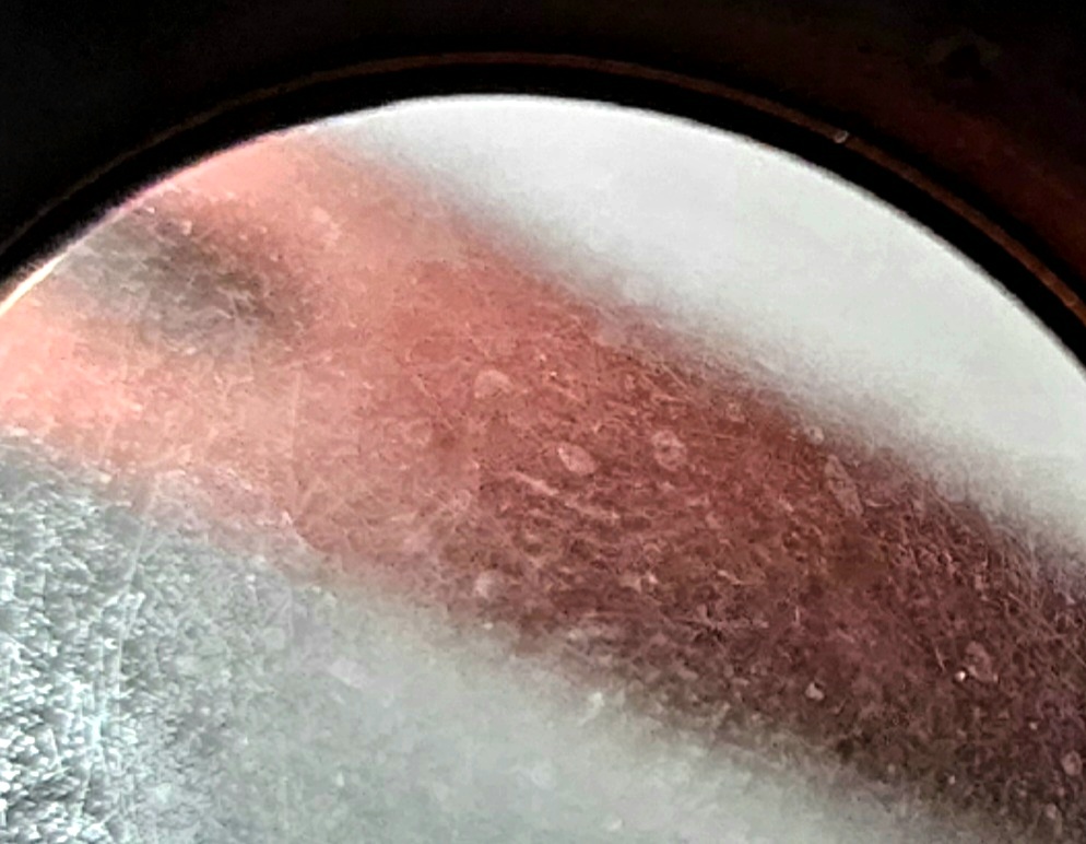

First, can you tell if that's a cemented pair of lenses? If it's not, no separation. But in my (fortunately) limited experience of separation, it always started at the edge and spread inward. The random spread of this and that track in the top photo make me think fungus.

Yeah that's what I thought too, and yes it's a cemented pair for thst front element.

It doesn't look like fungus or separation to me. Since it is a cemented pair, you should be able to determine if it is on the outside or the inside. If it is not on the outside, cleaning the outside won't help at all.
There have been samples shown of inner seperation.
Seperation and Fungus are worlds apart concerning look.

To me, looks like fungus. Possibly etched, if the usual suspects aren't working well. I have a lens in that bad a condition, and I've been unable to clean it successfully.

another that says it looks like fungus.
depending on the value of the lens, the elements could be separated, cleaned and recemented.
I've done this once or twice successfully it's just a PITA.
That could mean that someone sanded/etched the front lens for David Hamilton-like portraits and nudes. It doesn’t look like fungus to me either.
