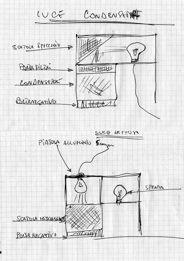

Hello,
I'll try to explain my problem with m800. I'm Italian than my english is non very good.
I would like to change enlarger set up from "condensatore" to sharper light. Don't understand if I have to buy only setobox 66 without change anything about bulb or I have to provide to make a box for a new kind of light.
Sorry, I don't want stress you but are days that I study this solution. I'm non sure about understanding

Thank you! Non I haven't hear my enlarger but I can say that it has an opaline bulb light. I print with condensatore as well but I prefer sharpness.
I still saw around many forum that is possible to change condensatore with satobox (maybe 66) than make a container for another bulb type like in picture in attach.
I don't need color head, it's very difficult to find

In the original setup the enlarger already has a condensor.
What you indicate in your sketch is to take out the mirror box. But I do not see a substantial change in illumination by doing so. Other than that in your sketch, to my understanding, the condenser will even be too near the lamp, even worsening illumination.
A point light illumination not only needs a different, very small, nonopalized lamp, a new power supply, but also the means to fine adjust the lamp or the condensor, necessary at any change of enlarging scale.

I try to explain better. I want to replace condensatore with setobox diffuser. Now I print in 35mm with condensatore and I don't like it

Yes I know. On M800 enlarger is possible set up either kind of light source, I understood that on m800's user manual My question is more simple (maybe I think so ) . The colour head I think is required for colour printing or for graduate filter black and white . The white light could be mix like an other colour, I think so
