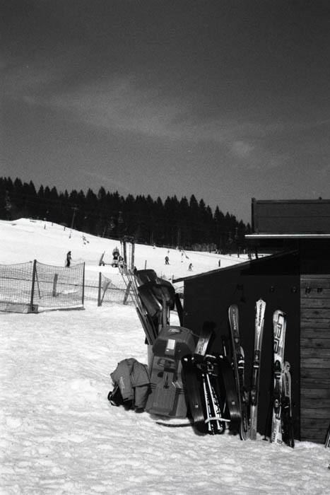

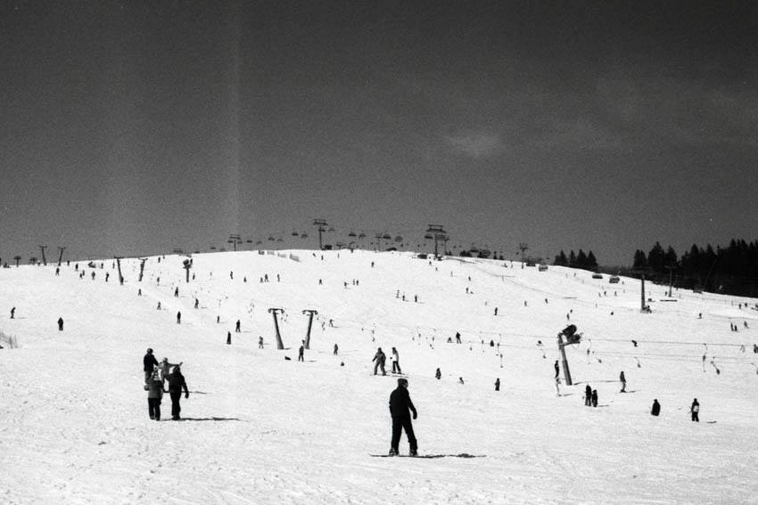

Thanks... Here are some results. :smile:
Following BTZS, here is how I do it:
1.assume that box speed -2/3EV is correct and shoota few tonal range scenes on 5 rolls or sheets.Yhen developthem at 4,5.5,8,11 and 16 minutesLook at the resulting negatives to determine the best dev time.interpolate as necessary.90%of my film tests end upwith box speed -2/3 EV and 10-12min in D761+1 in rotation on the Jobo.
all the best
I am unsure as to your reason for posting these. The developing looks adequate to me. The exposures seem otherwise. I wouldn't say snow overexposure is an issue. The pictures themselves put me in the mind of mid last century, noir–y, true detective magazines. Very harsh, super contrasty, and no shadow detail. If that was your goal – mission accomplished. Are these 120?
The snow doesn't look over exposed to me. Do you have a good example of a well exposed snow ground so I can compare?
I think the high contrast and very low shadow detail is expected since we are talking about pushing 3 stops. But the red filter I used was the actually main influence.
My goal was to get more grain but I actually love what I got. The "aggressive" look.
Of course, and as I suspected. That's what overly strong filtration will do for (to) you. As I say, if you like that look, then you're there. You will find plenty of support for your style of photography among the frequent posters here. If you'd like to see examples of full tonal fine art monochrome photography, with shadow detail, you can go to my site, where nothing stronger than yellow filtration was employed. I have already posted plenty of unappreciated examples here already.
Beautiful and well done photographs you have in your website.
I do landscape too with shooting at low ISO which I think is easier to get details on shadow.
I like the high ISO and agressive look for my street photographs. The shadow details are not that bad if I proper work on then. Here a example:
http://www.marciofaustino.com/uploads/1/6/4/6/16464874/221853_orig.jpg
Theses shots are just test to see what I could get from pushing K400 at 3200.
By the way, they were shot with a roll of 35mm.
Kentmere 400 @ ISO 3200

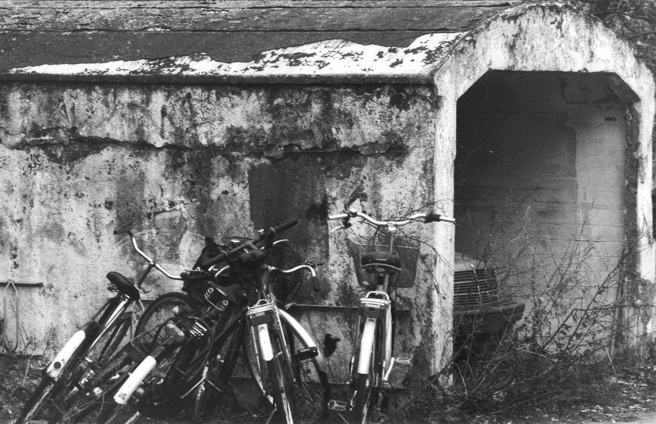

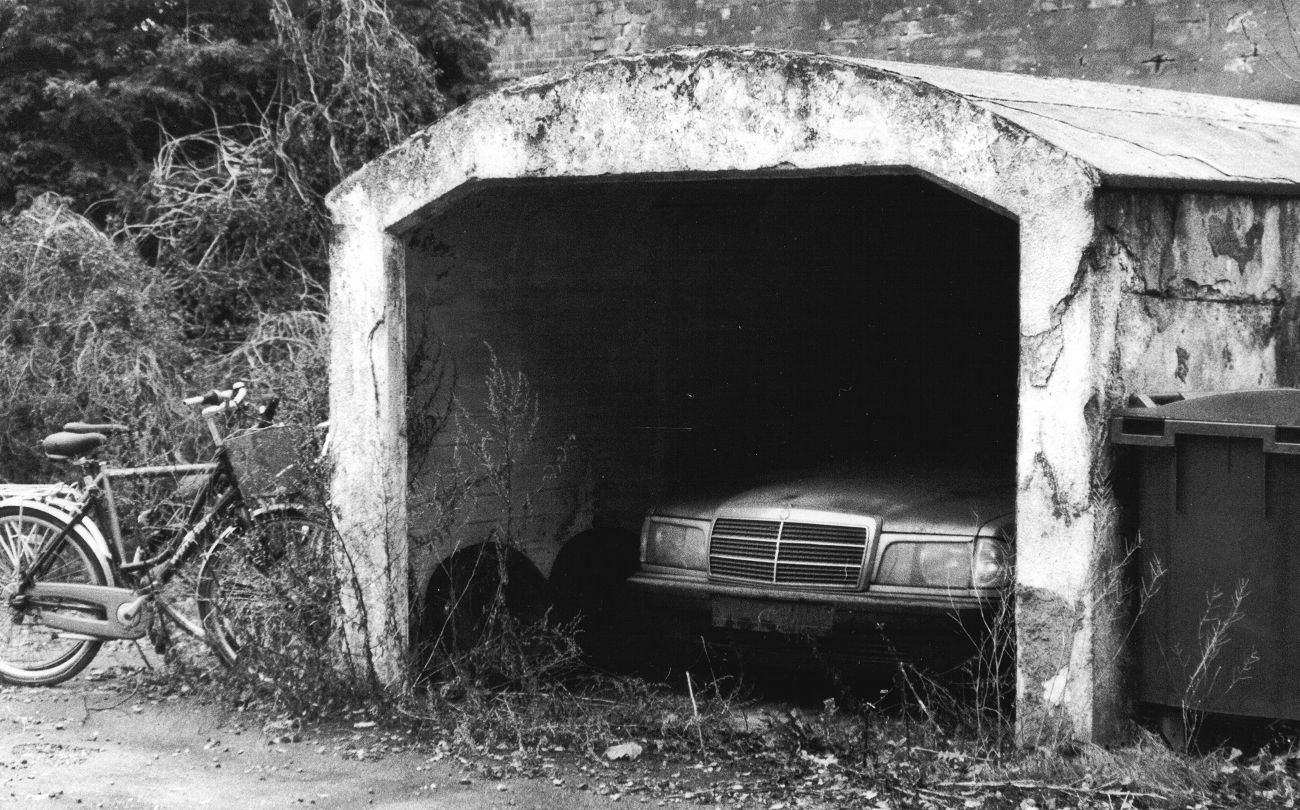

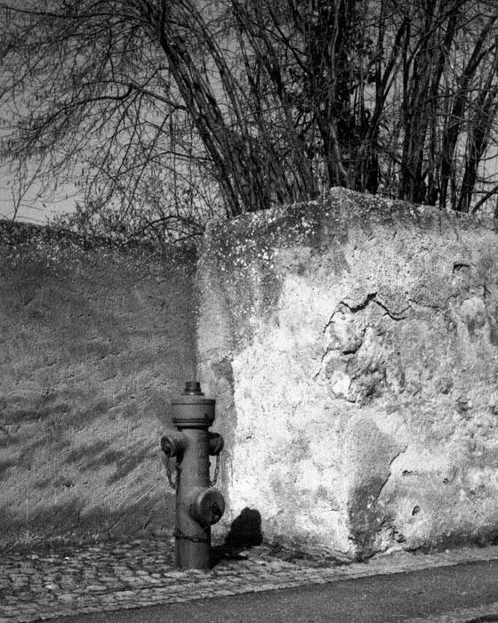

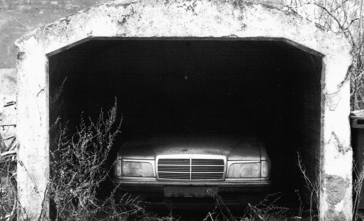

Hello Marciofs,
After a little experimenting, I have (in my own opinion) had reasonable success pushing Kentmere 400 to ISO 3200 in Rodinal/R09 1+25. The appended shots were made last November at 2 PM on a "cloudy bright" day - which at 55°40'N is not very bright.
Development time was 20 minutes, with very gentle agitation every 30 seconds.
Incidentally, the prints were made on 20+ years old Orwo paper (found in an attic) and then scanned on a generic home office scanner (I apologize for the dust and cat hairs on the scanner plate).
These imperfections notwithstanding, the pictures should still convey an impression of the possibilities offered by the combination K400 + Rodinal.
Best of luck!
Regards,
Michael

Thank you for sharing.
It seems to me that wuth Rodinal/R09 it looks even better than with Ilford HC.
I thought about trying develope with Rodinal but wan't sure how many minutes I should develop it for. Thanks to your post I know now.
I just bought in the internet 10 rolls of Formapan 400, just to compare with Kentmere 400. Both are grainy and push very well but Formapan seems to have a old formula and deliver an old look which I also like.
Anyway, I like the result you got and it is what I want to archive, a more agressive heavy and grainy look.
Thanks. :smile:
