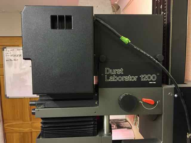

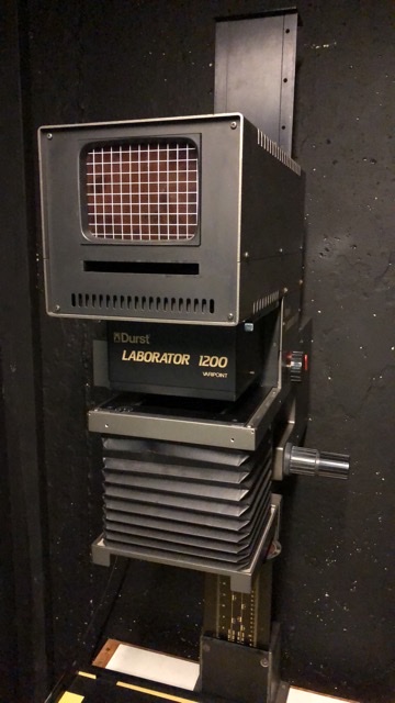

A friend gave me this Durst L1200 that sat in his storage space. For a tank a gas it was given to me. He had no previous experience with it and had never plugged it in. I’ve since loaded it in my space and faced a few hiccups right out the gate.
1.) it was loaded with a PH212 150 watt bulb. Plugging in the power adapter and everything into my timer generated nothing. I could hear the power adapter running. I later discovered this power source was a special Durst item that only outputs 12v.
2.) I then picked up w 12V RV lamp (100 watt incandescent) and alas, it fires. However, this model is the Varipoint enlarger and given then RV bulb isn’t a point source bulb it’s a little funky.

The L1200 is a good chassis - personally, unless you really want condensers, I'd go with using the MG500 as intended, set up as a diffusion unit. And then sort out the condenser head if you find yourself needing +2 grades of contrast. Quite frankly, if you want the effect of condenser head and MG filters, my own perspective is that the conventional 150w head and under-lens filtration is just as fast & more reliable long-term.
Oh, and Durst's reference system is a confusing pile of weird non-acronyms. Kienzle might be able to supply some parts (neg inserts, possibly condensers) that are hard to find - if you are prepared to pay a realistic price.
The issue is the power source I have won’t allow for a 150 bulb as it only outputs 12 volts. A new power source is freaking expensive as heck.
question: would installing the MG500 head on this specific L1200 be possible? I’m just not sure if there is a difference between the color head version and the condenser Varipoint model that I have.
any tips on installation? EDIT: didn’t realize you linked instructions.
All L1200 chassis are the same, the heads are easily interchanged - you will need an adapter and extra counterweight for the MG500 as that Ilford document I linked shows. The parts in question could be made by many reasonably skilled people.
The main issue you have with the condenser head is that you have the point-source rather than the regular condenser - I think the main difference is the socket/ wiring - and the optical surfaces may be coated (mirror, condensers) as opposed to the regular condensers. In essence, the condenser head is a light socket that has x-y controls, a mirror and a filter tray - all wrapped up in a metal case. Equally, someone may want a point-source head and all the bits - and the CLS/ VLS/ Femokit heads do turn up from time to time.
