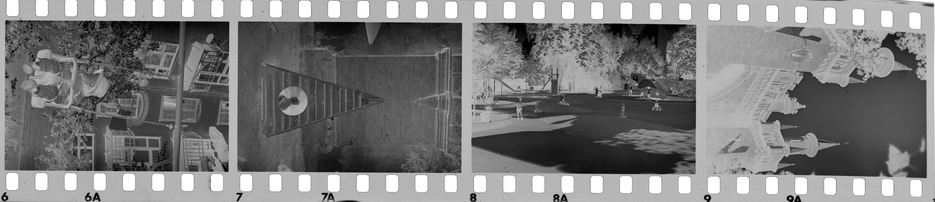

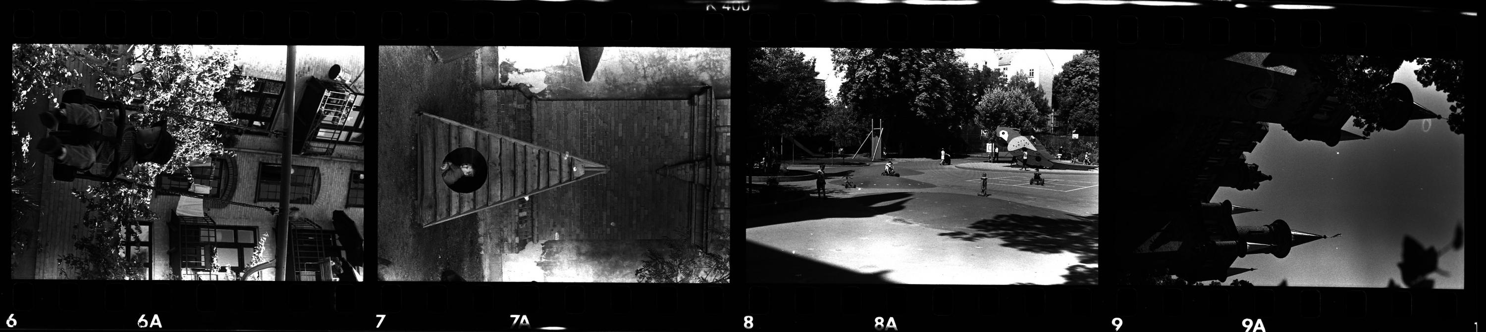

I just developed some Kentmere 400 and have an odd issue that looks like dead fixer but only on the frames, not the blank spaces as I have seen before. It is also not on every picture in the roll and I developed 4 rolls in the same cannister at the same time. The other negatives do not exhibit the problem but the images were all taken with the same camera, Nikon FG and mostly with the same lens, series E 50. The only thing that could be different is that I may have used an orange filter on this roll instead of a yellow one.

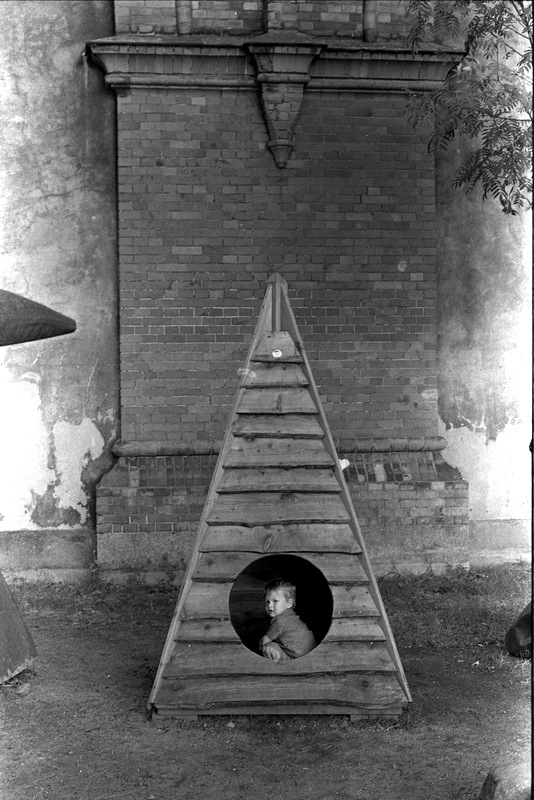

The images are of the same neg, one reversed, one as transparency. The reversed is scanned very dark to enhance the problem. Last image is just a closeup, and even though this is not something I want to happen to all my negatives, I like the look in this photo. I cant figure out if its a camera light leak, film canister leak or something in the developing stage.
Any ideas?
The film is quite flat, so it cant be that. The top two are flat on glass scanned.

This was scanned in the carrier.

You are referring to the effect on the edges of the frames where the positive looks much lighter on both sides of some of them? I really don't know, pretty sure it's not your chemicals. My guess is a sporadic light leak in the camera. It might take a lot of ambient light to cause the problem, so it only shows up in frames you took after standing around in the bright light for awhile.

It looks like overdevelopment on the edges to me rather than a light leak.
What is your agitation scheme?
I agitate for one minute then 10 seconds every minute. Its a gentle inversion, just twice...
D76 1:3
I just scanned the last roll from the same tank and it looks like I have more of this but it seems isolated to the middle of the tank or the end of the roll that gets loaded first.
I am using stainless steel.
It appears equally frequent with the reels in the bottom and the top of the tank but maybe top reel was slightly worse on the innermost image. There was a double exposure like the roll had been removed and reinserted in the camera on that first shot though, so don't read too much into that.
Wouldn't light leaks effect the rebate?
I am starting to think developing.
Would slightly old developer do this? My D76 stock is December 20 dated but was clear and worked fine with a clip test. Many exposures do not show this top & bottom edge effect but since this edge is close to the reel rings, perhaps the technique or chemistry could be a factor.

I agree with polyglot. I think it's not a light leak issue, but an agitation problem. I've seen it happen with certain types of 120 film I've processed and had to change my agitation regime. I haven't used D76 1:3, but have used Perceptol and D23 at 1:3 and have not had this problem. I also don't agitate for a full minute in the beginning either. 30 sec and 5sec every 1/2 minute afterwards. The most important thing I found was not to agitate like a maniac. I use "gentle" agitation and my edges are much more uniform in density. When I first started out I agitate like you'd shake a Martini and with some films it was still OK, but later I tried some other films and started having edge density issues. With the old Tri-X and HC110 dil. B I could get away with a more vigorous agitation, but not some other films. Lesson learned was that not all films and developers are create equal. JW

I also believe it looks like over-agitation of the film in the developer has caused over development near the sprocket holes.
D76 1:3
I suspect under-agitation and that you have overfilled the tank. It's pretty easy to do with stainless. It's kind of anti-intuitive but you need a good big chunk of air in the top of the tank which must travel through the spiral on each inversion to dislodge all the exhausted developer from the film surface. Inverting a mostly-full container of developer provides almost no agitation whatsoever because the developer just stays in basically the same place or shifts a little side-to-side.
Since you're using fairly high dilution, agitation is more important because the developer will exhaust locally. If you don't agitate at all, that can be OK (stand development) as long as there is no bromide drag (dark streaks descending from bright highlights). If you agitate properly, it's also good. But you're partially agitating only, which means that the developer is refreshed near the edges of the film and not in the middle, and you get this result.
Make sure your tank isn't full so that when you invert, you get a big sloshing noise. And do 10 inversions (180 degrees each per second) at the top of each minute - you need to make sure that the developer across the whole surface of the film is completely replaced. Two gentle turns won't move everything around, and you get the problem seen here.
If you were over-agitating, you would see bright stripes (flow marks) radiating from the sprocket holes, and there are none. So you definitely don't need to be gentler!
