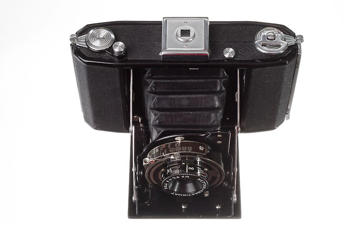

I have got a Zeiss Ikon folder in absoute mint condition (stunning, like new) and i am trying to find out its age. The model is Nettar 515/16, it has a Nettar-Anastigmat 1:6,3 F=7,5cm lens in a ACG Telma shutter with shutterspeeds from 1/25 to 1/125 plus T and B. There is also a serial number, K 318 on the side of the back that do not lead me anywhere.
The model and the lens/shutter combination seem to be a bit conflicting, the lens/shutter suggest it is quite a bit older than what i have found about the model.

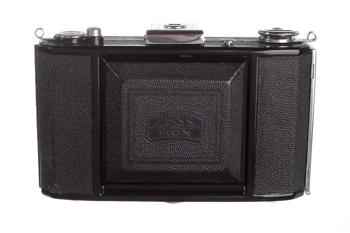

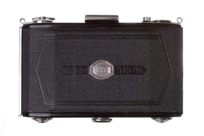

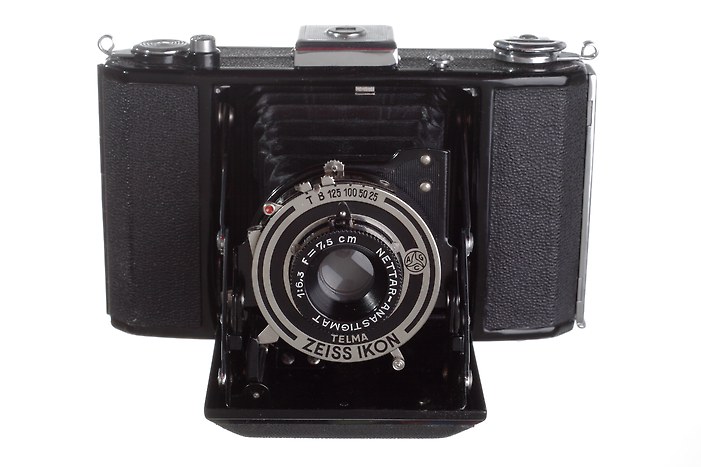

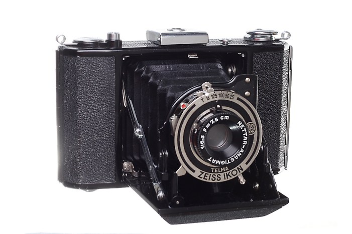

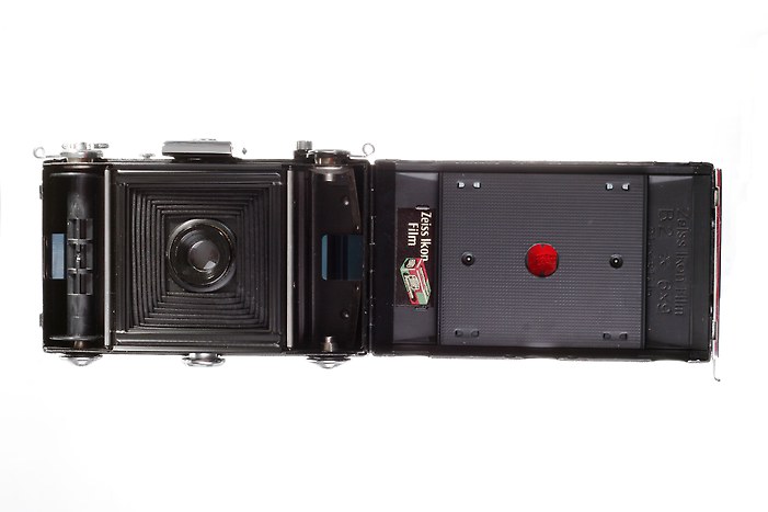

Here is a picture of it.

Andy38
Aug 16, 2008
242
Lyon , Franc
Wow!!!
As you said, it's like new ! It looks like never open before.
And it makes nice pictures.
I have a Nettar 515/2 (6X9) with that sort of viewfinder; it's also a pre-war (letter G : 1938).
elekm
Sep 12, 2004
2,055
New Jersey (
I agree with the date. It's definitely prewar because of the use of the Telma shutter. It's not one of the earliest models, because of the shiny chrome pop-up viewfinder, the shutter release on the top deck and the sliding door over the frame window.
This is in excellent condition. I generally am skeptical of claims of "mint," but this one is as close to mint that I've seen. In any case, it's in excellent condition.
