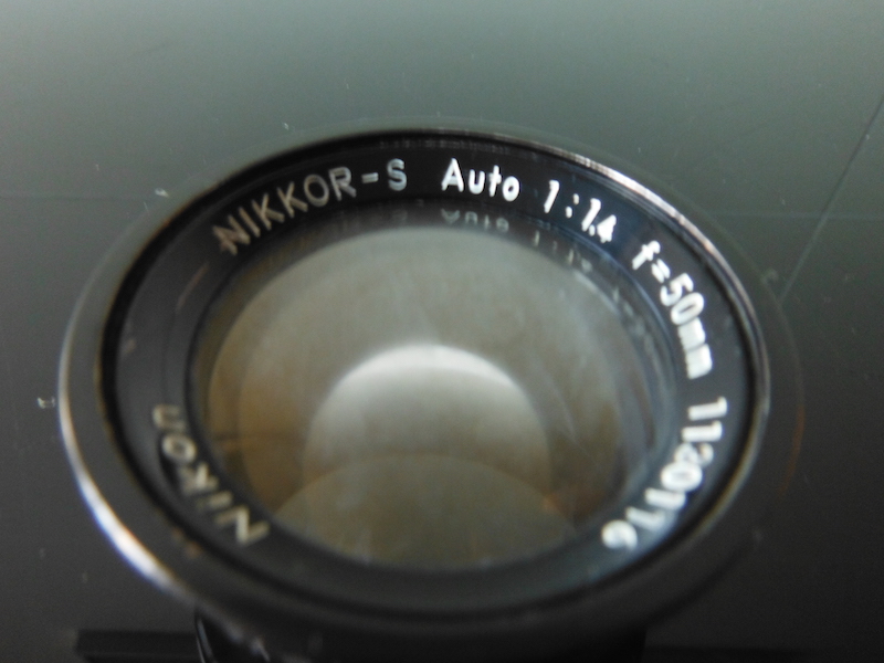

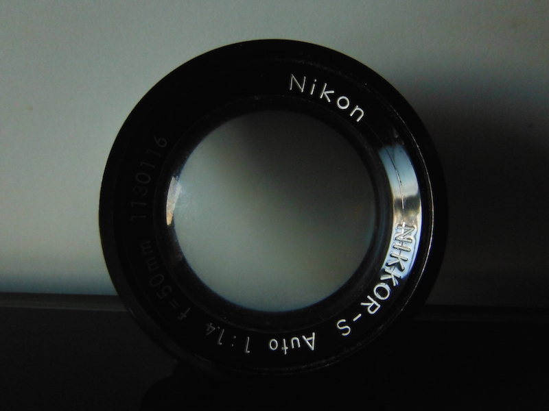

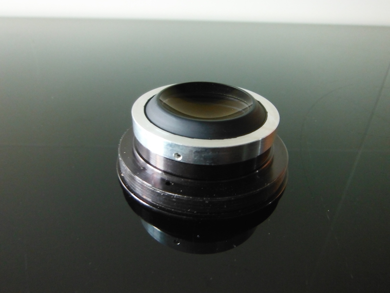

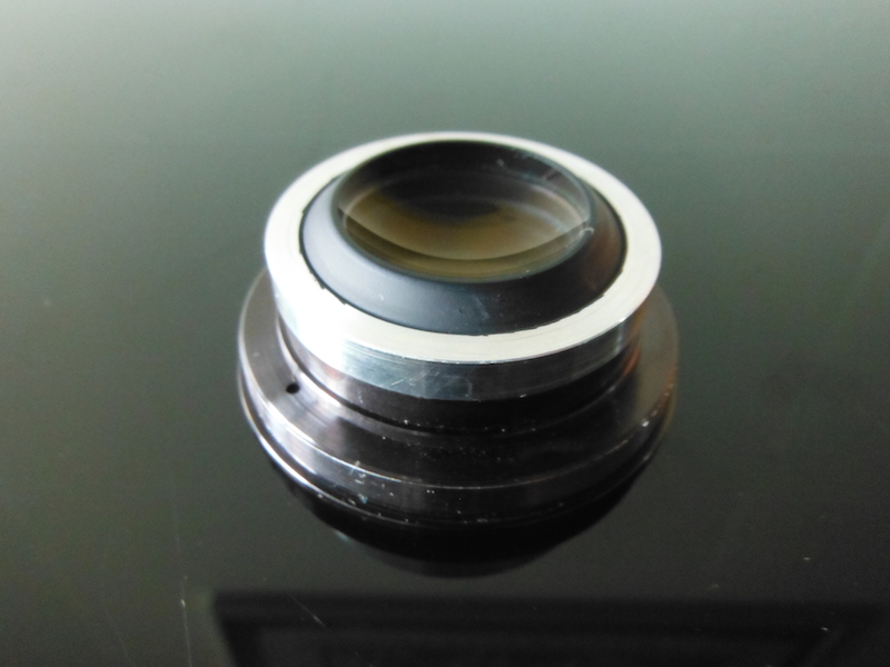

Hello all, I got a Nikon F with a Nikkor-S lens that has the front element with haze.
I was able to de-attach de front element from the lens body but I don't have access to the front element interior and I am not seeing how the sealing mechanism works to disassemble the rest to access the front element.
The procedure is different that I found on some forums, I just easy unscrew the front element of the lens ...
Can anyone provides some hints?
Regards

You have to unscrew the black ring with lettering on it from the lens cell. Use a rubber disk or similar (like a bathtub drain plug) of suitable size to "grab" the ring with friction.
