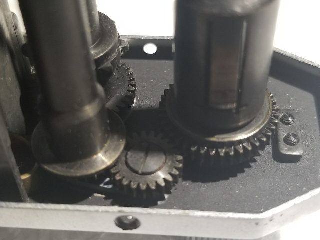

I finally was able to disassemble my Canon rangefinder.
However I am at a loss as to where the ratchet mechanism is or is supposed to be.
This is a knob wind rangefinder Canon iid.
The knob will wind and stop but it will turn backwards and that is bad.
Hello me please!
darinwc
darinwc
Dec 14, 2003
3,153
Sacramento,
Ahha! So it is not a ratcheting device like I was thinking. It is a coiled spring tapped around the main shaft (in the picture the one on the right).
They're is a collar around the spring with a notch cut in it. The spring exits through this notch and attached to the little bar with two screws (far right).
The advance knob holds the shaft in place and I think someone had not reassembled it back together correctly. I had noticed it was loose. Because it was loose, the collar that held the spring in place had a gap, and the strong had worked out of the collar.
It was a pain to get it all back into place but it is done. The mechanism is now smooth as silk and I am putting the camera back together. Yay!
