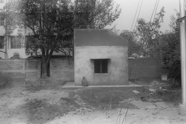

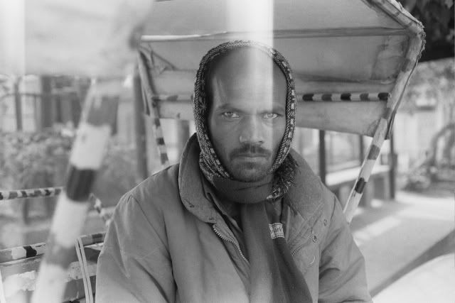

Hi, after shooting a bit with an Olympus 35RC I couldn't resist a Konica Auto S3 on ebay. When I got it, the meter was dead and the seals needed replacing. Had that fixed and shot my first colour film. Camera handled well and I liked the results. I went to India over Christmas and took the old Konica with me. I shot b&w 400, took great pleasure in walking around, watching people and snapping a few frames.
But it seems like the Konica has a light leak... a bright band running down the frame, usually to the left, but sometimes in the middle. I shot two films and both were affected.
The light in India was pretty strong but not sunny (cloud cover most of the time) but I felt the photos were a bit washed out, and of course, ruined by the streak of light.
Does this look like bad seals or something more sinister? The olympus and konica tc have been absolutely fine but I really like using the S3 and would like to get it fixed.

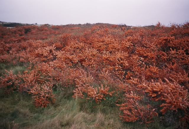

The colour photos seem just fine...

The Konica has a leaf-shutter, not a focal-plane one. A light-leak in the shutter (it closes not propperly) would show up as a white dot in the middle of the frame.

Check the light seal around the back if they're the least bit sticky or gummy replace them.

I'm shooting from the hip here, but the streak does resemble one that plagued my OM4Ti. Well, I thought it was a flaw in the camera. What it was though was light coming in through the eyepiece and somehow reaching the film!
This occurred only when I made long exposures while I stood aside tripping the shutter with a long cable. In your case, could the culprit have been India's very strong light? I wonder.

I don't think the camera is the common denominator here, since the color film is fine.
The common denominator is black & white film. Where does the process differ between color and b&w. In developing the film.
So, it's a problem somewhere in the process of processing the film:
1. It's a problem from when you load the film onto the film reels, or
2. It's a problem with the tank, or
3. It's a problem with how the film is processed.
Analyze these three, and I'm sure you'll find your answer. I would start by checking how you load your film and see if there are any light leaks in that process. Then if that doesn't help I'd try a different tank. If that still doesn't help - let someone else brain storm. :smile:
