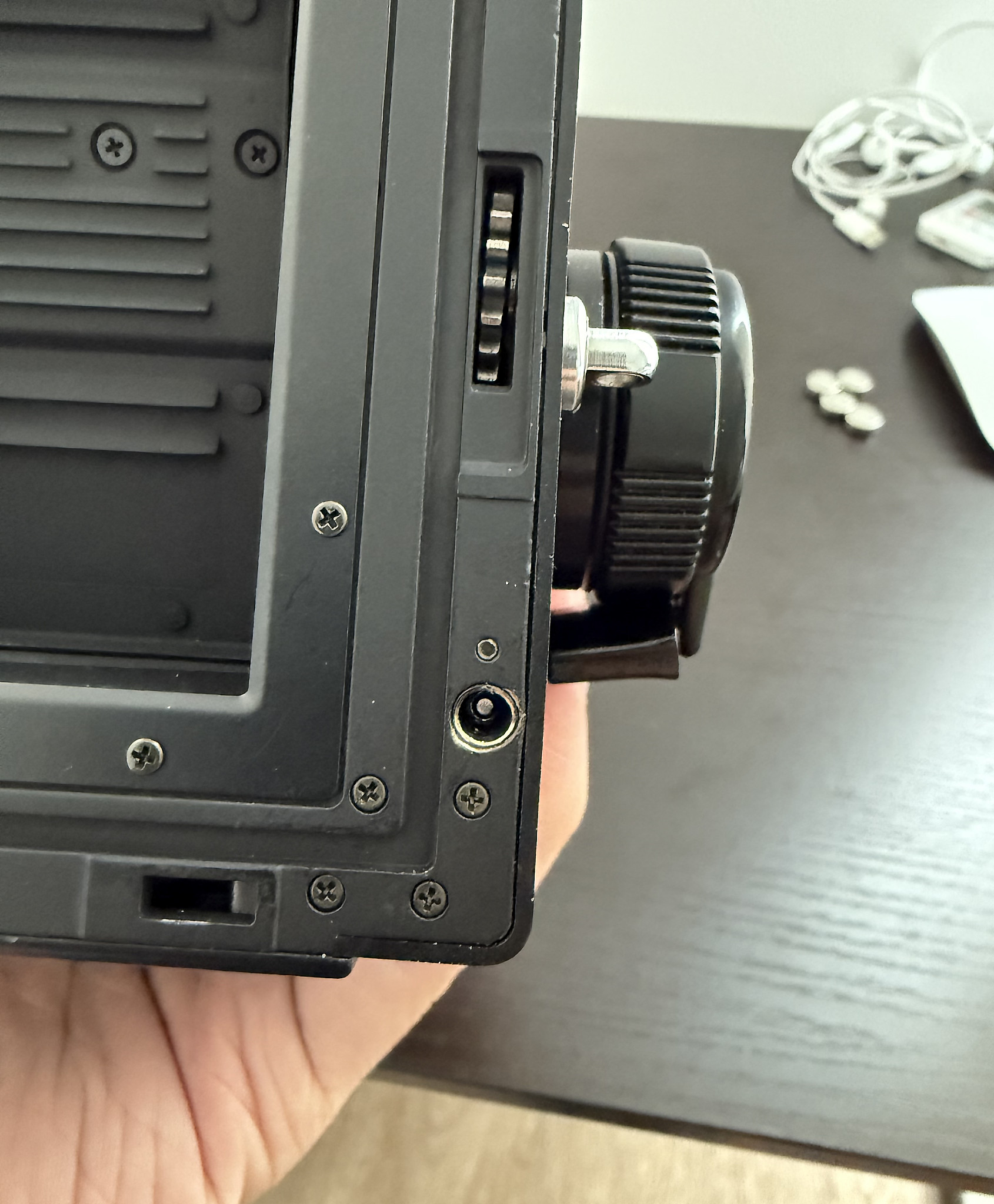

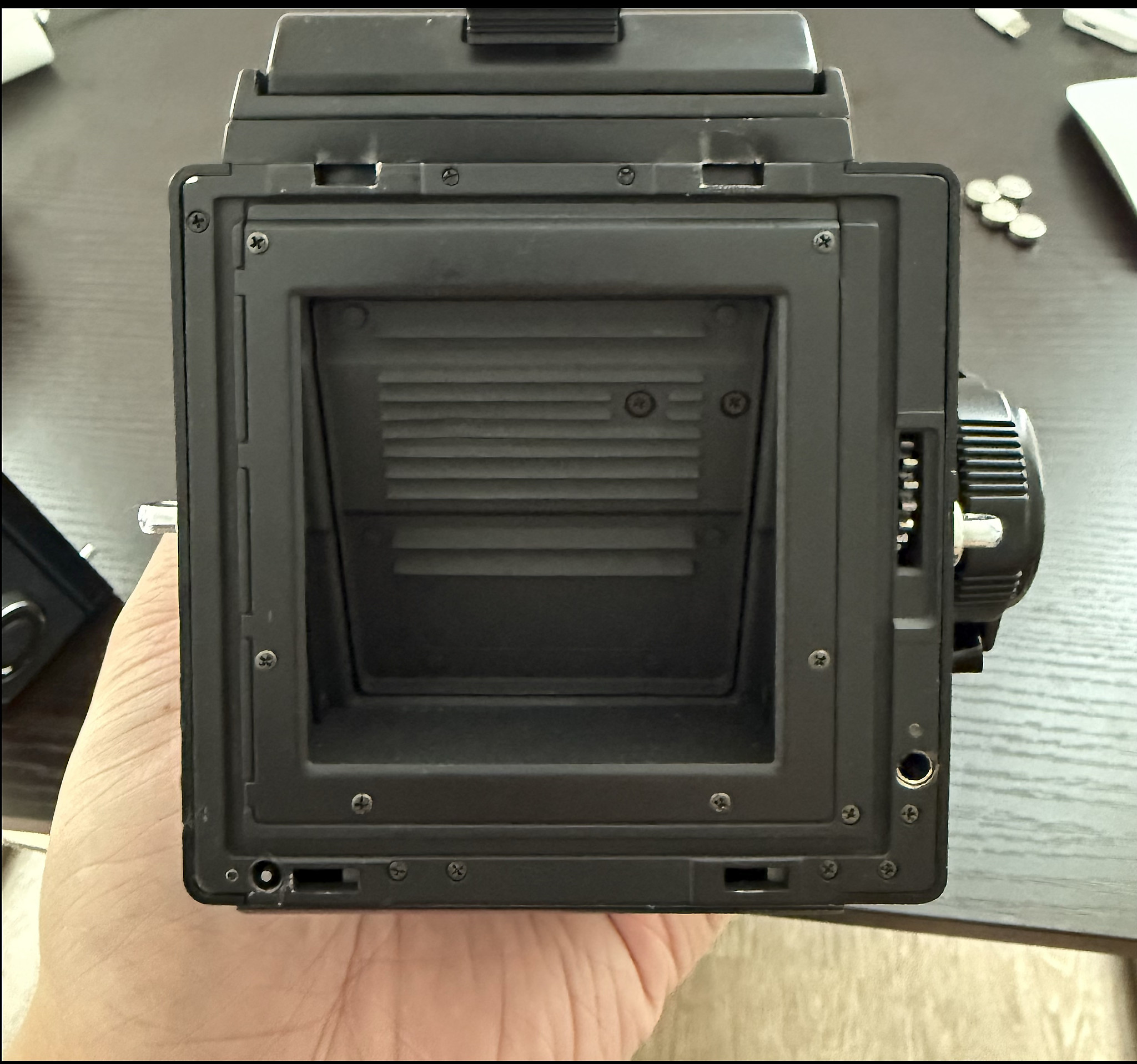

Besides, I would like to mention an unusual thing (see image attached): the pin on the lower right of the body (the one I just mentioned) seems to be stuck in the body. When I press it, I would say there is little to none movement actually. However, if I press it for a while, I can still hear a faint clicking sound.
Parts of this are normal and parts not. With the body and lens, but no back, fire the shutter. Now the mirror is up and lens is closed. In single exposure mode, the first turn of the wind knob should lower the mirror and cock the shutter (lens re-opens). However, the knob will keep turning, and you can't fire the shutter. That is normal behavior. If you switch to multi-exposure and wind a bit, the knob should hit a stop, and you can now fire the shutter. That's also normal.
Keep in mind that the shutter is cocked the moment the lens is opened. This happens at the beginning of the wind cycle.
While doing this testing in multi exposure mode, the pin on the bottom right should be recessed into the body by a few mm. When you fire the shutter, you should see it shoot out to be almost flush with the body and then retract. This is what pokes the back pin to release the back and let it wind to the next frame. If you flip the multi lever between single and multi, you should see the body pin move in and out.
It seems likely that your suspicion that the problem is related to the interlock of the body and back pins is on the right track. However I think you might be diagnosing it as "shutter doesn't cock in single exposure mode" when actually the shutter is cocking, but you can't fire it in single exp mode because the camera has not hit the wind stop (it doesn't stop because it is not getting the signal that the back is wound).
