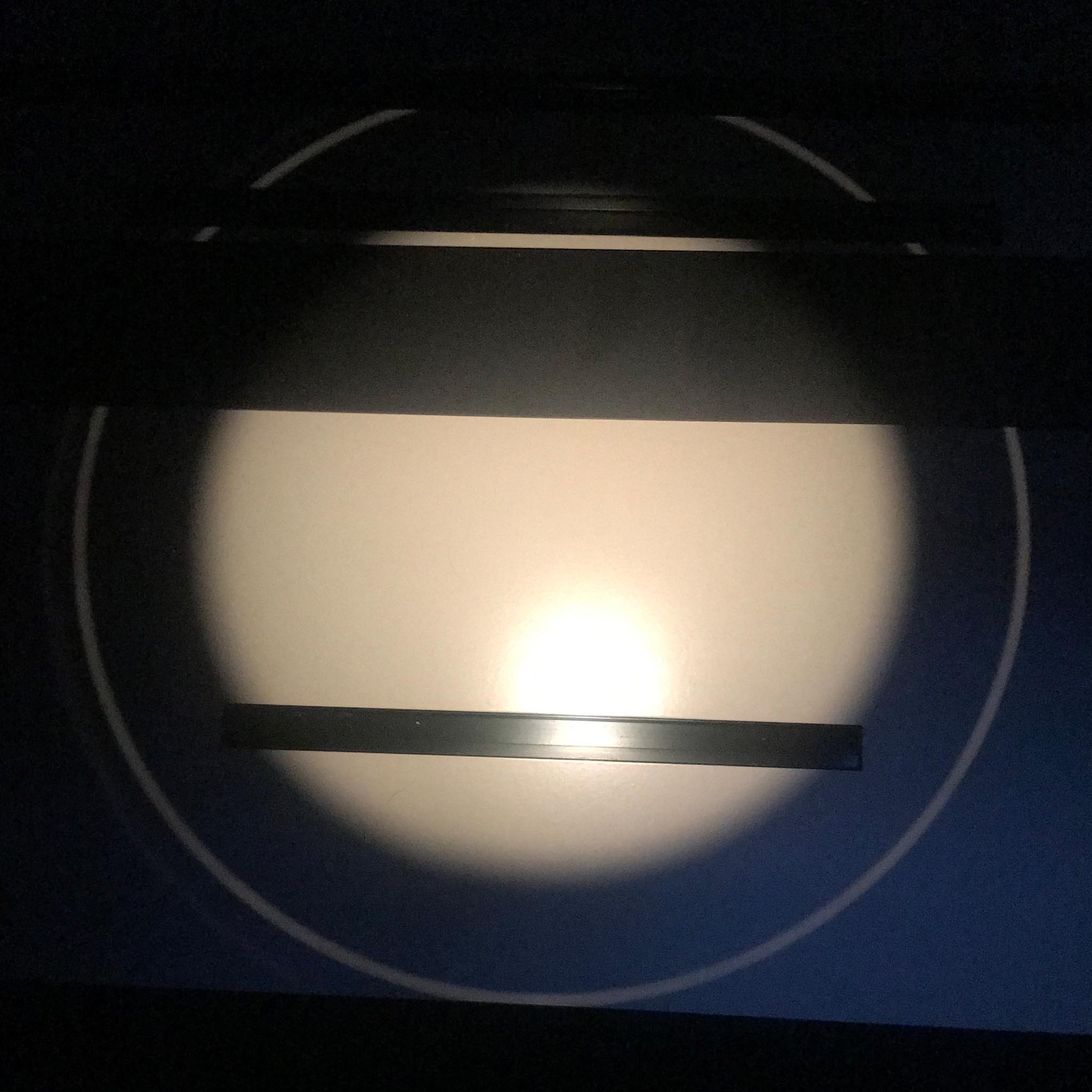

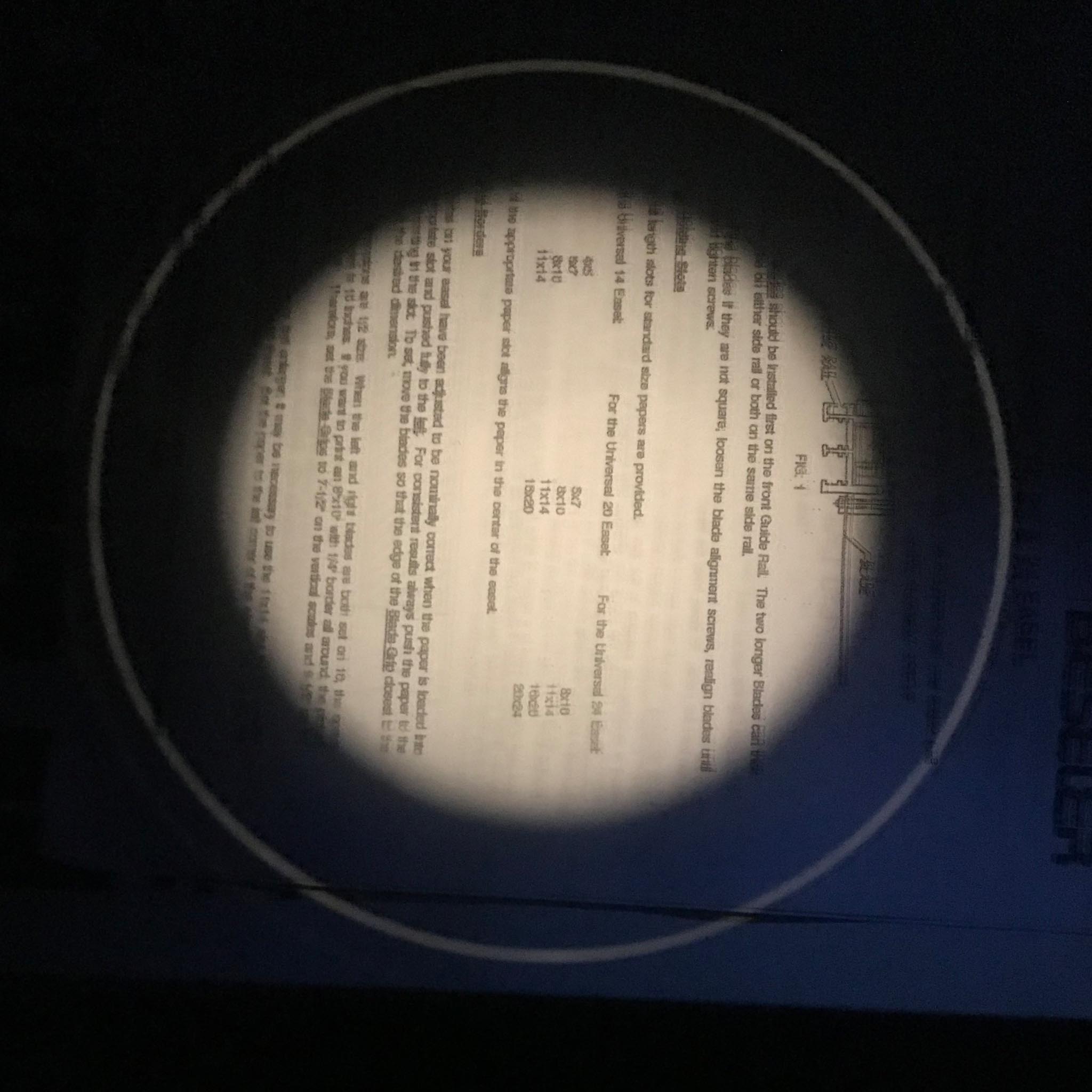

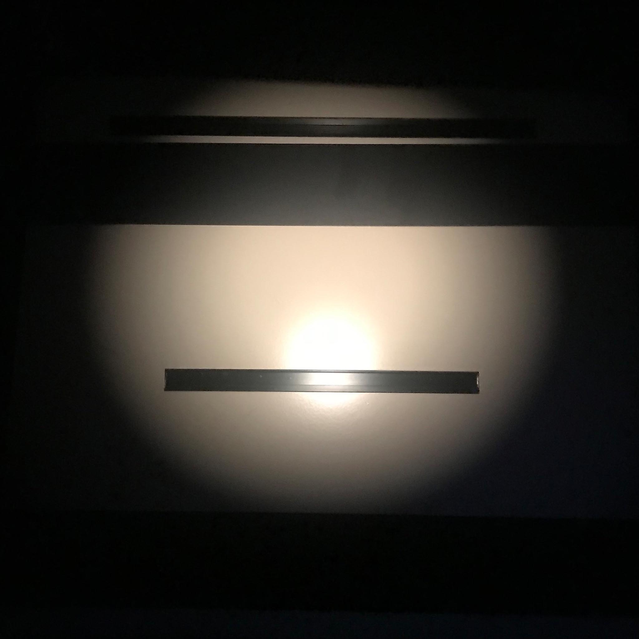

Hi all,
I've been lurking on here for a long while and this is my first post. I just picked up a used Beseler 23C-II enlarger; that appeared to be in great shape, and a couple of lenses for it, a Fujinon-EX 90mm F5.6 for doing 6x6 and a SK Componon 50mm F4 for doing 35mm.
The issue I'm having is that with the lens board and a lens in the enlarger I'm getting this bright secondary ring of light around the main area like a halo. It happens with both lenses, and I can almost make the halo meet the main light area by adjusting the condenser adjustment all the way down but it never fully goes away. Adjusting the focus doesn't change anything. See the pictures below, Ive also included a close up of the lighting area without a lens in the lens board and it seems like the halo isn't there.
I've been going to a local darkroom to do my printing and I've never seen an enlarger do this even before adjusting the condenser to meet the negative size I'm planning to print. I've inspected for light leaks around the board or the lens, I've looked inside the condenser housing and I didn't notice anything majorly wrong (I don't know what I don't know of course). What could this be? and How can I fix it?
Thanks so much,
Matt

It's probably light escaping around the edge of the condenser (or diffuser).
It will have no influence and should be solved when the negative holder is in place.

The Beseler 23C, CII, and CIII with condenser heads project a circular pattern. The projection of the thin band is cut off by the negative carrier to give a reasonably uniform illumination. So long as you use the correct lens, negative carrier, and condenser distance for the given format, you should have a uniformly illuminated projection
I find that my 23CII enlargers with condenser unit installed require “fine-tuning” the condenser position for uniformity. After I’ve installed the lens and set the condenser height to the format in use, but without a negative in the carrier, I project white light onto the focusing sheet. Then I adjust the condenser unit up and down until I see the most uniform illumination.
Sometimes best uniformity happens with the format indicator at, or close to, the indicated format. In other cases, the format indicator must be set somewhat higher or lower than indicated. Then I install the negative, focus and stop down the lens aperture by one or two stops to reduce the radial light falloff that always occurs with the aperture wide open.
The weak, thin circular band of light that I see in the photos 1, 2, and 3 of post #1 should be well outside of the image area of the projection with the negative installed in its carrier and the correct lens installed. Thus, the thin ring as shown is of no consequence.

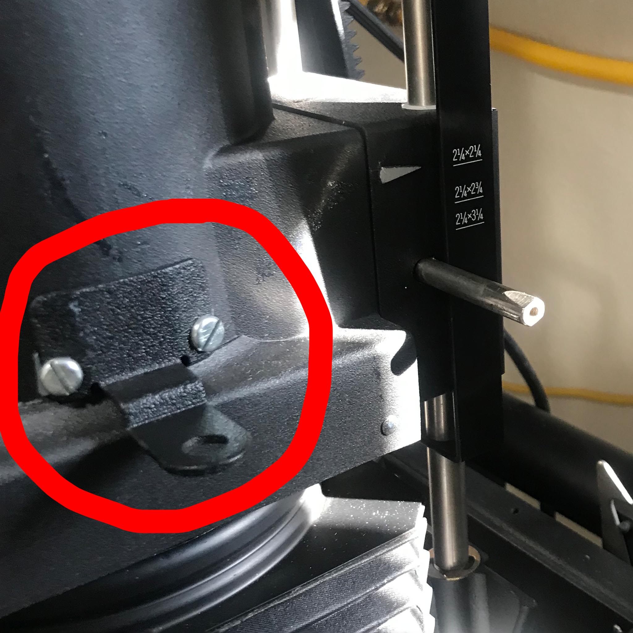

Once again good point! Maybe I will take a closer look inside the housing and make sure the condenser stage is 100% in order. I did notice when giving the exploded diagram another look the other night that my condenser housing seems to have two metal tabs with a hole through them one on each side of the housing, that aren't in the diagram. I don't know what those could be for or if they're interacting with the condenser in problematic way yet. See photo here ... maybe these are one of those odd previous owner things haha

One on each side. They might be there to attach the light source to something else. I have no idea. It's been a long time since I used a 23C -- and there are different versions. That might make a difference. I hope some 23C experts solve this puzzle.

Those are the mounting brackets and screws for attaching a dichroic color head. They’re shown as items 3 and 4 of the first photo in the following link to the manual:
http://www.jollinger.com/photo/cam-coll/manuals/enlargers/beseler/Beseler_DualDichro23_head.pdf
They were included with the color head.
Thank you! This is super helpful!
I was wondering if it had had the color head on it in the past because it did have the shaft extension on the condenser knob.
Now I'm wondering if maybe my extra ring of light is the result of something being re-assembled incorrectly when that head was taken back off. Looks like Im definitely gonna be opening that head to check.
