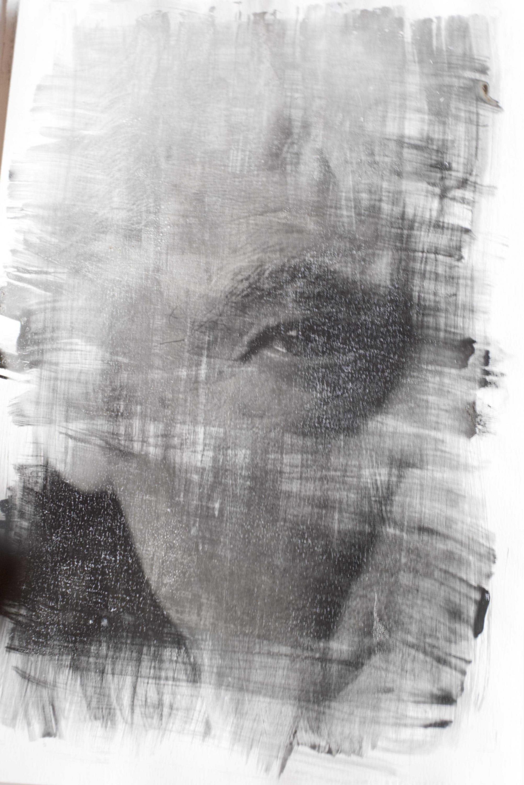

check this images one has been made with liquid light the other one with black magic. The same dark room the same light. Should be something wrong in my steps i can't believe that different suppliers deliver the same expired or exposed product
I can see only one image which I think is the one that has worked

First: I see two problems here: your coating technique can probably use a bit of improvement. I have used brushes too, but gotten better results. See the example below of Black Magic VC. I think you need to apply at least two or three coatings, to get a relatively even one. Besides that, keep in mind like someone else already posted, that BM needs a RED(!) safelight (and yes, it is necessary, I have tested another color too, and it was sensitive to a standard Ilford Orange / Brown safelight), so get a red one if you don't have one.
I don't think your image is really "black", I still see an image displayed, albeit faint (an eye, and the lower left jaw is still just visible), I think you need to work out the exposure better. Anyway, I don't think the water temperature should be the major issue, but if in doubt, measure it. It should be around 50-60 for melting the emulsion. I don't know what happens to emulsion if you have boiling water, but you said you waited for 10 minutes, so I think it might be OK.

1. I'm sorry but the light is really red. IT's professional dark room in the photography academy.
2. I coated 3 layers - the reason of this image is not so coated well is only that it's not a paper but board. Than on the paper i've got only black without any white on it at all. So i can't show it because i throw that away.
3. Yes my brushing is not so good as i did it first time in y life.
