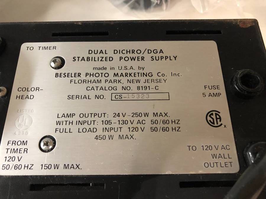

Hi, I am trying to decide if I should buy this colorhead, but the Stabilized Power Supply is missing the fuse holder. If you look at the picture of the power supply back panel. You will notice a hole in the upper right. That is where the fuse goes. It's missing the fuse cap. The cap holds the fuse and then makes contact when you screw the fuse cap on. Is this something that is fixable? Should I just buy the colorhead and try to find a part for it? Do I even need the Stabilized Power Supply ?

Should be able to pick up the cap at any hardware store. Whether the head works or not is another question?

Like Erik said- the fuse holder should be easy to get, even if you have to run one externally. IIRC, the cable from the power supply to the head is particular to the power supply and head. And I think the lamp is 82v or something like that so you can’t just plug it into the wall.

If you live in USA then you are in luck, the part should be easy to find.
Unlike this poor sole who lost the fuse holder cap on a (Italian-made) Durst and tried to find an exact match.

Ahh ok. I'm not the greatest with electrical stuff but I'll see what I can do. Thanks!

It’s a common part so should be no problem finding. Just google fuse holder and youll find it. As to cost that is up to you if it’s worth it. Complete enlargers go from free to very expensive but if you want it offer a price you’re happy with and go on to printing.

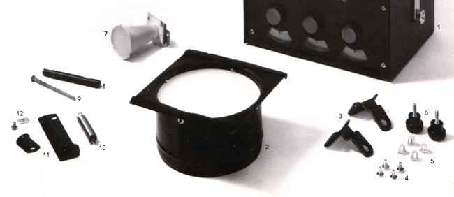

Third, there is some hardware that may be missing, though not absolutely essential. I don't see the holddown brackets in the photo. Also, and more importantly, there should be an extension for the condenser stage shaft.
