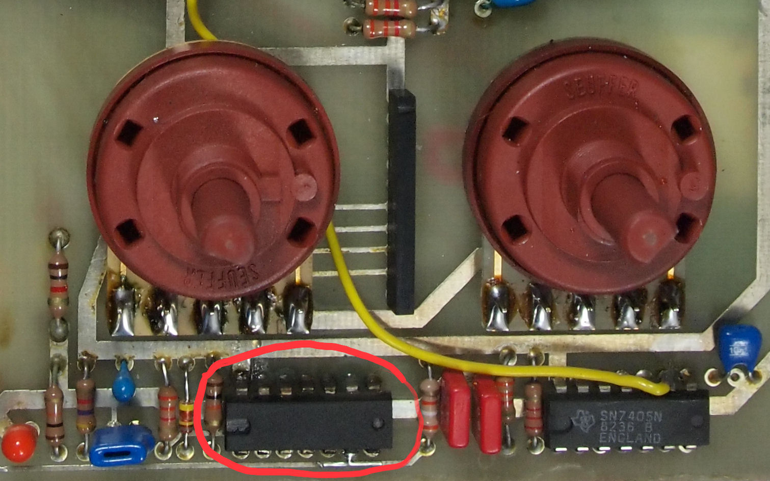

But one Integrated Circuit give me a big problem, the reference is completely faded out. And I know it's a part of the CPU reset circuit.

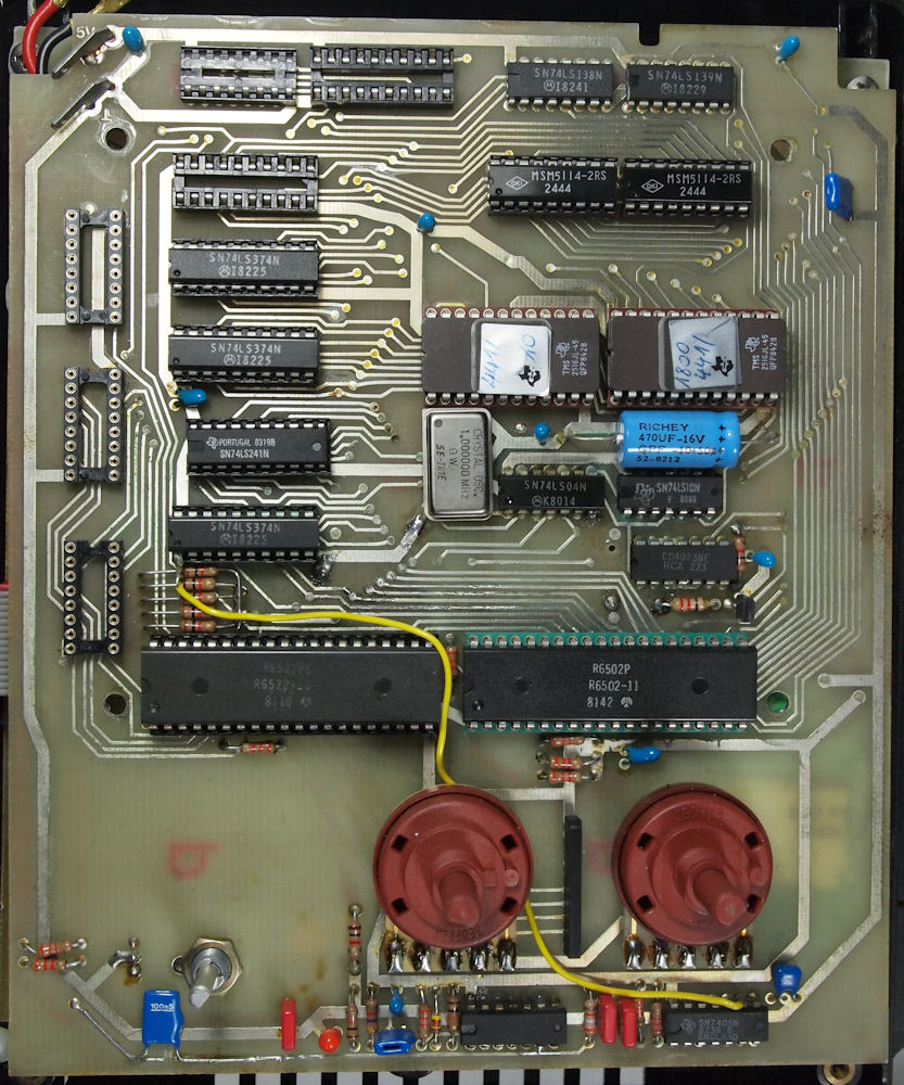

Is any of you has ever seen this circuit board, and have one within eyes reach, or have any schematics, it would be nice if you can tell me what reference is printed on top. I suspect the Jobo ATL2 use the same CPU card with some minor changes, and I don't think the reset circuit should be very different.
Here is two snapshots of the CPU circuit board. The culprit is circled red on the close up. Given the capacitors/resistors couple connected, I suspect this is a kind of monostable multivibrator circuit, to take down the RST signal the required number of CPU cycle, but any hint would be greatly appreciated.

Is there any reason you have isolated this IC as the source of the problem?
I recognize it's an assumption, but I cleared many other causes, like clumsy lyra IC sockets, for example (changed with new better sockets).
And if I can fall in electronic lingo, the CPU /RST signal is driven by this IC, through the two open-collector inverter gates of the 7405 you see in the second photo. And another hint to me is the faded away marking : overheating can conduces to such discoloration. And at last, I like to understand what I see : even if the source isn't here, an unmarked IC titillates my brain :wink:

Thanks to Omer of CatsLab (Krifartida), I got schematics for ATL2 head. But the design is a complete departure from ATL-1, and the reset circuit is totally different.
However, seeing the schematics put me on the way : the unknown IC is finally a NE556 (dual 555 in a 14 pins DIL package), connected in monostable multivibrator, as I suspected.
With this hint I was able to make enough tests to exonerate the reset circuit in the problem. It is somewhere else, I haven't found it where for the moment, but I am progressing.

Thanks for the information ! In fact, I already done this, is you look at the whole CPU board image above, you will see an empty place at the center : the PCB mounted NiCad battery was here. As it was dead when I got the processor, I unsoldered it and replaced it with a wireless home phone battery, of the same voltage, but with a different form factor, so I sticked it on the PCB other side.
Maybe it was a part of the problem anyway : the old battery leaked, and tracks and components pins around was obviously corroded. I thorougly cleaned the corroded areas and re-soldered some points.
For the moment, changing the NE556 eases the things well : the Jobo is up and running again. However, because it's a random problem, I am not sure to have completely solved it.
