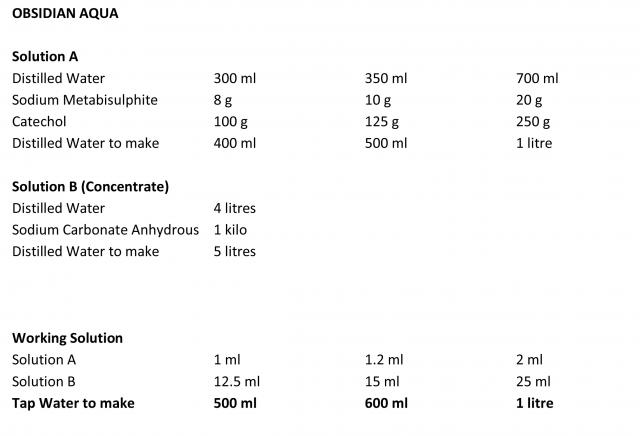

If so you could make your own to use as you describe. Have a look at OBSIDIAN AQUA. Very easy to make up. Economical to use (1ml of developer in 500 ml of tap water). It also happens to be a fantastic developer, preserving fine grain and delivering very sharp results. You can use it semi-stand and stand to take advantage of its compensating properties too.

Here's how I make up mine:

Mixing up developer is easy. 55 years ago, pocket money was in short supply, getting the chemicals and making your own was the only way to afford developer for some of us. I was nine when I made up my first developer. It was ID 11, which is the same as D 76...
