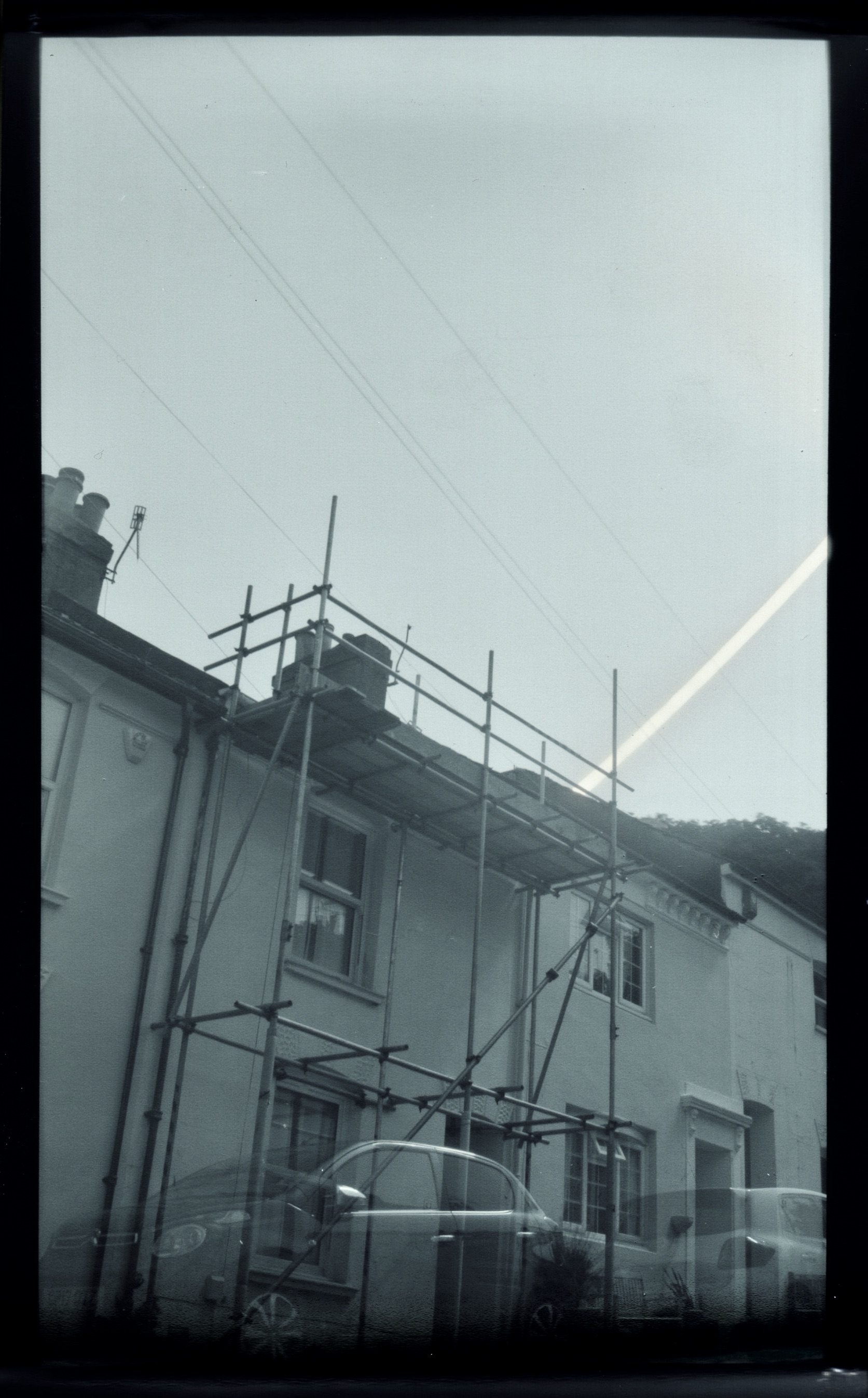

Here's a 6 hour exposure shot on a paper negative. If I went 1 stop down would I get (roughly) the same exposure result by exposing for 12 daylight hours? Likewise if I used, for example, a ND 4 filter would that mean would I get a similar result with 24 daylight hours?

Ok thanks, I think I get it; so the photo in my post was a six hour exposure, if I put an ND4 filter on the camera it would go down 4 stops which would give me 24 hours of (daylight) exposure [6hrs x 4?]
When your exposure is measured in "hours" (really, already from a few seconds), then the linear relationship between f-stop and shutter times is not valid any more. You can only get an approximate "good" exposure time by looking at the specs of the particular film you are trying to use (different films have a different "reciprocity failure" curve).
(Note, though, even ignoring the "reciprocity failure", that increasing the exposure time by 4 stops is *not* the same as increasing the time 4x: it's actually (2^4)x: 1 second becomes 16, 2 seconds become 32, 3 seconds become 48, etc....)
Thank you very much for your insight. I think this is going to be trial and error- something that I am quite used to (especially the errors...).
You are doing pretty good so far. That 6 hour image in your first post came out great.
Hello and welcome to the forum-happy experimenting!
