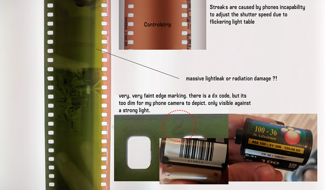

I added this visual representation of the whole mess
Facts first:
I´m not new to developing C-41 in Tetenal 3bath kits.
I do process control -> A 10cm strip of unexposed, fresh Kodak Gold in every Tank
Temperature was 38.1 to 37.8° C -> I checked a few times
Prerinse had a usual greenish color (I think that comes from the Kodak Gold)
Chemistry was fresh. It was the first film that had run through the chemistry.
Agitation was continuous and motorized
Ok, I should state here that the film I developed was about 20y old Ferrania FIlm (with 20y old latent images) my mom had found in a drawer (I already did a development of such old film with latent images successfully). As it turns out the film behaved completely different than I am used to.
The negatives are underdeveloped/ faint ->edge markings as well as the images itself
The negatives have no orange mask, but instead a very dense green/brown fog -> Is it fog? It´s definitely no error from too short blixing -> this was my first guess, so I blixed a second time for another 4 mins -> absolutely no change
Do you have any Idea what might have happened with the film ?
I´ll add photos of the negatives later when they´re dry enough to put them on a lighttable.

Here´s the negative and a graphic summary of the whole mess

Your "control strip" confirms that the processing was correct, and the canister says C-41 (which is correct for Ferrania/3m Imation film). I have also processed 20 y.o. film with quite usable results.
My own guess would therefore be poor storage (in a drawer....heat or dampness? ) and/or some kind of light fogging ? Radiation damage seems unlikely, although could a luminous clock dial affect film ? Or has the film been near X-rays at some time in its life ?
Aug 13, 2018
117
Bamberg
Light fogging seems reasonable, but must have happened in camera Back then. But one thing speaks against the fogging theory: the orange part of the negative that looks quite normal is NOT normal. Its Not developed at all, since there should also be edge markings visible, but there's nothing...

Those ideas of latent image degradation do not explain at all this artefact, as
-) the artefact is not homogeneous but got two edges
-) it affects areas that never got a latent image, as the lower rebate and the spaces between the images

I know, i know... fresh film... It just annoys the hell out of me that the images on this 20+ year old film are apparently one of the first photographs I took as a child, maybe 4-5 years old. If a lab had processed it I could at least (in thought) not in any material way blame them, but know I struggle with the thought of maybe having destroyed the first images I produced. Maybe the Noritsu is able to get something out of it.
Aug 13, 2018
117
Bamberg
Well, if I leave the issue of the latent image, but turn auto-fogging, how then is to explain the edge formings?
Apparently there was not development whatsoever in the orange part of the negative. the rips and tears in the emulsion were caused when I spooled the wet film back into the tank for another round of Blix.

Well, two faults... fogging and stepwise non-/under-development.
Makes sense.
BUT how can be explained that the test-strip was completely developed?
Aug 13, 2018
117
Bamberg
Makes sense.
that´s the issue! The chemicals were fresh, the process was ok, but yet the film did not develop properly. The test strip was developed properly because my process is ok. The problem must have been the film, and thats why i´m curious.
AgX
Apr 5, 2007
29,973
Germany
If the test strip was on the same reel, I rather fall back to my first explanation:
partial light fogging through the back
That would not explain why there is no signing at the true orange part of the rebate, but it could be that there was no signing exposed at that part or at that rebate at all.
