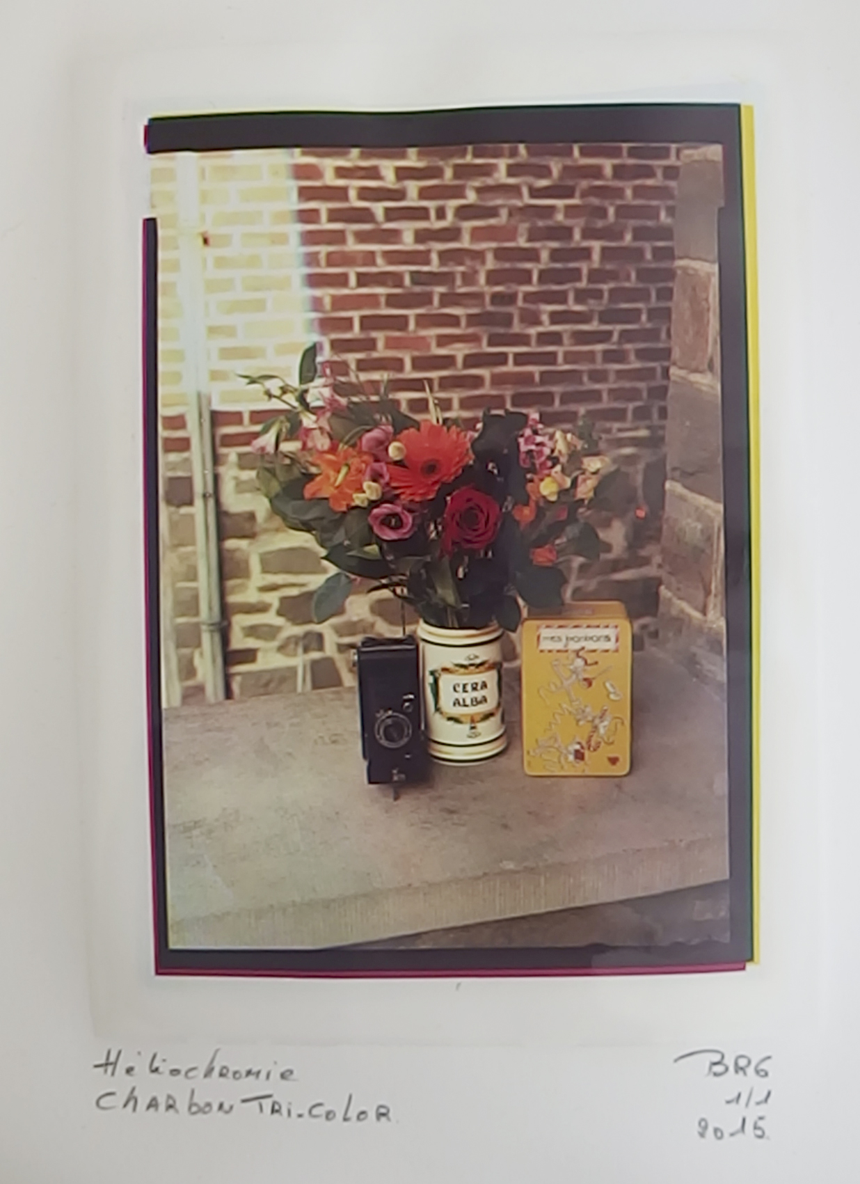

Hi,
I presnted my First Héliochromie Carbon Tri-Color with sheets argentic 5x7 inchesn Filter RGB with Double TRansfer on watercolour paper
You can see the process (sorry on french) on my website http://www.philippeberger.net
I prepare a Book on this Carbon Tri-Color Process
Philippe

Merci THank you
All is it all analog
Shen Hao Camera 5x7 inches, sheets Ilford HP5+ Filter Red 25, Green, 58, Blue 47
Carbon Tissue Magenta, Cyan and Yellow without Black
The Tri-Carbon on only one support
Carbon Double TRansfer on a water Color Paper

Oooh, isn't that pretty? Reminds me somewhat of the old Agfa colours from long ago. Very nice indeed. I've been thinking of doing some colour work again after over a decade away from it, so I will read your website to see what it says. My French is very, very bad, but I can figure it out after after some effort. Approprié que ce est une impression couleur tri. Merci de votre post. Laissez les bons temps rouler! (with google translate, now we can all be le petit persona français bidon :} )

Beautiful results!
