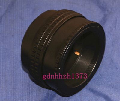

M65 and more rare M77 helicoids are the way to go. Quite precise. Lots of M65 kinds available on eBay.
17-35mm extension is the most common.
However, some attention needs to be paid to which one is purchased.
I had a good luck with ones advertised to be made out of brass and incorporated in working products (for helicoid surfaces, outside looks the same).
Brass version is well dampened and stays in place. Only fractionally more expensive. Aluminum helicoid versions have some play and they're not as smooth.
Disclaimer is that I didn't really try all of the available ones.
Scale would need to be DIY or 3d printed or laser etched. I do it 3d printed and it works quite well.
3d printing can be good or bad in quite a few aspects. Looks, functionality or durability. Material and the way it's done is very important.
I don't have a Horseman Convertible but have 80x80 Horseman and make lens boards for most other cameras with M65 thread for the M65 helicoid.
Provided that particular lens board can accommodate these thread sizes.
Also corresponding M65 threaded lens boards that mount into M65 helicoid.
That basically turns this assembly of lens board + M65 helicoid + M65 lens board into something like Linhof focusing device.
This way of doing it also enables moving the helicoid/lens assembly from one camera to another.

Thanks. I'll have to measure--M65 should be doable, but M77 might exceed the space.
Let me pick you brain a bit to make sure I understand what I'm buying. I searched ebay for "m65 helicoid" and got a bunch from $30 to about $60. I'll pick one just as an example:
This would require as M65 flange on my lens board and would mount an M65 (copal #3?) on the front. There didn't seem to be any with M25 (Copal #0) adapters, but that should be available somewhere.screw an adapter on the front, then the C0 shutter into that. The helicoid ranges from 25mm to 55mm. So, if hypothetically the distance from the front of the homemade lens board is 25mm from the film plane, then I need an approximately 55mm spacer between the helicoid and the board or the helicoid and the lens to get me to 105mm for infinity.
That all seems pretty doable. The lens board will be 3D printed. (I'm fine with 3D printing on stationary parts, its just moving parts where I get skeptical.) I've modeled and printed simple lens boards. This might get a bit more challenging, but still doable. I do wonder about getting exact and whether I need to plan for a way to shim the setup to get it accurate (fortunately Horseman made a ground glass that fits the back of the Convertible so with a tripod I should be able to dial it in as long as I'm not ordering 3D printed parts a dozen times as I adjust .3mm here ot there.)
A little googling found me this formula:
1/focal length = 1/Distance to subject(mm) + 1/Distance to film(mm)
So, with the item linked above I get:
1/105 = 1/x +1/(105+30) = 472.5mm or 18.6 inches as the MFD. Which is probably way closer than I'd trust a scale focused sports finder based camera. It looks like I'd only need 15mm of helicoid to get a 105mm lens focused to just under a meter (840mm) which would be fine.
Sorry for the brain dump. I'm just thinking this through. Tell me if I'm missing anything in my thought process. It seems like Horseman intended to make this a interchangable lens camera but never sold enough to justify building other lenses. I quite like its size and simplicity. With two other lenses this would be the perfect travel camera for me, so if I can make something happen, that would be great.

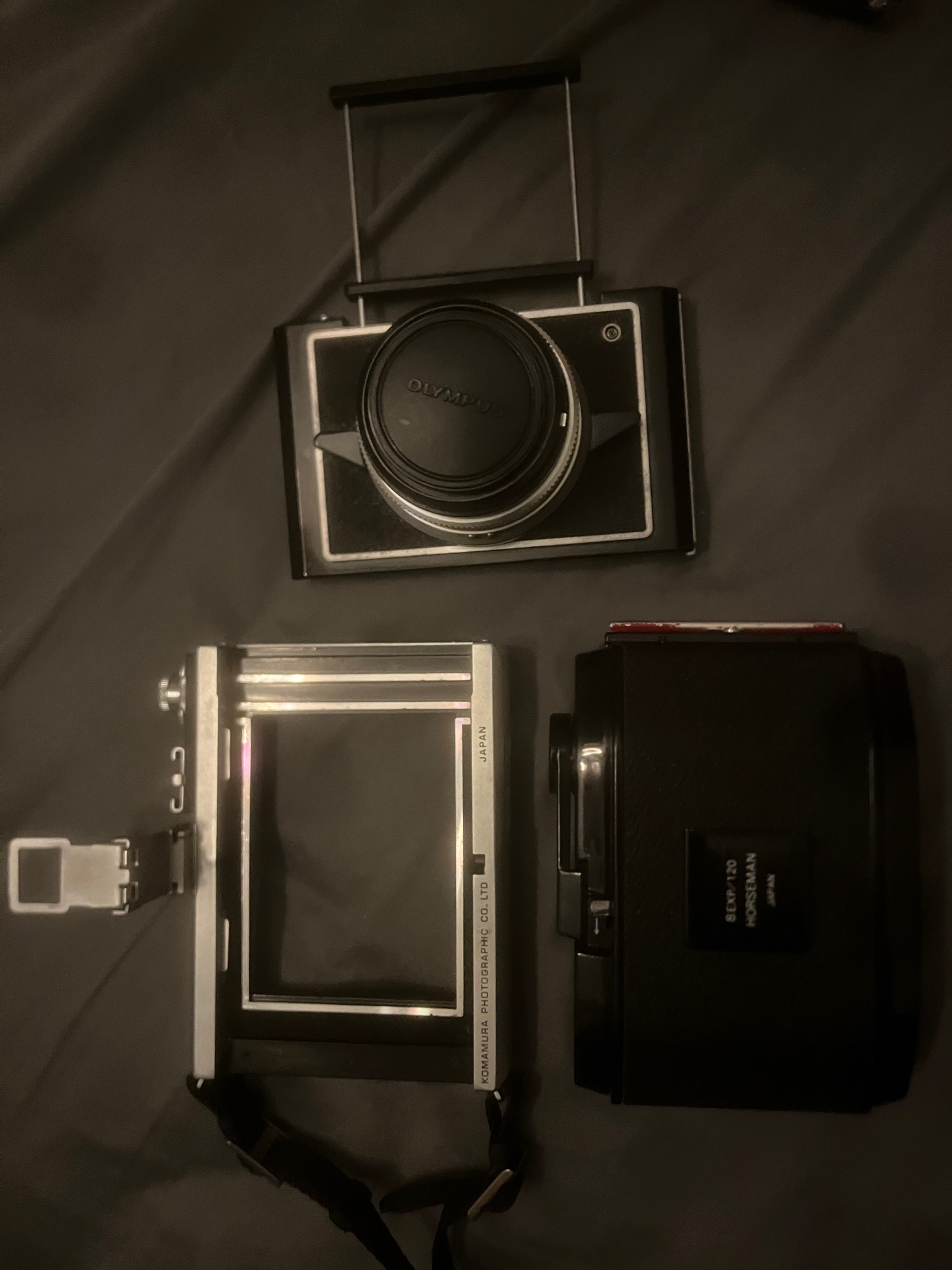

The Horseman Convertible is a weird camera that is, for all intents and purposes, just a rectangular piece of metal that mounts a 6x9 graflok film holder in the rear and a flat board with a lens in the front. They only ever made a single lens--a 62mm ƒ5.6 that is quite nice, IME. The board and lens are a single unit, so I'd need to take some measurements of my existing setup and model it, but that seems doable. I don't have or want a 3D printer so I outsource the printing to an online source.
Below is a photo of the camera disassembled. Top is the lens board with half of the sports finder extended. Bottom left is the camera itself with the other half of the sports finder, and bottom right is the film back. In my 3D modeled lens board I may try to build a pull out frame for the sports finder, but if that too complicated, a standard shoe mount view finder will work too.
I measured the distance fromtop to bottom of the silver rectangle on the lens board and thats a bit over 72mm so the M65 will fit but the flange may need to be trimmed.

Yes, That's the brass one. Shorter 17-31mm is perfect on 105mm lens. As you say it will focus closer than you can reliably zone focus.
Focusing helicoid is sized on the size of the rear cell. It needs to fit through the helicoid. Around 58mm is a safe size for M65 helicoid. Could squeeze in
I fully printed different focusing devices and modeled some helicoids but tiny variations in print quality would change the feel.
Most printers are better today but it's enough to have variation in filament that's only a couple of hundredths of a mm to change the dimension by that much and it's no longer the same feel you would want.
Material would have to have zero warping for this to be repeatable. At $20-30 it's not really worth 3d printing.
I can achieve it if it's one off in a few tries but making a quantity, it would be tough to equal machined one. In this case it's simply an issue with tolerance and amount of warping.
Plastics will usually have better damping characteristics if the whole system is designed the right way.
If you only make it a simple thread, it would be possible, lens would rotate though. There are some designs like that. If lens rotation isn't important to you, this is an option too.
It's the best to use the shortest possible helicoid as it could cause mechanical vignetting if the lens' rear cell is inset too far inside the helicoid.

39mm extension will likely cause vignetting. 3d printing a lens board with a cone that attaches directly to the helicoid is a solution for this.
Ideally, helicoid should be as shallow as possible.
