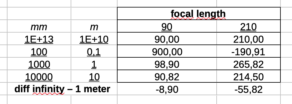

New calculations:
So 90mm lens would need approximately 9mm of helical movement and 210mm would need 55mm movement.
