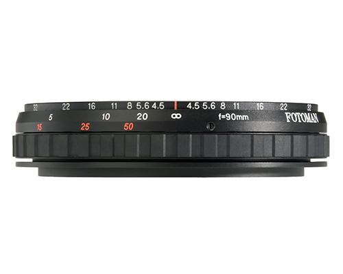

fotoman
Apr 7, 2006
55
Houston, Tex
Med. Format Pan
Fotoman Camera sells a complete range of Helical Focus Mounts, available to accept either #0 or #1 shutter sizes. A 65mm is available with proper DOF scale. www.fotomancamera.com
