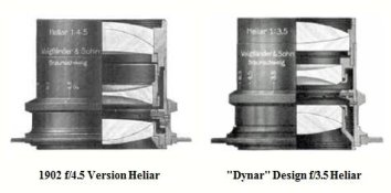

I've heard great things about the Heliar on the Bessa RF/II, Medalist I/II, Mamiya Sekor 105, etc. and digging deeper it seems that it is very popular for its bokeh. I love smooth bokeh and I feel GAS coming up so if you forget the ergonomics of the respective cameras, how would you compare quality of the images that the Heliar produces with respect to the more common planar- and tessar- types on the TLR's and Folders.

I have one Heliar, on a 9x12 Voigtlaender Bergheil, and it's an absolutely ridiculously sharp lens, maybe sharper than the Planar on my Rolleiflex and certainly far, far above anything else I own. Not sure how much this reflects the lens design generally as opposed to an exceptional sample.
Bokeh is so subjective that it's difficult to know what to say about it---I know I like what I'm seeing from the Heliar, but I can't really explain it in any halfway sensible way. Images at http://www.flickr.com/photos/ntenny/tags/bergheil/ if you want to see some examples. I particularly like the one with the milk can.

As you can tell by my Avatar I do like Heliars! I have an uncoated 150mm and a coated 210mm that I use on my Linhof, both give a sharp but smooth image that I really like. Always a hard thing to explain, but it is there, and the build quality on the 210 is just amazing. Only problem is the lens is just a barrell at the moment, which restricts it's use a lot. When I get better healed I will send this one off to S.K. Grimes for a shutter as it is my favourite 5x4 lens and dserves to be used much more.
