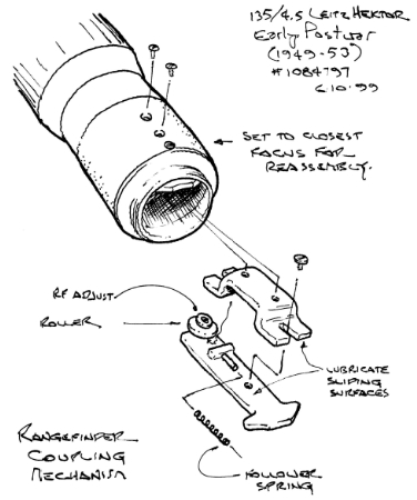

If I remember correctly the 135mm Hektor is one of the Leica LTM lenses that is incompatible with Zorki, Fed etc... this has something to do with the different forms of the RF tab on the Russian cameras and Leicas.
georg16nik
Aug 3, 2010
1,101
Your issue is caused by the Zorki RF cam design and might need tweaking to make it work - if possible at all.
On Leica the RF cam is a roller, a more complex and elegant design compared to FED and Zorki.
attached pics from jay.fedka.com & rangefinderforum.com
attachment.php
attachment.php
attachment.php

For sake of a researcher , I communicated with Georg and he says screwing error caused by camera rangefinder cam.

Note if your Hector has a rangefinder tongue as the diagram earlier there is risk to damage to any of the FSU rangefinders the soviet lenses all have flat cylinders which won't interfere ie damage the rangefinder follower. Not all LTM lenses are compatible with all LTM bodies.

I talked with Georg and decided to remove the cam , there is a plastic piece holds the cam at its place with a screw and I found it is difficult to remove the screw without screwdriver and a knife could damage the curtain. Tomorrow I will go to watch repairman and he will do it.
Xmas , seller tried the lens on m3 with adapter and there is no error , zorki cam is responsible for wrong measure and unfinished rotation.
