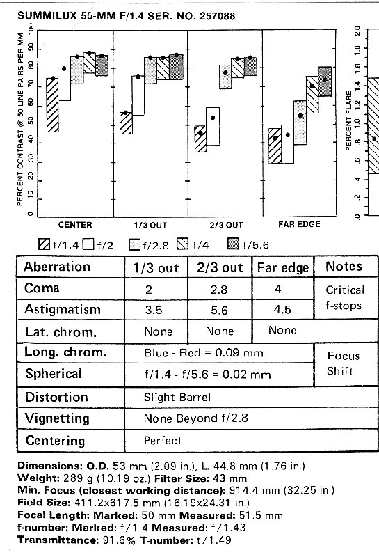

I thought the only reason to own a Leica body was to mount Leica lenses. Tests I have seen show improved contrast of Leica lenses over other 1970s lenses.
