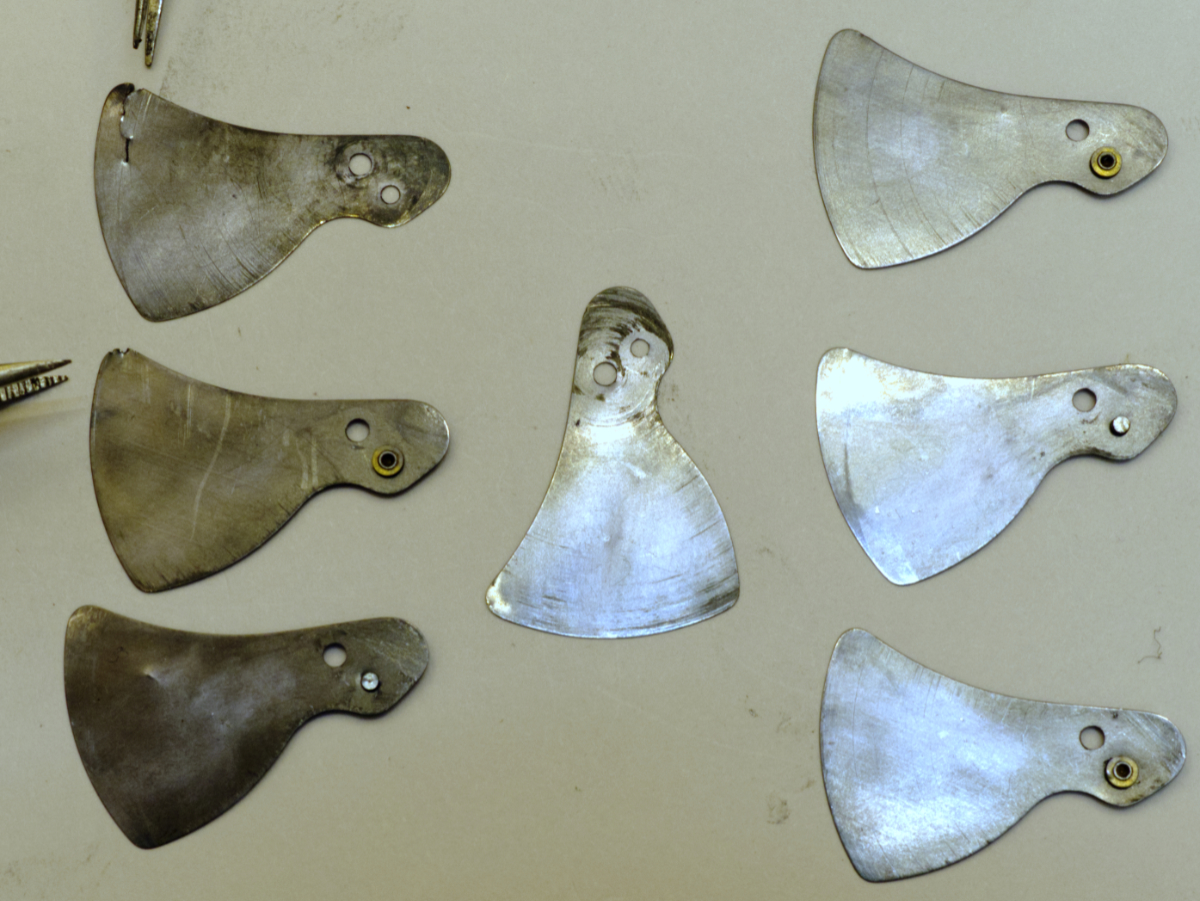

I wonder what experiences people have had with high heat affecting mechanical camera operation. I recently got back in a camera where someone said that it worked fine in 'regular' temperatures- 70-80F/20-25C. But in recent shooting above 90F/33C, he had many blank frames as if the shutter didn't fire.
This is a Kodak Medalist where the shutter release mechanism and the wind release mechanism are separate, and both make a distinct click. So it is recurring problem with unadjusted Medalists to get blank frames as people hear a click but it was only the wind releasing, not the shutter.
When I got the camera in, everything was fine. Shutter release and wind release synced, shutter fired smoothly, etc. I was wondering, then remembered the heat issue. So I put the camera in a box and sat it out in my natural outdoor sauna in the low 90s. After an hour, I noticed the shutter jittering during cocking and exposing one tip that was torn. And then it didn't fire a few times. I didn't experience the wind and shutter release going out of sync.
Attached is a photo of the shutter blades. As you can see, one rather torn tip. And one well-dented tip. I assume that this is the cause of the problems. Not sure if the blades simply failed over time, if I nicked them in re-assembly, or what. And then they ate each other up more in use?
Anyway, the real question is what have people noticed in equipment failures or changed operation in higher heats? Any equipment destruction? Or do you think that heat simply makes more obvious some existing conditions? And any approaches to preparing a camera for temperatures in the 90/33 plus range? Less lube. different lubes? I know that there are low temp greases out there.

This shutter blades are a mess. YIKES. They sure did seem to eat each other up. I've never seen shutter blades fail due to too much or too little lubricant, not temperature. Something else must be going on to cause you that grief.

Metal fatigue and hairline fractures that are relatively stable at lower temperatures could cause the blades to expand in uneven patterns and set up interference where none existed before.
The Medalist is a fairly senior camera and was largely produced in the WWII and the immediate Post WWII era, so who's to say if some of those shutter blades weren't entirely up to specification when produced?

Thanks ofr the thoughts and experiences with heat. I am not certain if the blank frames in the heat was becasue of the torn shutter blades, or if at the same time another part of the Medalist had expanded out of range. The Medalist is a bit of an crude camera, with lots of sliding connections without secure gearing and such. A leica, e.g., is full of meshed gears and such kepping mechnisms. So I could see something right on the edge of operability going out of range under the right expansion or contraction. Or maybe it was all the luck of the draw and the camera was going to fail at that point in its life no matter!
Attached is a photo of the shutter blades. And then they ate each other up more in use?
It looks to me as if the blades, especially the one in the left upper corner, were damaged by someone who repaired the shutter long ago.

Forest Bagger, you are probably right. I know that I didn't install a blade as torn on these, but as I said I may have nicked one or both, and then the pressures of opening and closing added more and more damage. Or maybe a subtle bend, etc. Or yes, someone else before me. I've seen rivets break on shutter blades for no good reason, and I expect that any blade can be damaged in ways that take time to become as obvious as the blades I have here.
