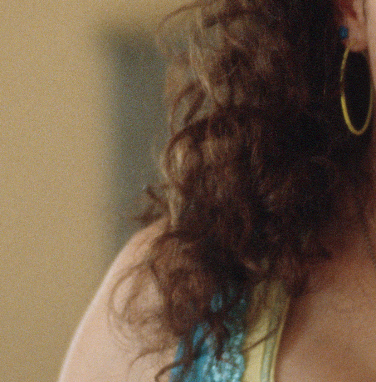

Scan sample of Provia 400

Thanks for this info - very much appreciated. Tim, i noted your offer to send through a scan sample. If you can, that would be great but if not, no probs.

Ok, here is a crop of an unsharpened 4000dpi scan (on a Nikon Coolscan V) - would make a 19" x 13" print at 300 dpi. This is delving a bit too much into digital stuff, but the scanned sharpened up nicely too. You might have to open it up in its own window to see the full size.
The full image at lower resolution is here.

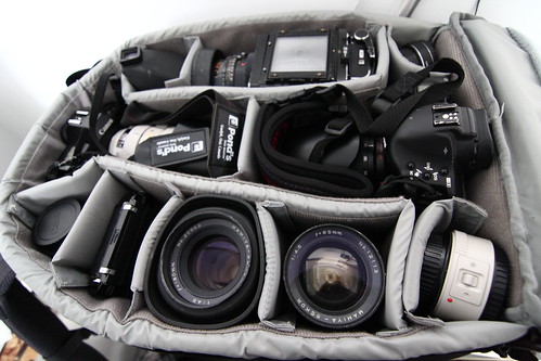

My bag fully loaded:
Full bag with EOS 1N RS by Harry Pulley, on Flickr
Oops, there's a digital camera in there too, sorry... I didn't use it that day though, I promise :smile:
Another Guelphite! And one with a bag that looks a lot like mine - I'm just missing the red rings.
More on topic - I shoot an EOS 3 with PB-E2 permanently attached. I like the vertical grip, and if weight is a problem I'll grab a smaller EOS body or my Minolta XD11. I would have liked the 1V, but couldn't justify the money - the cameras are almost identical functionally.
