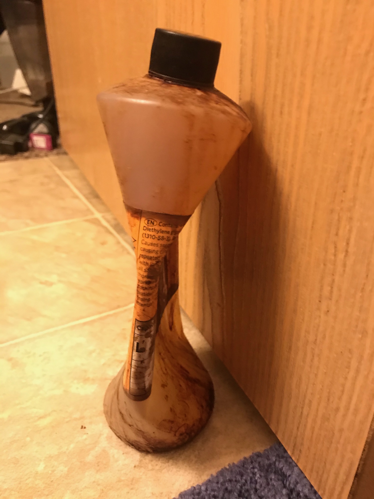

Ultimate dumb question time-
If I want to develop a film in dilution H, but there's no time given, I just double the dilution b time...?
Yes, dilution H (unofficial) is 1:62. Also, do use a minimum of 6ml of syrup per roll as Kodak recommends.

so I just ran my film in dilution h using double the dilution b time, and it worked. I did it to try and emulate d761:1. if anyone's wondering, I used eastman double x film, and it's the first roll of the stuff I've tried.
TheGreatGasMaskMan
Jul 2, 2017
804
Michigan, United States
second, I really need some suggestions on alternate containers to store the developer
otherwise, the chemistry itself is still working very well.
