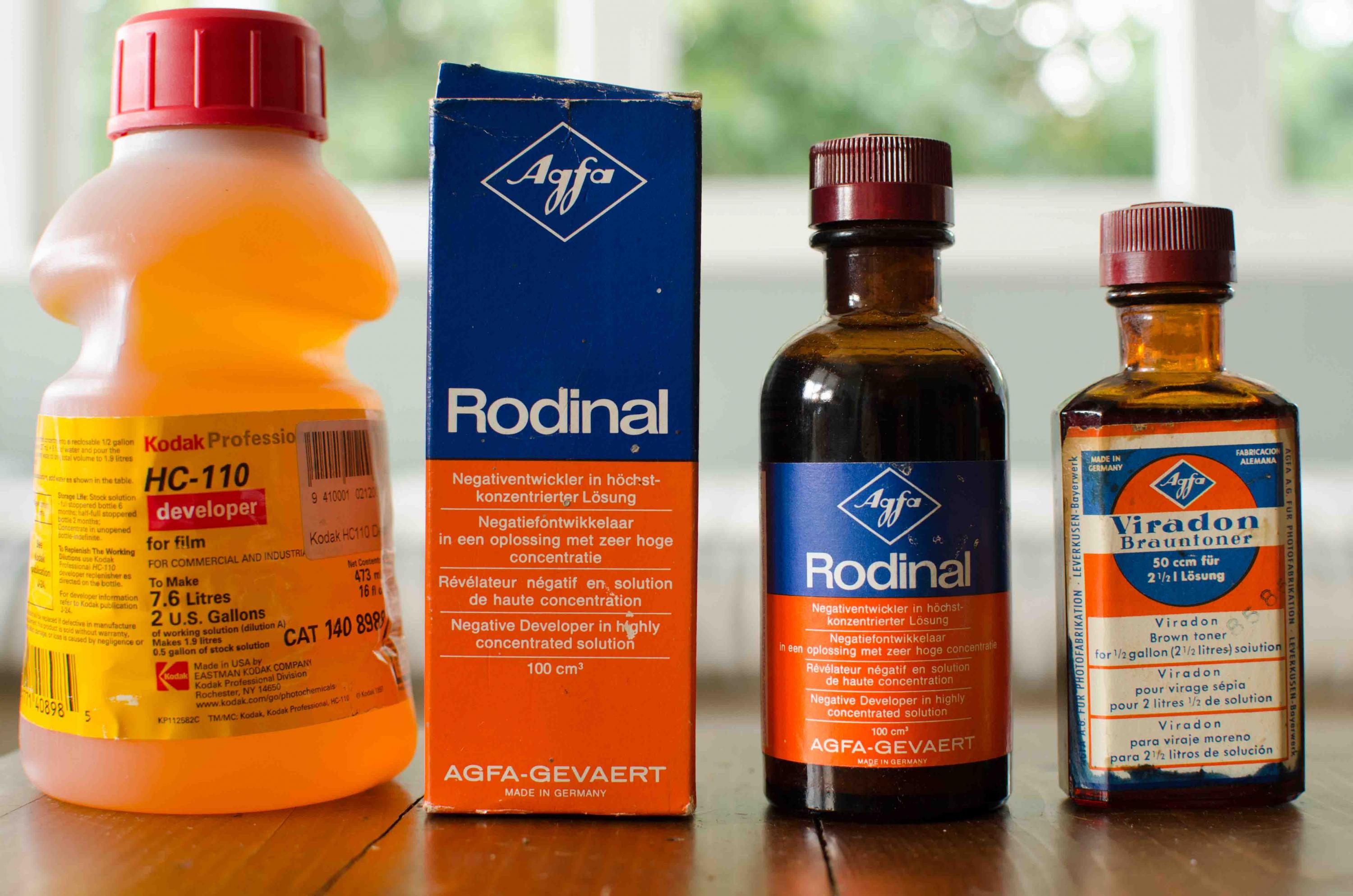

Hi everyone,
I had previously posted my experience with an ancient bottle of rodinal but now Ive had a chance to develop some 35 mm film (tri x) using some old but not quite as old, HC-110 developer that I bought as part of a darkroom kit sale. The bottle was opened by the previous owner (I don't know when) and about a 1/5 of the concentrate was used , so there was a definite air cap left in the original bottle. The expiration date on the bottle states 2005/2006. I used dilution 'B' @ 20 degrees for six minutes and printed the negative on 5x7 sheet of kentmere FB VC fineprint , followed by a 5 min selenium 1:9 toning. To my (inexperienced) eye, the HC-110 still delivers!
I toned a separate kentmere print with a 1:50 dilution @10 minutes of the old but unopened viradon that I have and going by the stench of the concentrate and the final image, Id say that its still in good shape. This print did get a double dipping in selenium as I had previously toned it in 1:9 selenium solution before I tried it in the viradon, which already contains selenium. As an aside ,my experience with this paper is that it really needs selenium as it seems to have a slightly greeninsh tinge untoned (developed in LPD 1:3).

My 6 month old bottle of HC-110 looks worse than your ancient one. My bottle shows a deeper red color to it.

I have '97 vintage HC110 that still works. It's about the colour of the one in the pic above, but in the tall square bottle.

Your Viradon probably contains selenium and sodium sulfide. Viradon New omitted selenium from the formula.
I've had an open bottle of HC-110 for years and it went very dark and it worked well. It was pretty close to a freshly opened bottle. The stuff is bullet proof. I think the reason is it's mostly glycerin not water which is resistant to oxidation. The stuff keeps forever.

It is not glycerin, it is a glycol.
