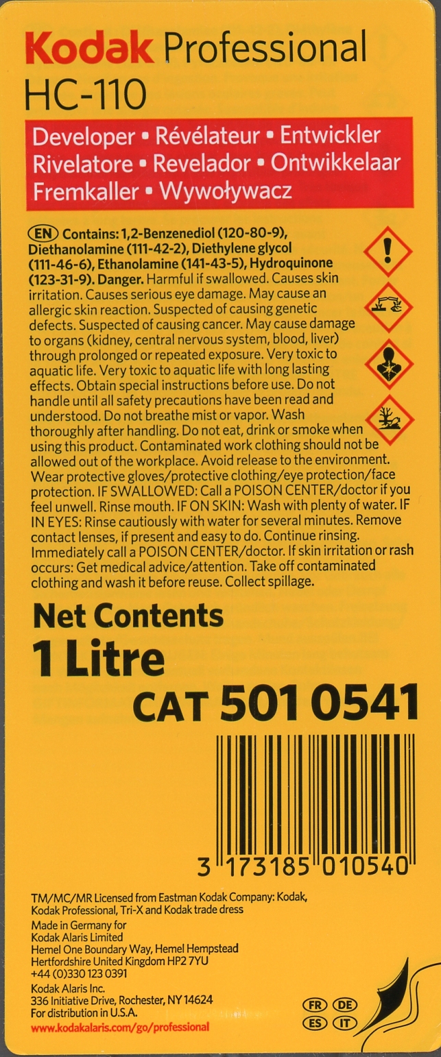

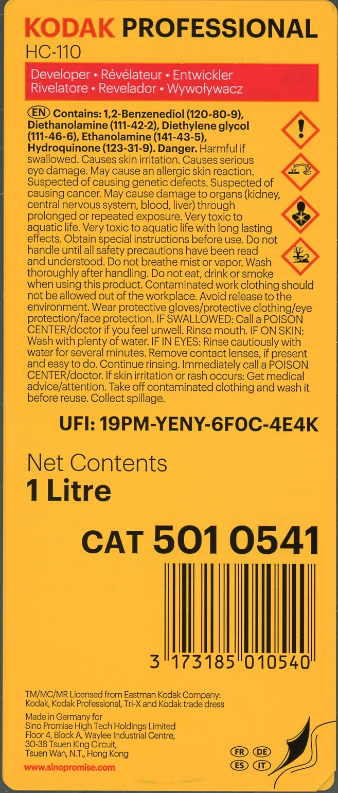

I dried up a bottle of hc-110 syrup by Kodak Alaris, bought in 2020.
The new one I got today is by Sinopromise, and the major change on sticker is company name. It still satates "made in Germany for ...". Even barcode stays the same.
