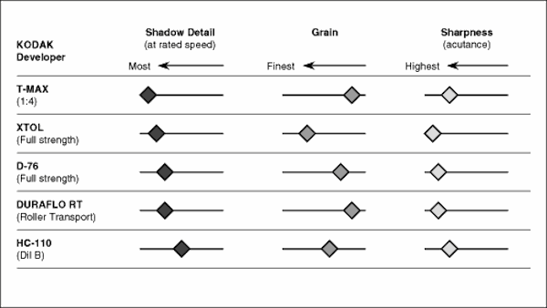

The graph below suggests that HC-110 produces a middle-of-the-road negative alongside the other Kodak developers. Its main virtues seem to be that it's easy to mix and lasts forever (the chart further below). If it were as volatile as, say, XTOL, would it be around at all?
Also, I hear things like it's not suited for smaller formats like 35mm. I tend to believe it. For 4x5 and larger, the grain and sharpness "problems" becomes more negligible, and you can get the desired amount of shadow detail by controlled metering and developing.
Am I missing something?

""The graph below suggests that HC-110 produces a middle-of-the-road negative alongside the other Kodak developers." I really don't know how you arrived at the interpretation you did. Look again the figures do not suggest anything as middle of the road.
According to the 2001 Kodak Professional Photographic Catalog which contains a comparison chart.
Compared to D-76, this chart indicates that HC-110 (dilution B) produces:
  • Slightly less shadow detail or true film speed;
  • Slightly finer grain;
  • Slightly lower acutance.
Notice the use of the word slightly in each of the statements. In all respects it compares very favorably with D-76. It certainly works very well with 35mm films.
Purely by quantifying the graph. All the other developers are weighted to the most/finest/highest side in two or more categories; HC-110 in just one category, sharpness. And in that one category, all the other developers perform as well or better. The proof is in the pudding, of course, and I don't read this graph as gospel. I'm just explaining how I arrived at my interpretation.

HC-110 dil. B seems to result in finer grain than 3 of the 5 developers listed in the chart..what is wrong with that?!
The illustration is really not very helpful and a bit confusing. It is not intended as being quantified and quite frankly I don't know how you would do that. If it were then the slide bars would have metrics associated with them. In the post I quoted the keyword is "slightly" and I think it best to stay with Kodak's verbal description. I don't wish to offend but I am trying to prevent an baseless rumor from starting on the net.
