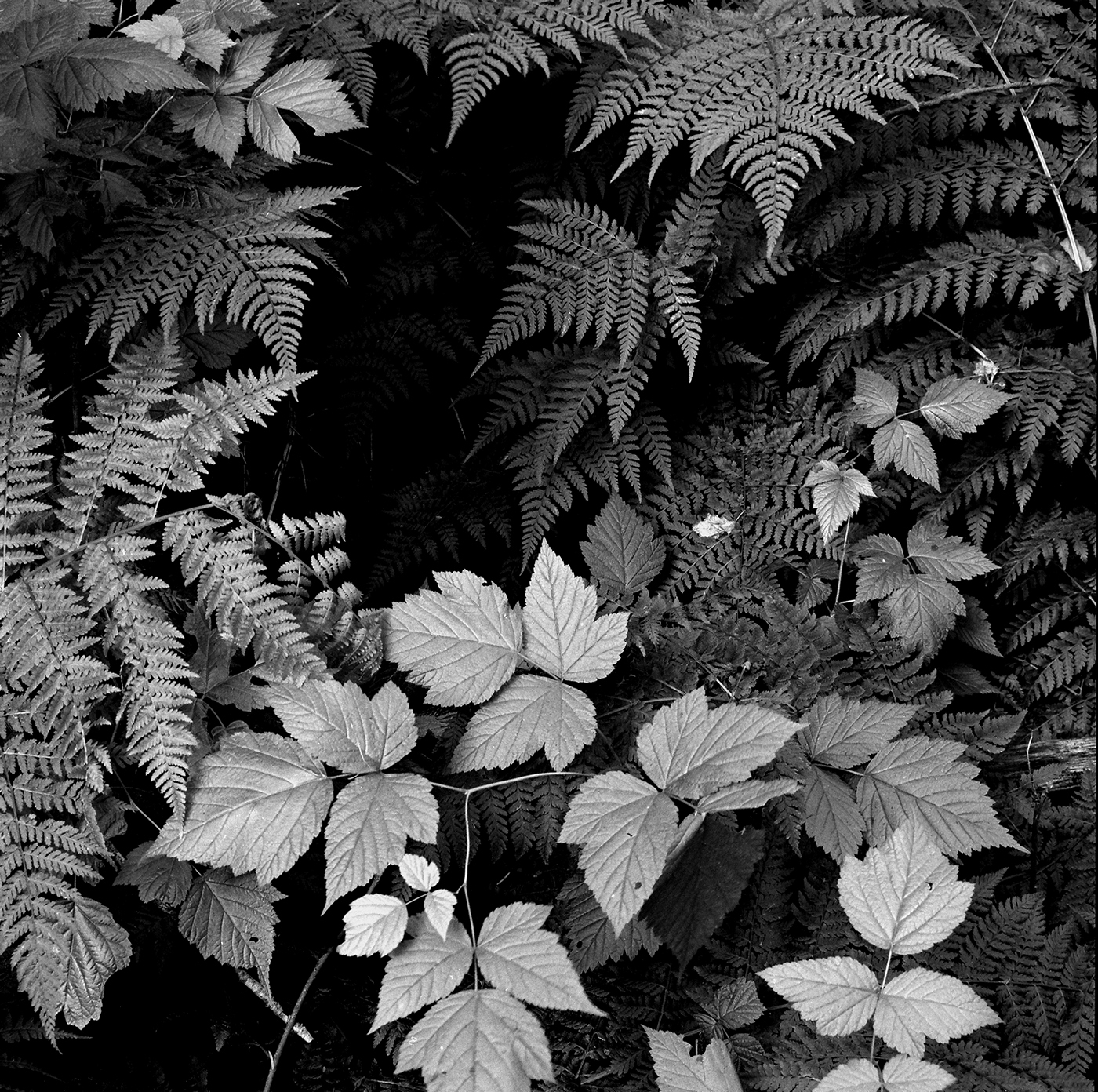

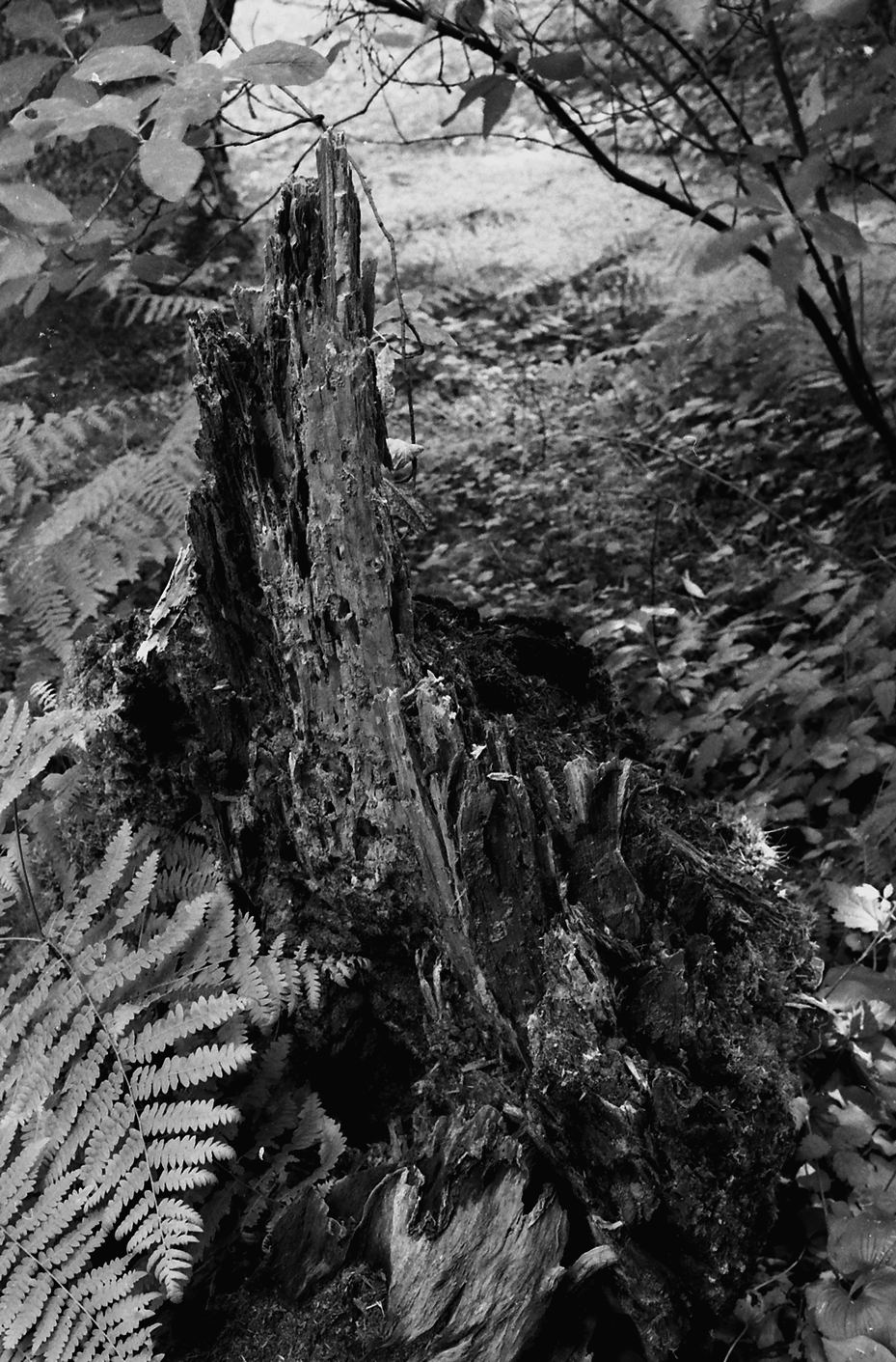

Here is one from a 6x7 negative.
This one is from a 6x6 negative.
And this one is from a 35mm negative.
The 35mm one suffers a bit from the download process.

Oh Matt, lovely.. never tried Tmy-2 that's 400 Tmax correct.. going to have to order some.
Thanks.
And in response to your question, yes, although the current version (TMY-2) has a slightly different name than the first version (TMY) - it is now known as "KODAK PROFESSIONAL T-MAX 400 Film".

Yeah, you suck at it. Those are beautiful.
I cherry picked my choices.
If you would like me to upload some of the failures ......
I would note though that some of my earlier struggles might have been related less to my scanning challenges and more to my struggles with the old APUG uploader. The uploader in this new software seems to be behaving better for me.
